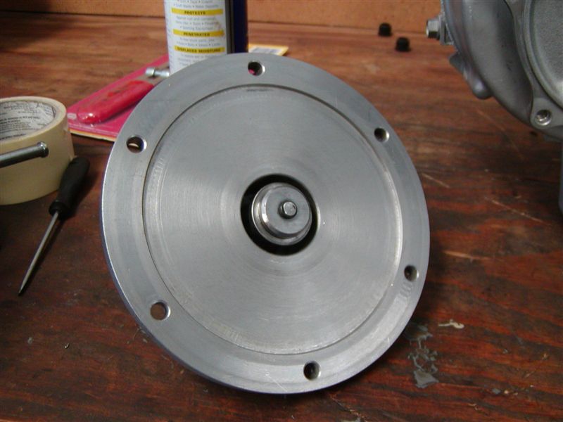

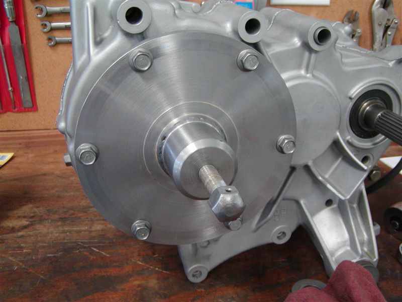

I spent some time this weekend making a new Tool. Pulling of the Rotor hub is a piece of cake now.

I posted the tool to share the Idea. I would not be able to make them and make a profit and the tool being affordable. I drew the Flange on the PC and my buddy cut the flange on the water jet. So this part was not time consuming but I cannot keep on asking for favors. Then I spent several hours on the lathe to fine tune the flange after I welded the pipe and top on it. Then I made the bolt and the center piece that pushes against the axle. I will promise that if I ever be done with the Pilot I will give you guys first dips on the tool.
