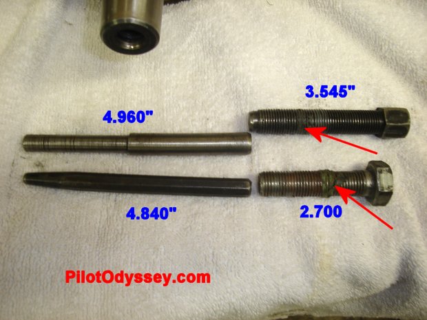

PostPosted: Mon Oct 02, 2006 4:01 pm
Here are the pullers, arrows point to left over thread tape from last use, I just give them a quick wipe when I get done using them letting the grease protect the threads between use, before use the threads are cleaned the tape removed then grease applied to the threads so they cant gall and no dirt is between the threads.
Numbers you see are end to end measurments ...
The top right bolt you see is whats left of the POS SOFT over priced junk puller I bought from HRD racing that bent under the slightest pressure.
The bottom left is a shortned punch, it wont don't and hasent bent!
You want the OD to be close to the ID of the hole it is going through so it CANT c ock in the hole you want it to push straight.

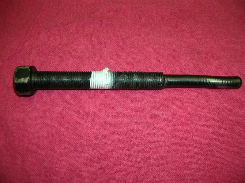

I filled the hole with grease, added the teflon tape to the bolt and hit it with the impact gun once and the clutch popped right off. The bolt never even bottomed out against the clutch. Hoser, Thanks for the tip it worked perfectly!!!
Here is a picture of the puller, the end is now "S" shaped. It was straight before I started. You can see it bowed so much under pressure it was actually hitting the threads inside the crank as I tightened it up.

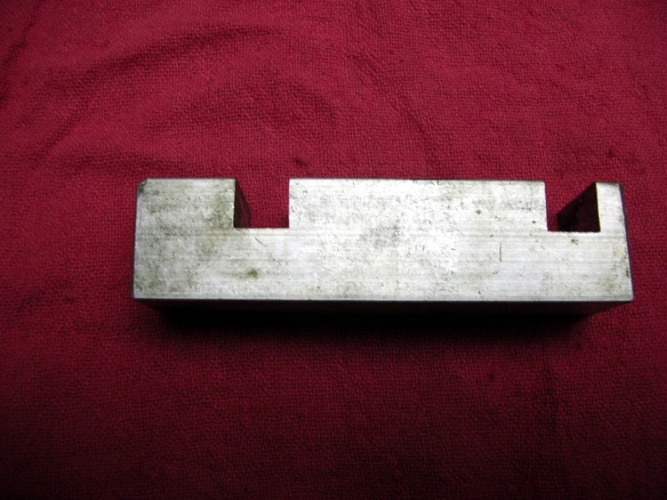

The second picture is the fancy clutch holder I got from HRD, simple effective design....but I think it was like $30.00...live and learn I guess

You want me to send you one of my holding tools, the one you have requires two people to use I still cant believe they sold them things I would like to meet the moron that designed it I bet he is a piece of work lmao

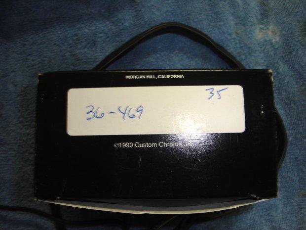

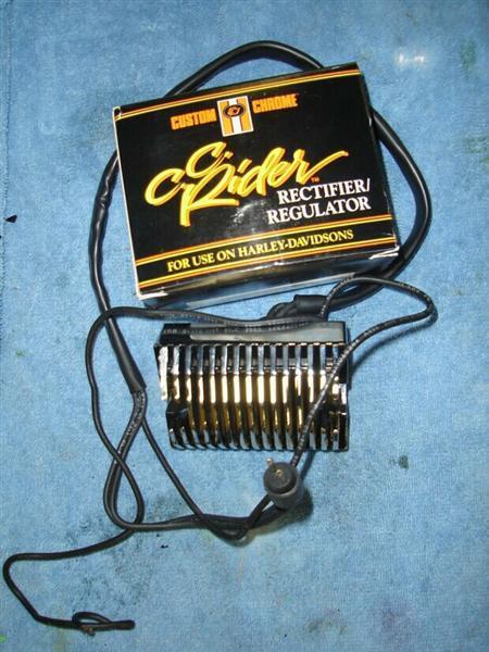

Here is the regulator you sent.
PostPosted: Tue Oct 03, 2006 10:01 pm
Posts: 407
Location: Orlando
I havent cheecked the threads yet, but will before the I start the reassemble. If they are hurt I will be very suprised, that bolt is sooo soft.
That regulator is for Harley Sportster, (84 to 93 depending on the wire lenghts). Hook ups are: Case = Battery Neg , Single lead = Battery positive, leads with the connector are your two AC (stator) connections. It's good for about 32 amp. It is a typical regulator / rectifier for any 2 phase permanent magnet type charging system.
Yeah the clutch holder is a joke, but it does work. What I would really like to see is your design for a holder to stop the clutch from turning if you are tying to install or remove without air tools.
