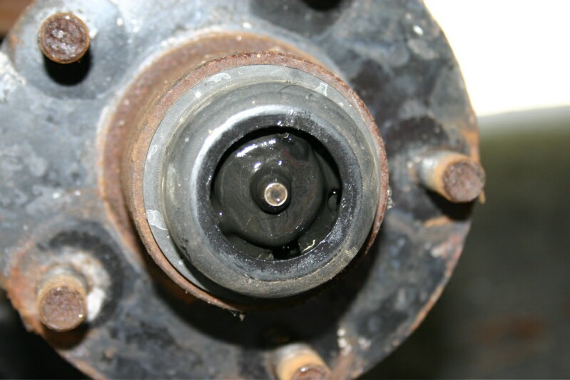

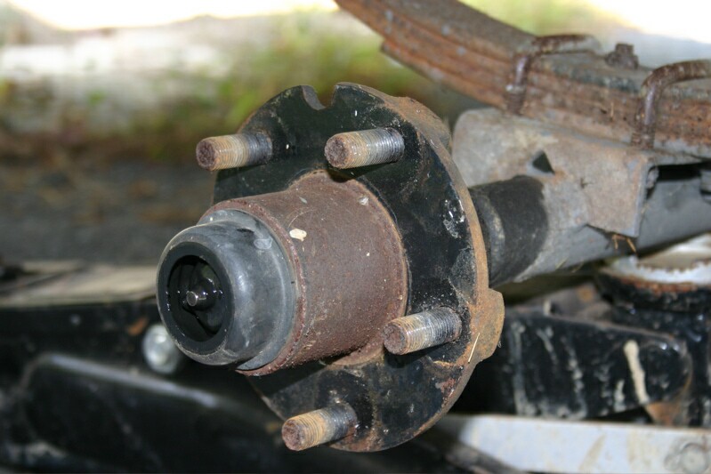

Is this cap a press fit?
File comment: Right side hub

PostPosted: Sat Oct 07, 2006 12:22 pm
Yeah its a pressed fit between the rusted area and the non rusted area or cap, you usually can cave man the cap off by tapping (gently) a stiff, strong scraper between the cap and hub (rusted part) work it all around until you can get a screwdrive between them, work it around keep increasing the size of the screwdriver blade it will pop off, don't get in a big hurry or you will break your screwdriver :shock:

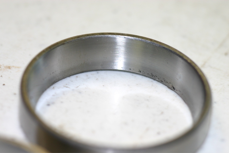

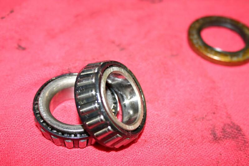

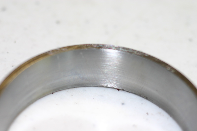

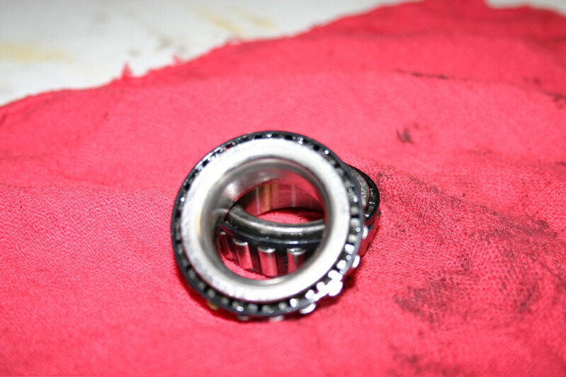

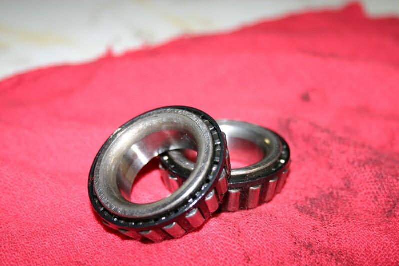

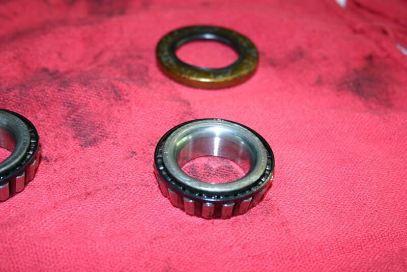

I used a dull chisel and the cap popped right off.
The bearings look good. feel a bit sloppy. But its hard to tell with them out of the case.
To get closer and clearer I'll need my macro lens. for now this is the look.
I'm just going to replace them. Keep these as spares.

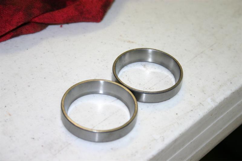

PostPosted: Sat Oct 07, 2006 2:23 pm
What does the other 1/2 look like, the bearing races..
PostPosted: Sat Oct 07, 2006 2:31 pm
Posts: 465
Location: Springfield Ohio
It looks like the bearing rollers have some scores on them. Definitely on the decline side of OK. They are good to get you home in a pinch but if loaded they will not last. Problem with trailer bearings is that you don’t ride in the trailer, can’t hear how bad they sound to know to change them.
The real trick is putting it all back together so that there is no play but the bearing is not too tight. Just ask for advice on that one, five people will give you six ‘right’ ways to do it.

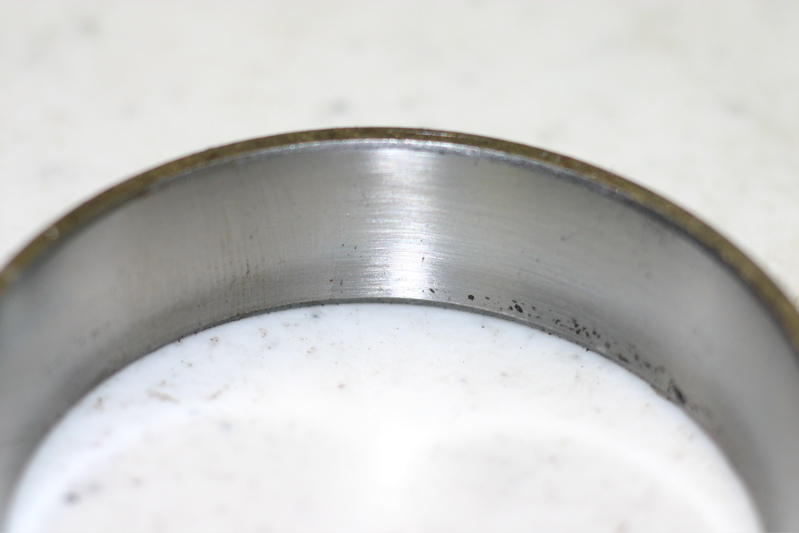

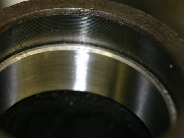

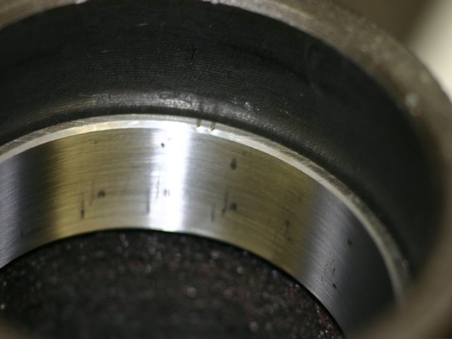

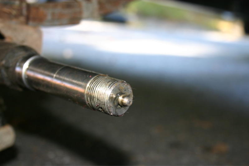

Wellt he second side was easier to do now Iknow what to do that is.

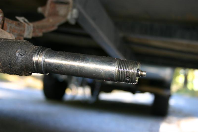

File comment: Shaft on trailer has greese wholes and a fitting.
File comment: the fitting

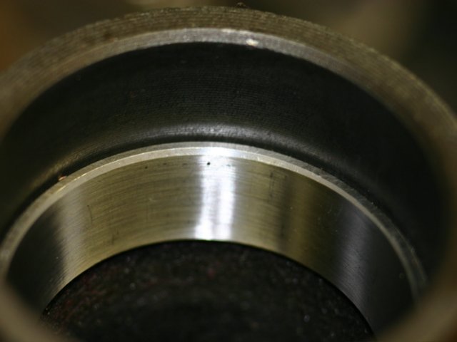

File comment: old races

PostPosted: Sun Oct 08, 2006 4:48 pm
Online
Posts: 806
Location: Bolton Ma
More pics.
After doing these the whels are nice and firm.
Over 70 I hear a little bit of noise. Probably my Universals.
So glad I did these over before this weekend to come.
Thanks for the help guys!
