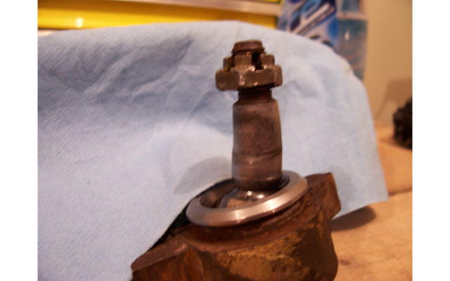

i took the arm off tonight, I couldnt get the nut of the ball joint because it just kept spinning. I tried getting a wrench in there to hold it with no luck. kept spinning. I ended up cutting the nut off. its all i could think off. They joint is warn real badly. Are they supposed to be cone shaped as they go up toward the threads. Mine is shaped like a bannana. I took a few pics but don't know how to post them. Question is, which is harder the joint or the spindle? They joint is obviously worn and the spindle doesnt look oblong or anything so im thinking i just need a new joint/arm and not the spindle too. I don't know, waht do you think?

PostPosted: Sun Dec 17, 2006 8:01 pm
Joined: Thu Nov 30, 2006 10:34 pm
Posts: 55
pics
PostPosted: Sun Dec 17, 2006 8:31 pm
Posts: 805
Location: Bolton Ma
Holy Ball Joint!
PostPosted: Sun Dec 17, 2006 9:44 pm
that's not good!
Now would be the time to engineer something as a replacement if you can..
PostPosted: Mon Dec 18, 2006 6:04 am
MassOdy wrote:
Holy Ball Joint!
Holy Ball Joint Batman... That looks like a banana!!!
You have a few option... Try to find a used j-arm and take your chances on the joint being in "good" shape. weld the bolt back on, My bad, I am wondering if I used a vise grip plier to hold the shaft? Or try ATV Racing...

When you install the ball joints if the shaft turns all you gotta do is put pressure on the ball joint trying to push it in, you can wrap a ratchet strap around both upper and lower arms and tighten it up, C clamp etc..
