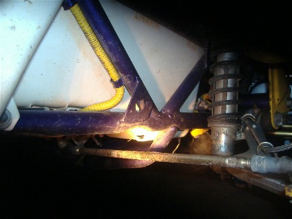

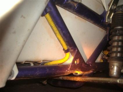

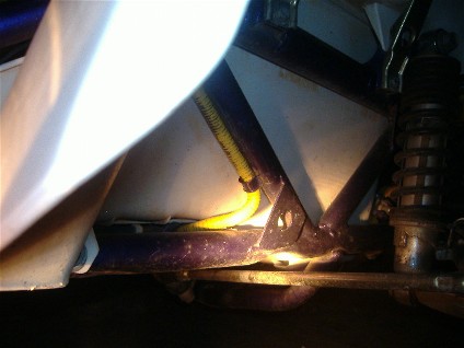

PostPosted: Sat Sep 09, 2006 11:11 pm

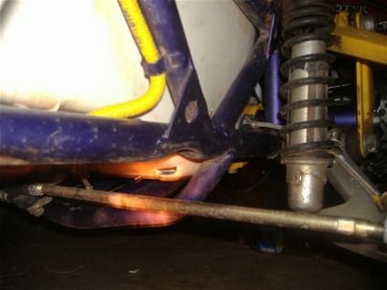

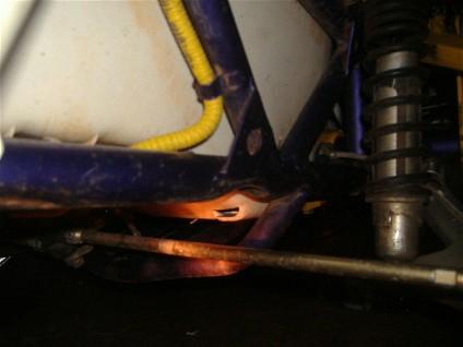

Ok fumbled around in the dark and got these...
File comment: 215 pounds (me) standing on the freont bumper and pushing off the ceiling of my little shed...
File comment: Same spot with nothing on the buggy...
File comment: shot of the buggy sitting as was...
File comment: shot of underside from floor
PostPosted: Sat Sep 09, 2006 11:16 pm
...double posted Sorry...
PostPosted: Sat Sep 09, 2006 11:17 pm
I thought about doing the same thing to mine eventually. You can see a slight bend in my left side tierod in the last picture...
I wasn't real sure bout giving away $100.00 for something I could upgrade myself... And I read you had to drill out your knuckle to a bigger size, thus weakening your knuckle...
PostPosted: Sat Sep 09, 2006 11:23 pm
Thanks for the pics, try this turn the steering all the way to the right and check the clearance with the suspension compressed then check it with the steering turned to the right, look on both sides just to make sure.

PostPosted: Sat Sep 09, 2006 11:46 pm
Posts: 251
That is terribly close, i can see a fix to the problem already tho, would like to see a pic of the tie rod end were it mounts to spindle, very first thought would be to turn the tierod upside down and install the nut on top, that would gain an inch probally, but it most likely is tapered, so next thing is to drill clean str8 hole, and replace with heim joint on the bottom side of steer arm with high mis spacer, if its not a problem, then no need, but even at bottom, flex does occur, and it looks like not to much would be possible...i don't believe it will effect bump steer, it may even make it better, would be curious to see what stock bumpsteer is, as the inner pivots are very far from a arm mounts, biggest key in minimal bumpsteer, is to have pivoting points in line... so i am sure there is some bump there, maybe or probbaly less than 1/4 wich imo is perfectly acceptable on dirt...
PostPosted: Sat Sep 09, 2006 11:48 pm
Posts: 251
my bad, there isnt a arms on there, doh... i am sure bump will not be a problem....

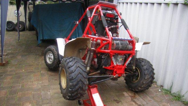

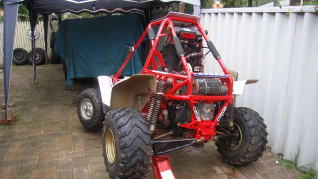

PostPosted: Sun Sep 10, 2006 12:04 am
Out of curiousity I took some pics of mine. Jacked up opposing corner and had kid push down all the way to load up and had plenty of clearance on both sides with wheels turned both ways. Hope this helps. Baz

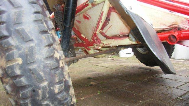

PostPosted: Sun Sep 10, 2006 12:22 am

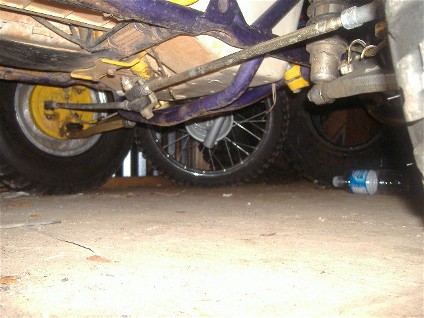

Ok more picture... The first set above is at full left turn... As I had the camera under fender needed to be this way for the pix...
The first two are at straight compressed then up. 3rd pix is at right turn, uncompressed, last picture fender hit the camera and lost aim...:(
Thanks for the pics guys.
So do you think their is a clearance problem with me adding a 5/8" OD tube over the tie rods?
I think the frame is notched at the factory for clearance for the tie rods (see red arrows) ?
Does the tube (blue arrows) have any scars on the front side where you have hit something in the past?
