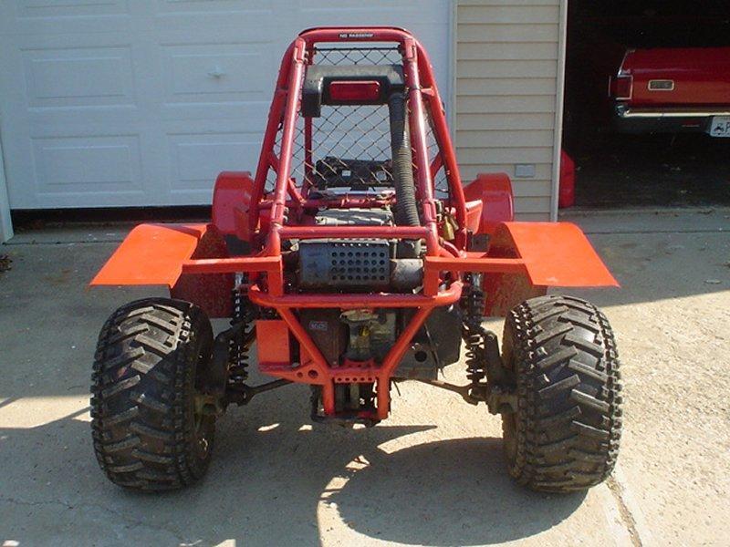

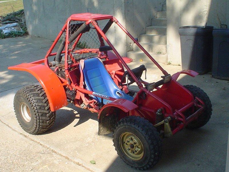

here are some pictures. the previous owner wanted an easy fix for the fenders so he made some metal fenders. this was a cheap and easy fix costing only 50$. i do plan to get some original plastics in the future though.
PostPosted: Fri Aug 17, 2007 10:52 am
Joined: Thu Aug 16, 2007 8:39 pm
Posts: 88
Location: Northern Kentucky
Front

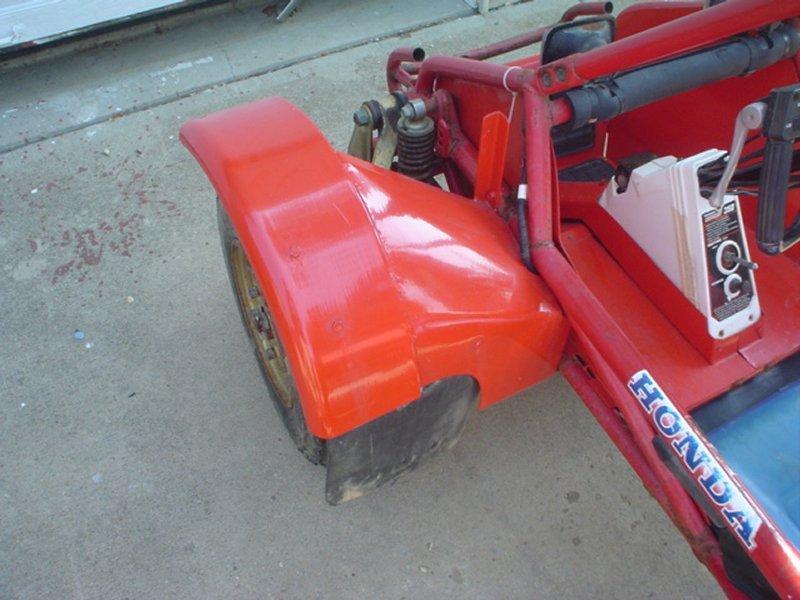

PostPosted: Fri Aug 17, 2007 10:53 am
Posts: 88
Front fender

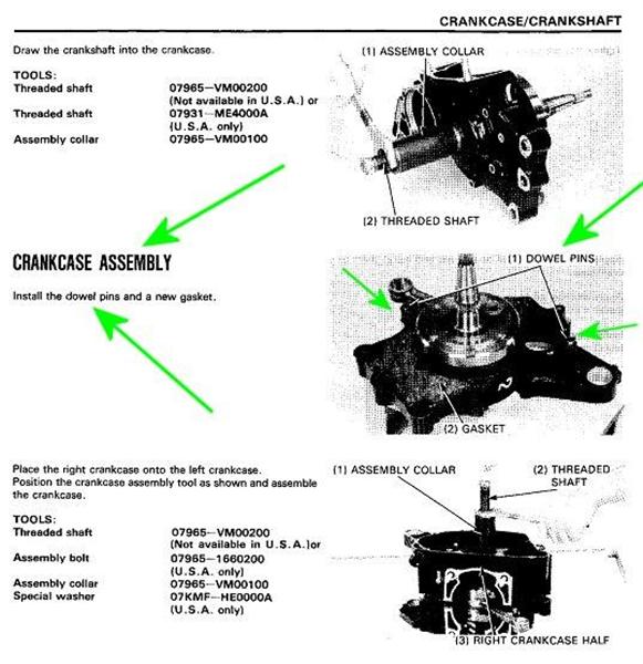

PostPosted: Sat Aug 18, 2007 7:42 pm
Oh yeah the manual shows the TWO dowels clear as can be I guess Ludedude is just a moron.
The one closer to the top of the page was missing that's why the front of the cylinder was leaking when the cases shifted that's why I found the cylinder so over tighten it wrinkled up the gasket as it tried to squeeze it out, when he seen the leak he should have turned the cylinder nuts the other direction and taken the whole mess apart.
PostPosted: Sat Aug 18, 2007 7:59 pm
As you read on in the manual ....
