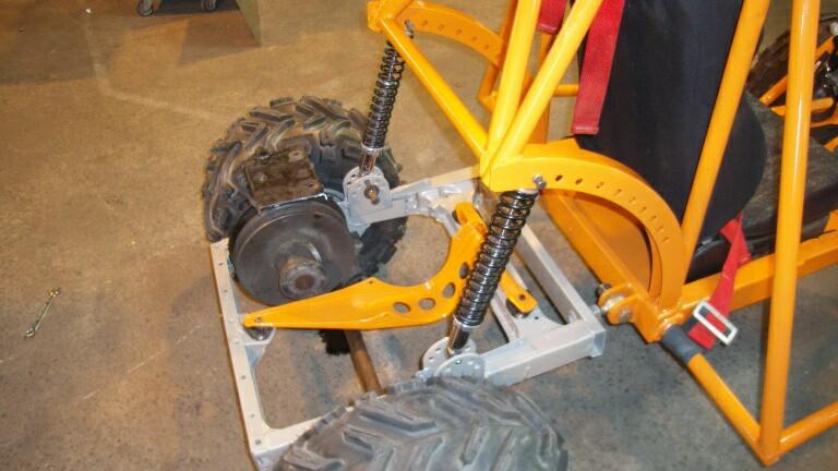

PostPosted: Wed May 30, 2007 2:24 am
Here's one that my mate Leon has done...Baz
I will try and find the link to this project.

bugeye, that's perfect that was what i had in mind, any idea the suspension travel?
i notice that was back in 06, is he opperating it currently? anything he would do different?
PostPosted: Wed May 30, 2007 3:15 am
No , nothing as yet. The Ody is just about ready for some trials.His mate Steve has rebuilt the motor (( Internal Combustion Engine ? )),ported,carbed, piped etc I'll be going to see him soon and ask him some details plus some more pics if you want.
Give me a list of your questions and I'll ask him...Baz
He reckon's he's gonna kick my Pilot arse with his $2 fiddy! :shock: I will be getting him to race with me at the Northam OR Speedway.

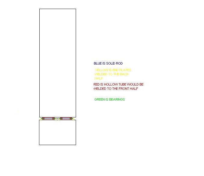

yes more pictures close up, i want to know about the heim joints, im thinking more like a piano hinge style rear, i.e. 6" long round tube with some 6202(or what i determine to work the best) bearings and a solid bar going through the middle of them.
also i was thinking of something along those lines but using typical chevy leaf spring eye bushings but i think the bearings would last forever and a day(not that the bushings wouldn't, could always install a grease fitting in the rod)

can you ask your buddy where he got the arched shaped upper shock mounts? is it a kit that can be bought or is it something he fabbed?
PostPosted: Thu May 31, 2007 10:54 pm
He fabbed it himself. He has an Air Conditioning-Heating and Eng Business.
