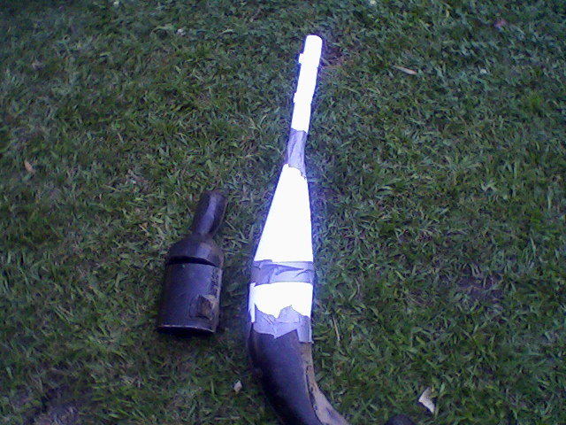

i STILL havent got any metal yet :shock: . but i have made templates and a carboard mock-up. im thinking i will make the end part either point up, or go to the left like wat ive seen on the pilots.
see wat you think of my design, its aimed at about 6500-7000 rpm to be the peak of the power band.
thanks, josh.
File comment: found a good place to balance it hehe :D
File comment: old half of the exhaust...
