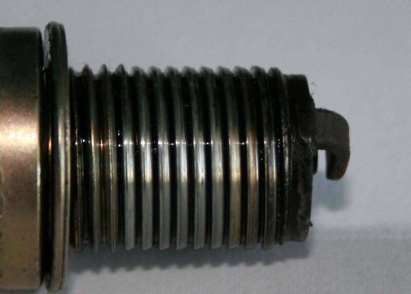

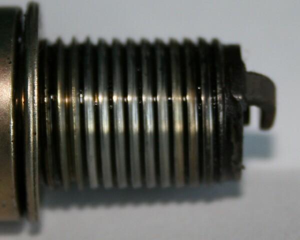

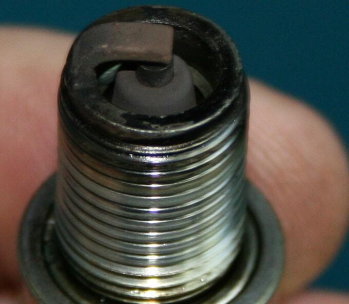

Wow, I have the first disappointment with this 350. I took out the plug to inspect it, and it was VERY tight all the way out. I kept my hopes high, but my worst was affirmed. The head has been cross threaded.
But here are pics of the plug, and tell me what you think of the threads on it. I suspect you are going to all say, pull the head, run a tap through to clean it up, and don't worry too much about it, but pulling the head is a big deal for me right now, kinda digging myself a hole since I bought a 250, spent $500 on it to get it fixed up, still doesn't idle so not selling it until it does, and then I bought this 350... :(
This plug is from running about 15 minutes, and the last thing I did was about a 400 ft run WOT (Wide Open Throttle) killing the Engine and coasting in.
Thoughts?

Threads on the plug don't look good!
Worse comes to worse remove the head and repair the threads, I suggest using a insert over using a helicoil because of the heat.
You might get lucky and just use a tap to clean it up but like any other damaged threads you have to take each one on a case by case basis.

That is totally my fault. I have a brand new BR9ES spark plug I was going to use to replace when I did the rebuild and I didn't, I never took that one out. Reason being, when I bought the ody the guy that sold it to me told me he just replaced it that day. When I took the Engine apart because of the melt down, sure enough looked brand new so I never changed it. I hadn't run it long enough to get it broken in to do the plug chops (in my opinion).
I will find a head and have it sent to you or I will pay to have that one fixed, you let me know what you want to do.

You could have pulled the jug with the head on it and then done repair and just replace the cheap base gasket. The plug you tested looked a little fat on top but better fat then dead. The 9 is a cloder heat range and may not claen out at WOT (Wide Open Throttle) at your present jetting setting wich will need to be jetted down acually running leaner. Read up on heat ranges and like "H" said check your manual, if stock head and non ported for proper heat range then test. Good thing to do since yor already fat is to reapir head then do another plug chop( remember not to pull and install while head is hot let set for a little while before removing an reinstalling as not to damage the new fix) with the 8 than the 9 and compare the soot and the soot strenght on the electrode. If you can take pics and keep for reference or just put in plug holders for future reference. Mean while ask "H" were to find reading and pics on plugs. I for one like a tan color with a clean burn on the tip. Mine had been modified so it likes a 7 which is hot and is not recomended for an air cooled and some water cooled motors . Good luck
