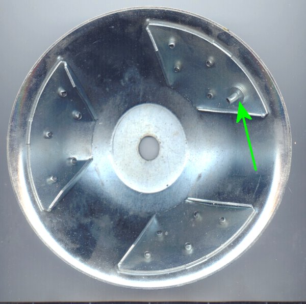

Hare, I havent check them all but here here is one PB cover with a balance
washer on the cover, I know I have seen this on another one of my PB
clutches, I will have to inspect the newer clutches I got from Ludedude
to verify they have some sort of balance mod to them, whether it be
added weight or removed weight by machining or drilling, I ASSume
they do balance them, PB has been making OEM clutches since the
early 70's (perhaps longer?) then again the new clutches I have were
made by IBC, IBC bought out PB...

How do you balance a clutch or to check to see if it is balanced? or to compare to stock
would be nice to try to eliminate factors
judging by feel the PB weighs considerable less than the stock clutch wonder what the actual difference is, looks like the weight is closer in on the PB as well.
PostPosted: Tue Feb 01, 2005 12:32 pm
I have no idea how to check the balance on a clutch, I don't know what the weight
difference is I know the PB 'feels' less than the Honda, since I was changing it out
to something adjustable weight was not a big deal, I was told by a few of the old
250 and 350 race guys the PB weighs less than the Comet 102 and the Engine would
rev out faster with the PB, again I never really cared it just came up in conversation
