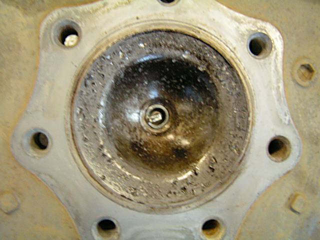

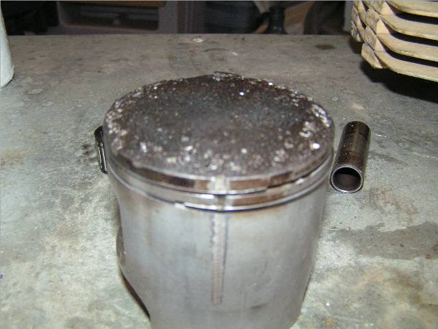

Well, I lost compression, and just started tearing into it last night. Just to recap from previous threads- I just bought this ody a couple months ago. The stock fuel tank was pretty crusty, so I swapped on a gravity tank and it ran for a bit, then nothing. I later discovered that the main carb jet was a #138, so it was probably a bit lean. I had spark, had fuel, checked the compression and had nothing.
I'll try to attach the pics here-

head-

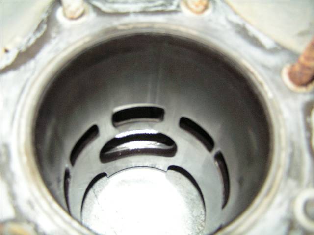

cylinder-

another piston pic-

It's still on it's original bore.
So, help me out here guys. Did it get too hot running lean?

need more, better pictures
but i would hazard a guess and say the exhaust port caught the ring and the rest happened from there
PostPosted: Sat Feb 02, 2008 10:52 am
that head looks from the pictures to be a gonner-did you find all the parts that caused that damage by chance?You may-IMO-want to split that bottom end and make sure you don't have any pieces in there ---

There is a little damage to the exhaust port like the ring could have snagged on it. Sections of the top ring are gone, along with piston pieces above and below where the top ring was. The top of the piston and the head are nicked up pretty bad and have small chunks embedded. I couldn't find any pieces anywhere. I think they were chewed up and spit out. -?
Should I send off the cylinder to somebody to bore and taper the exhaust port, or should any local machine shop be able to handle that?
Could the nicks in the head be smoothed out? Clean up the chamber and lower the deck height a little to get the C/R right? Odysseysalvage has used heads for $75, so maybe it's not worth trying to clean this one up. -Or maybe it's time to go watercooled?

if you have a local shop you trust just tell them what you want. I am a cheap bitch that wouldn't worry about the head, just smooth out the best you can and roll with it or take it with the jug and new piston (if you know what piston it needs) to a local builder and he should keep it under $100. for the work.
do make damn sure nothing is in the bottom end, a tiny piece hiding in an oil port or in a bearing will ruin a day, i usually use kero or diesel then finsh with a pre mix rinse.
