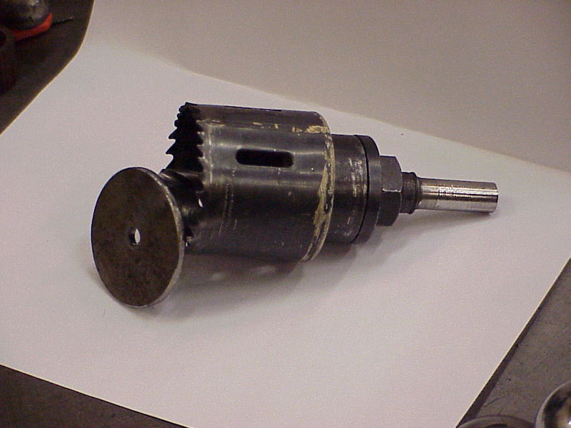

Lets See what we can do with the left over hole saw slugs
thanks For looking
Speeeeeeeeeeeeeeeed Chaser
File comment: hole saw and slug

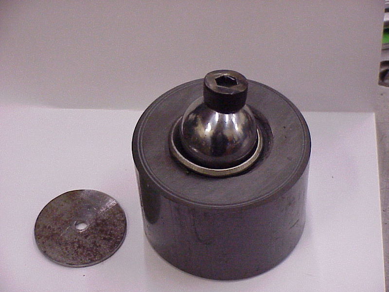

File comment: steel ball off a handle with 1/2" bolt in the end chunk of plastic

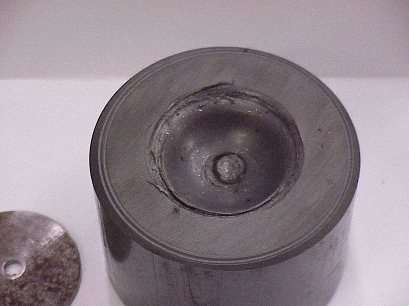

first press ball in plastic to make a indent then put slug in center of in dent and look what you get
File comment: in dent in the plastic after

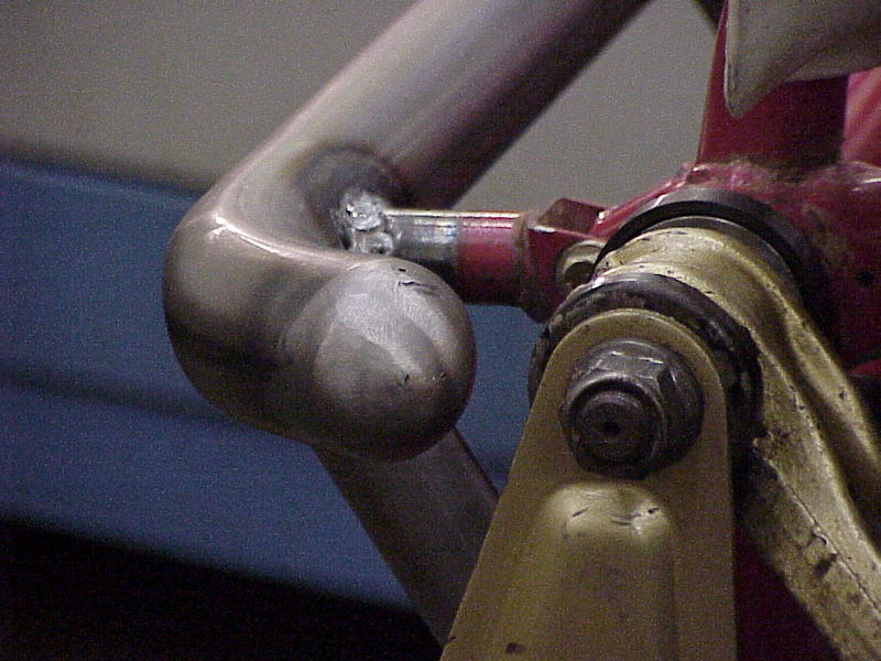

File comment: A weld on End Cap for tubing
File comment: close up need more sanding but looks good

Sweet, nice touch nice detail, I used a freeze plug and tack welded it on mine don't look near as good as your plugs, have a shot of the whole bumper?
PostPosted: Sat Nov 22, 2008 12:40 pm
I had ask about the end caps on other post disregard. I see now how to do. Thanks, nice.
