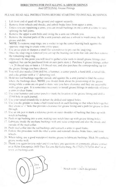

Has anyone installed the red urethane bushings in their rear upper a arms?
Are the bushings the same ones used in the frt a arms? :shock:

If I remember they are different front to rear-when years back ROCKETMAN sold them the kits were not the same.That may not be the same with other manufacturers-

just cut down a set for the fronts to fit the rear, one set does the rear twice

The rear kit is different you leave the factory heim in the arm unlike the front where you remove the heim.

The rear arms have stops in them so the one bushing stays whole and the other bushing gets cut shorter, about half the size i think. I will look for the directions.
I am pretty sure all the honda kits are the same. TRX, pilot, 300ex, ect

I,am kinda lost. Your leaving the old hiem in and cutting the new to replace old seal and spacer. Will this allow the arm to tweek and slid onto new bushing when pushed by the retainer under hard hit. The hole arm could role forward or most likly to rear throwing off alignment and binding ball joint in hub . I hope I,am all wet please straighten me out.

heres the directions
PostPosted: Sun Nov 16, 2008 11:54 am
You could have siad I was all wet but no. I get it. That's some nice info. Leaving the hiem will allow it to travle smoother. Thanks. I know "H" would have got the hose and let me have it, funner or funnier that way.

PostPosted: Tue Nov 25, 2008 7:14 pm
Posts: 1360
Location: Baltimore, Maryland
heres the front
