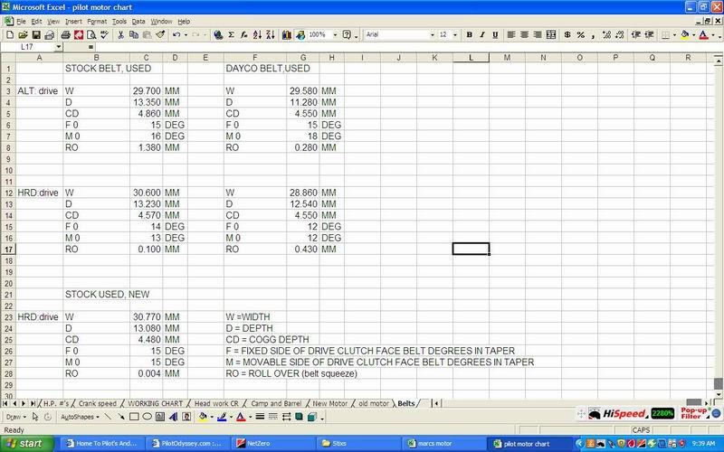

Heres a little belt info for you to look over. I found not did stock provide better run out it also reduced wear on drive and driven due to the belt rode cleaner due to taper reducing RO. One thing I do is order several( 4 to 5 belts) belts at once and measure them all up and then use the best out of the bunch on mine and yes the wife gets the rest. Shhhhhhh, don't tell her.
