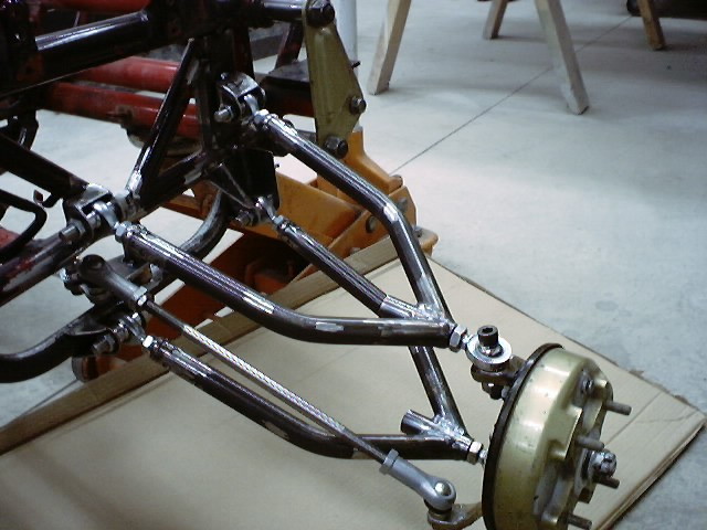

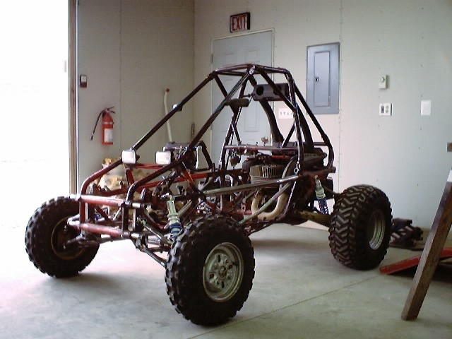

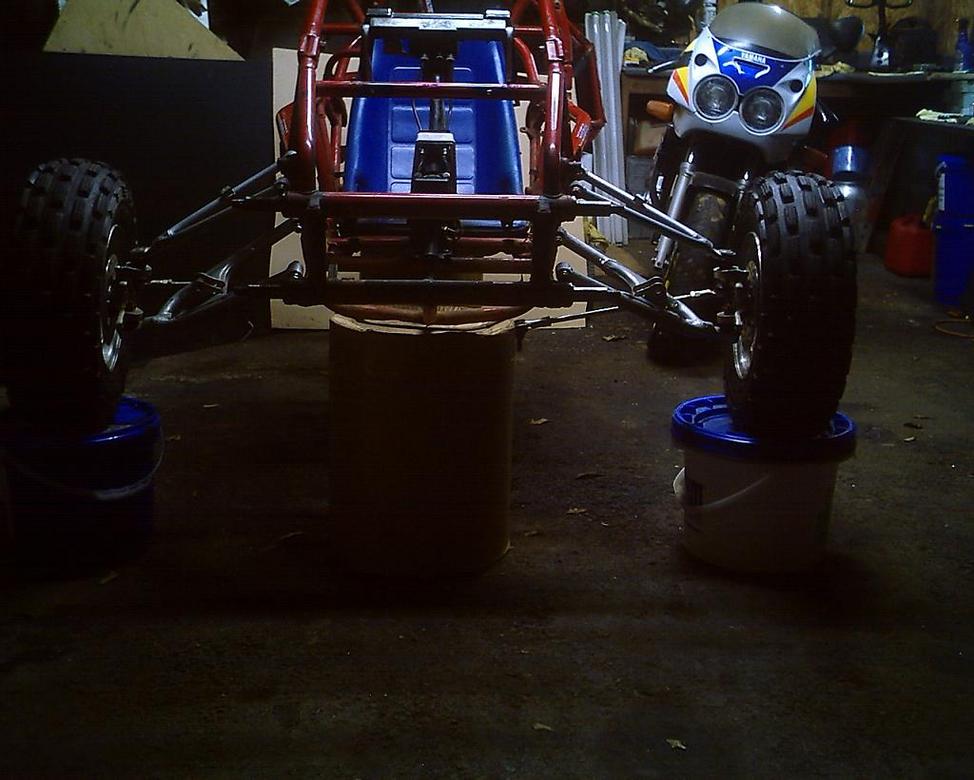

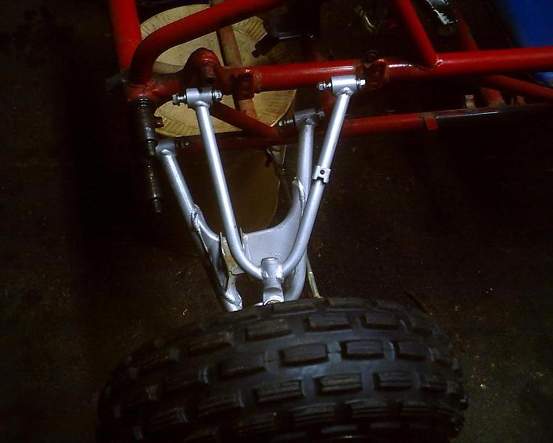

Here are a few pics. This isnt my work but I have done it a few times. I can help in any way possible.

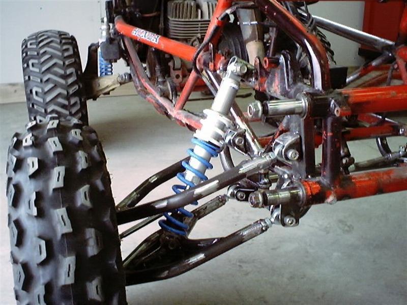

PostPosted: Thu Dec 04, 2008 3:00 am
The arms will be easy to atatch to the frame. The trickey part will be the steering setup. You will need a bumpsteer kit. There is no way around it. Because of 2 reasons first the tie rods will hit the frame on full compression and second you wont be able to dial out the bumpsteer. You will want to mount the lower a-arms lower then the lowest frame rail. This makes the steering later easy to develope. Your arm distance at the frame must be the same distance apart as the spindel (height wise) You also will want to mount the arms with about 7 degrees of kick up( a-arms slightly higher on te front mount then the rear mount) Doing this will take alot of time. Do one side at a time. Do one side complete except for the steering then copy all your parts and measurement and duplicate it to the other. Just in case you have to do it over. Also TACK weld everything before you fully weld it up. I have found yfz450 shocks work really well for this conversion. I'm also running a set of them on my LT pilot Heres a pic. Now as far as mounting the arms you can do tabs like the pics I posted but it will require welding some more tube braces or you can run some channel to connect the arm set together then weld that to the frame. Its less pretty but it works.
