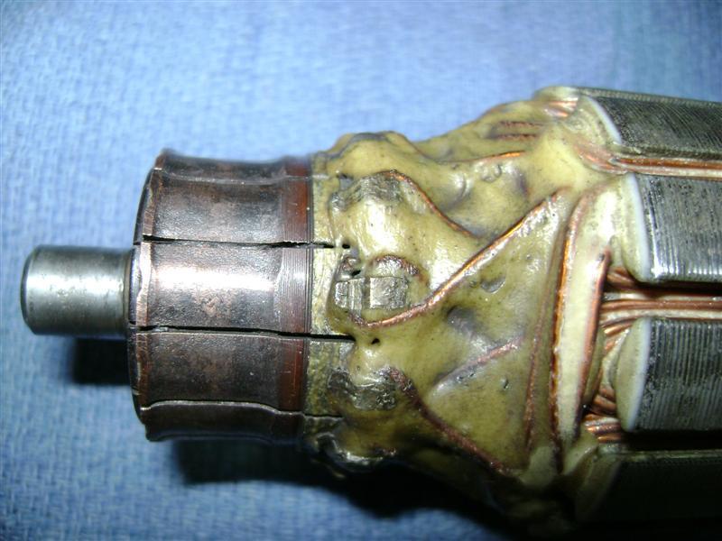

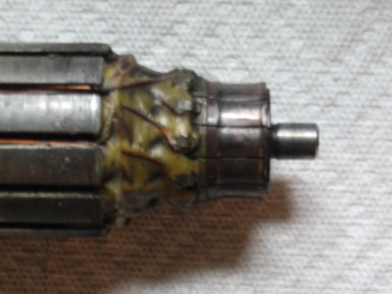

Hoser here are some pics. of the armature. What do you think?

PostPosted: Thu Nov 27, 2008 4:10 pm
Posts: 1419
Location: San Diego
That armature is WAY worn.
Those curves, high, low spots will catch the brushes and tear/rub them to pieces.
You may be able to turn or have it turned down to an even and smooth surface.

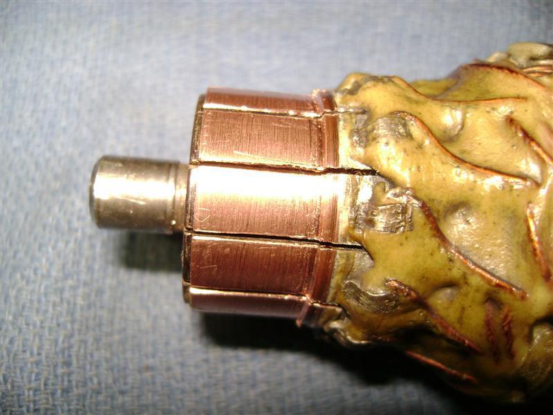

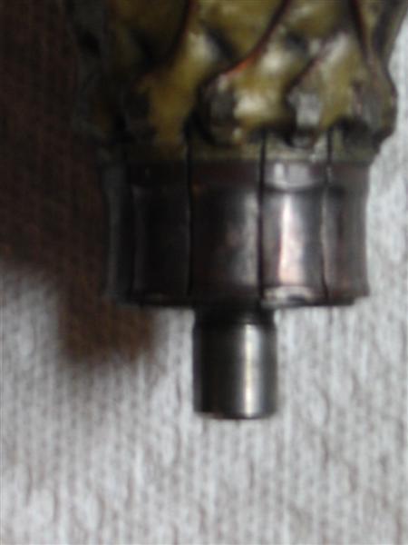

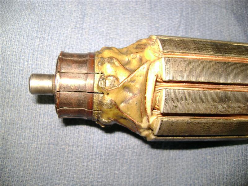

Your armature came today I turned it down, it was in bad shape, you will notice some light scratches these are from me removing the burr that forms between the copper plates while machining, they wont hurt anything they look much better than they are thanks to the flash on the camera lol
The area where the brushes ride is now flat they brushes should last much longer..
Before and after pics.
