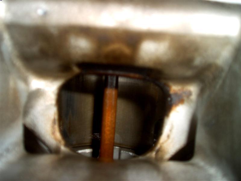

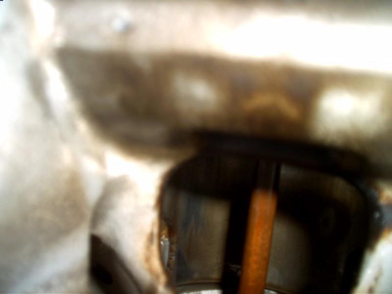

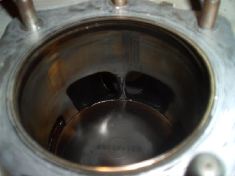

PostPosted: Thu Oct 30, 2008 8:31 pm
This is the owner if the ody (Nick, shoubadaba [Rusty's] friend). I pulled the top end off after trying to look through the intake and exhaust ports, i could tell there was scoring on the cylinder, but it was unclear. i will try to see if i can figure out how to attach pics on this post. Also, the reeds are actually stock metal ones (couldnt recall at the time, thought they were boysen), would that have a big impact on how the bike runs after it warms up?

PostPosted: Thu Oct 30, 2008 11:28 pm
Hi and welcome to the site.
How about some pics of the piston through the port openings, I see what looks like scuffing on the cylinder walls.
