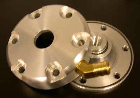

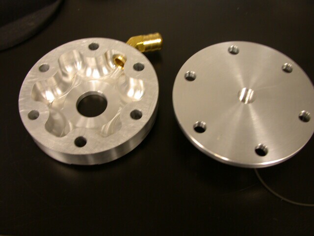

Well Here is an Example of what we do. This is a simple NSR head. We have built custom
Parts for alot of two-stroke applications. This is how we do what we do..
This is just to show some of you guys the design process.

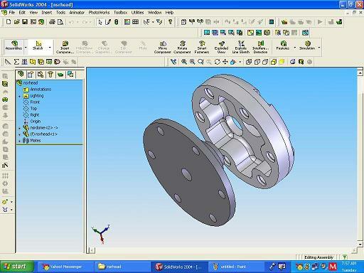

First of all we make a solid model of the part we want to make. With the Computer
model we can run stress and analsys testing and determine fits and tolerances. This
Head will be made from 7075 aluminum. althought there are alot of steps that have
been removed from this demo you will get the picture.
I use and prefer The CAD program Solidworks,
There are three major steps to making a part. first step like I said is the modeling
process:

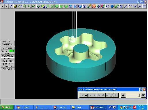

File comment: Then when we are sastified it will work, we will take into a CAM program. I use and prefer Mastercam. This will help us
generate the code for the cnc machine to cut the inside of the head. For this example we are only cutting the profile of the water jac

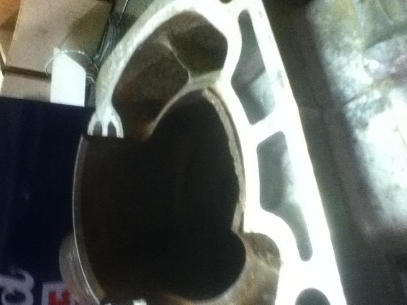

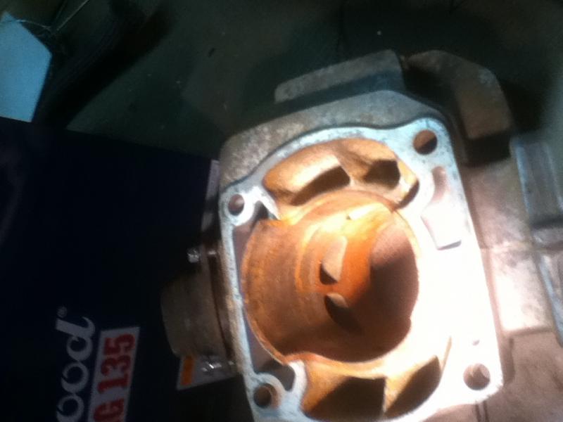

I have a cylinder that I got with my ody when I bought it that had the bottom broke off where it goes into the cases that I would donate if it would help. I have no idea what the bore measures.
Shubey
 Post subject: Re: Creating a head...
PostPosted: Thu Dec 05, 2013 9:49 pm
Shubey
Broke like this one ?
http://www.pilotodyssey.com/PO/viewtopic.php?f=1&t=3850
PostPosted: Thu Dec 05, 2013 9:52 pm
Joined: Mon May 02, 2005 3:59 pm
Posts: 129
Location: Fleetwood,Pa
A little more severe,whole side is broken off. I guess it doesn't make much difference how much is broken. I can dig it out & take a pic
Shubey

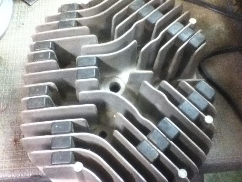

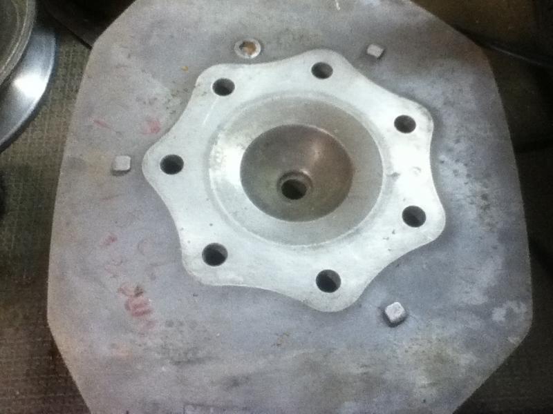

Forgot I had the original head too
Shubey
