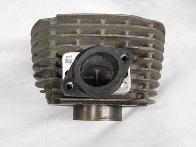

I took a one inch thick piece of aluminum and drilled it to bolt on the FL jug. Ported it from oval to round on either end and used a mikuni snowmobile flange on mine. After you do that you can enlarge the intake on the FL jug, just leave enough room for the gasket to seal. The intakes are very small on them. Ive had good luck widening the intake port windows too after fitting the larger carb. leave the bridge alone. try to keep it straight and the same volume through the intake tract.

PostPosted: Fri Oct 01, 2004 8:53 am
Like this, Red arrow is counter bore for bolting the aluminum block
to the Engine blue is where you bolt on the mikuni manifold. black
stuff is LB weld to fill it up for another application.

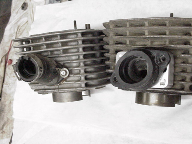

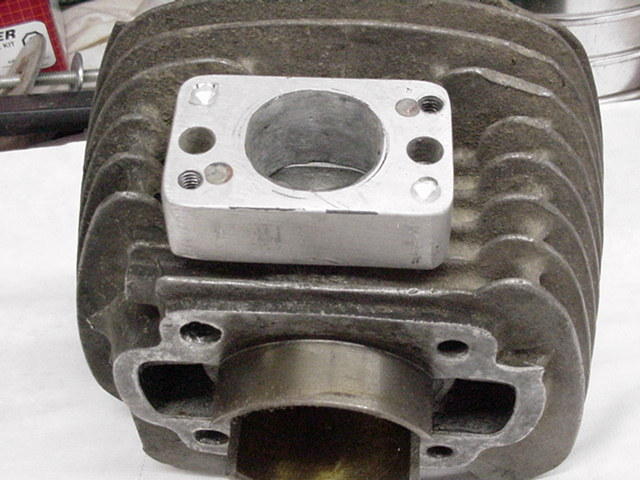

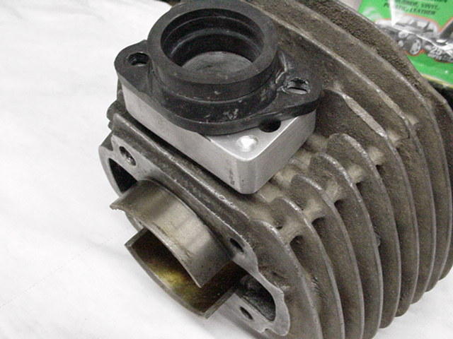

found some pics i had long forgotten. I think they came from you in the first place.

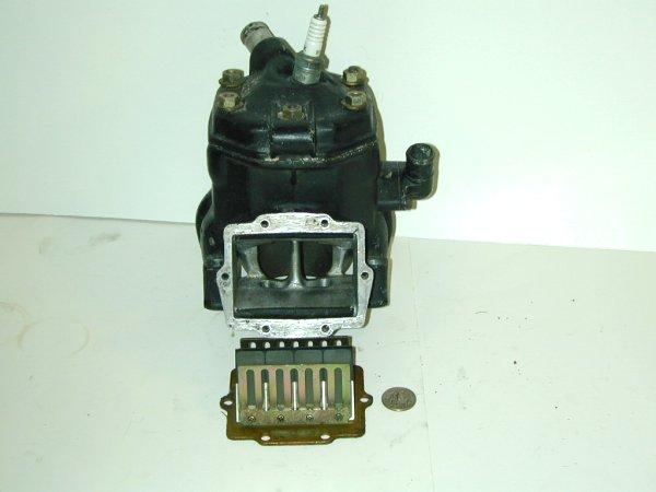

That is a pretty sweet looking intake setup for a FL250, but this one here used to breath OK. Some of the other 250 race guys didn't like it to much, but it felt good to open throttle on it, and it was one of my favorites in the good old days:

whats that second jug?
PostPosted: Sat Oct 02, 2004 10:42 am
Posts: 240
Location: Florida
Same as the one on the Engine above with a different head. They were 82-84 Kawi KX250 jugs grafted onto FL250 case. I had 3 of those engines at one time. They were built by Ed at Triple E a time a long time ago. They made good power but tended to grenade every once in a while. The bottom ends did not like the RPM's that cylinder would produce.

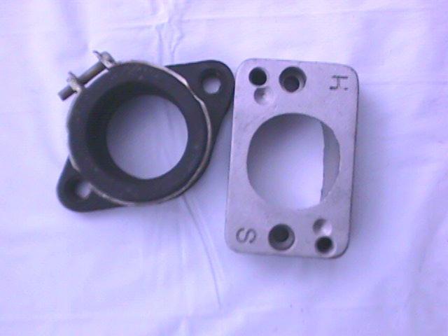

I found a pic of one of the adaptor intakes I used to have:

Wonder who SH was I see stamped on the manifold?

I don't know who H & S was. I got that intake with some parts I bought one time. Here is a pic of the boot. I have a cd somewhere with a lot of pics of my old 250 stuff, but can't find it right now.

EEE still sells a aluminum manifold like in the ody38-2t.jpg pic

I think they might have been 30.00 ?don't really remember.I think i still may have one and the boot,i would have to dig around and see.A phone call to Sara at EEE would tell all.I had bought one from them probably around 2 years ago or so.The boot though i do not think would fit a 36mm carb but with a little stretch or maybe there is another boot they offer.If i remember correctly the manifold is for the exchange between makuni and kiehin carbs or just larger carbs in general.I could give her a call and see or anyone could for that matter.I havent spoke with her for ages,so maybe i'll call anyway.If i can find it i will post pics. tim

found the correct boot at Denis Kirk http://denniskirk.com for 12 bucks. making the manifold won't be too hard.

On the manifold I think the parts number is like VM34 = 34mm VM36 = 36mm VM38 = 38mm
