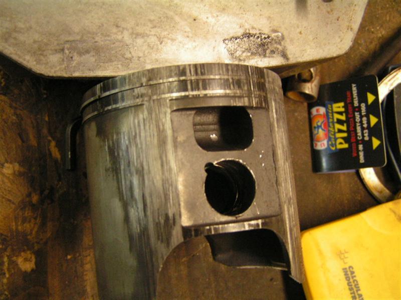

I blew it up a few months ago. Lost compression quick. I had just bored it and put a new piston in, but ran into electrical issues right after I got it running again. I was able to run it a couple hours after the last rebuild, then it sat with electrical issues for a couple months. Once I got that squared away, I ran it for a good hour or so, then lost compression. I just pulled the cylinder off, and here's what I saw. The piston & cyl are scored up pretty good along the exhaust side.

The piston-

How about some more pics of the piston, all sides including top and bottom (inside) more pics of the cylinder and head too, lets get to the bottom of this before you assemble again.
At any time did it seem like or sound like it was running out of gas?
Pics of the spark plug?
Drain out some gas and put it in a glass jar, let it set see if anything seperates, I did this with AMSOIL and a year later it was still mixed no separation.
Any idea what the piston to cylinder clearance was?
Ever pressure test your Engine to see if their is a air leak that can create a lean condition?
Any oil puddled up in the bottom end of the Engine, turn the crank over see any oil on the crank?
The aluminum can be removed from the cylinder with muratic acid and a old tooth brush, warning and caution when using acid, I leave the safety up to you but advise you do this outside and have baking soda and running water ready in case things go bad and you get it on you, face shield, rubber gloves suggested... Once the aluminum is dissolved and removed you then can give it a lite hone and measure the bore.

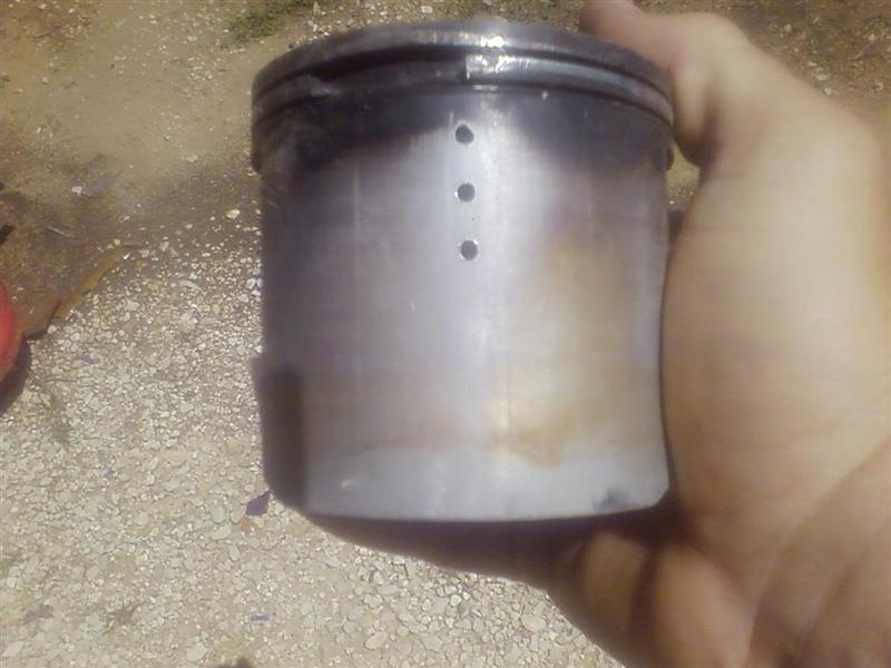

PostPosted: Mon Apr 20, 2009 1:41 pm
your holes look small and far down and apart on the piston...

I drilled the holes in the piston, I think (again it was a while ago), it was per directions I received with the piston. Turbo, those holes look huge compared to mine.

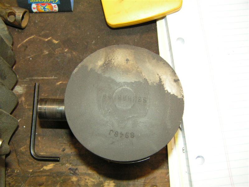

I just spun the crank over, plenty of oil on it. The plug had oil on it too. The head and top of piston have a little carbon build up.

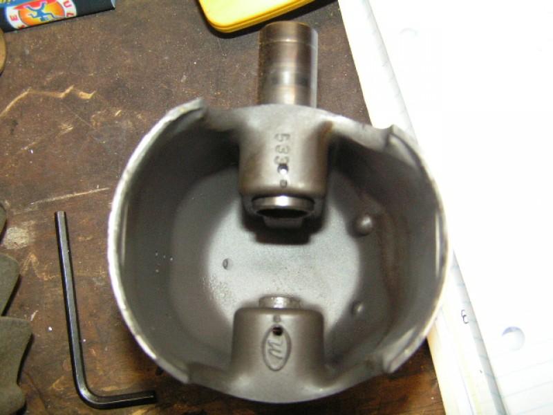

Piston-

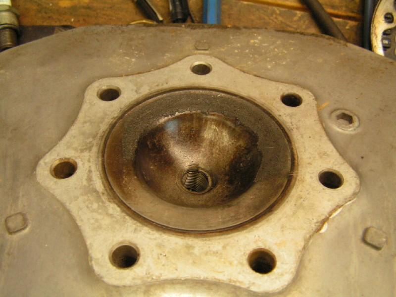

Head-
BTW, can you add multiple pics to 1 post?

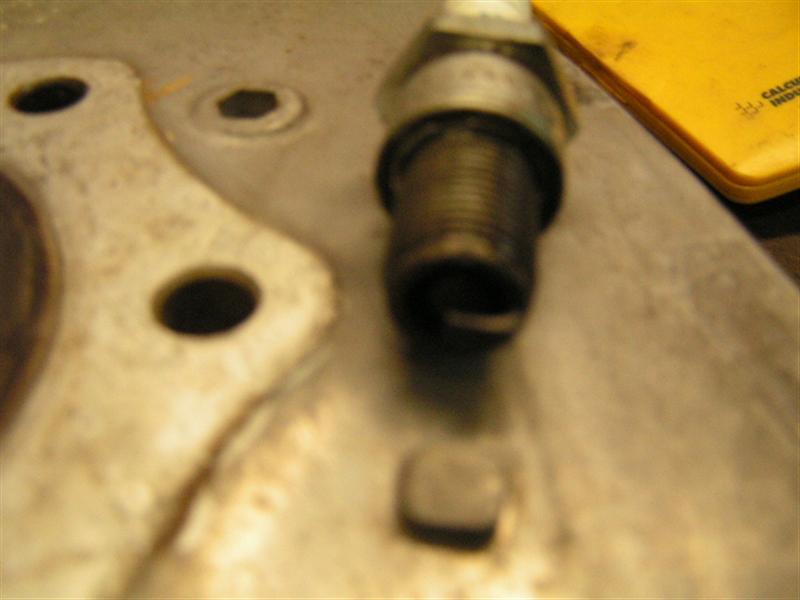

Plug-
This does help my post count though, haha.
edit- sorry, crappy pic. It's kinda black/gray, coated with oil.

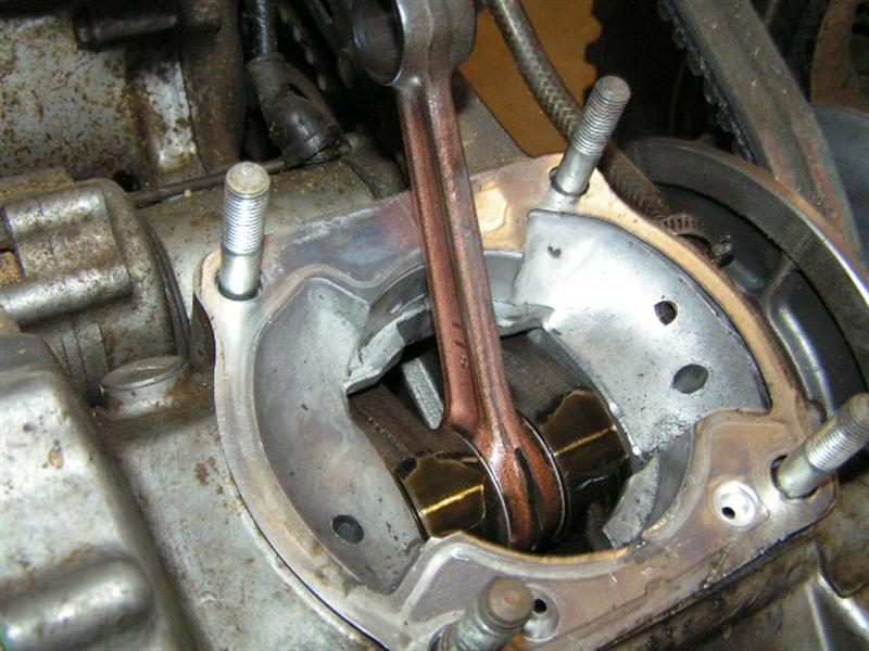

Crank and rod- Notice the discoloration on the rod, too hot?

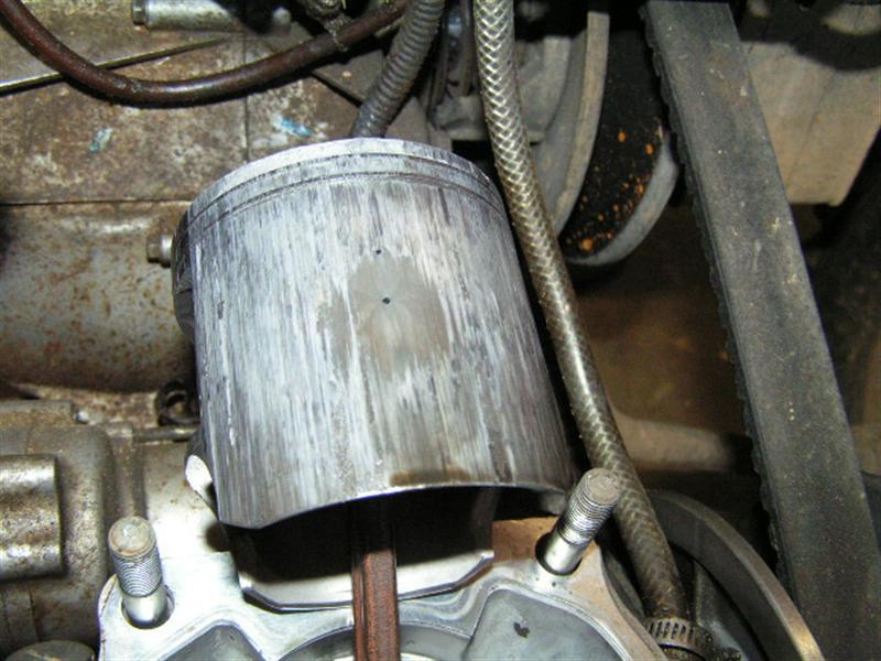

Piston side-

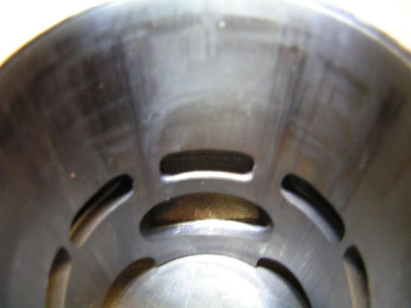

Cylinder

I am sure someone will chime in about the pics, I do not have quite that much experience under my belt yet. The plug looks rich though, was it a fresh plug or an old one? I think you can add up to 6 attachments per post, you just keep clicking on add attachment.

It was a fresh plug.
