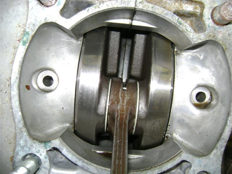

I have a question -when you check the rod clearances-do you measure between the spacers/washer on the rod side or between the cases/spacers?
Heres picture of the rod for your pleasure

It don't matter the space between all cant change.

How do you measure wear on the big end?
PostPosted: Tue Apr 21, 2009 6:28 am
Just like the service manual shows you.
PostPosted: Tue Apr 21, 2009 2:56 pm
Thank you-wanted to make sure-

Sorry I meant how do you check for actual bearing wear? Every manual will give you small end measurements and big end freeplay but not a measurement or method of actually checking bearing wear tolerances. The same question would apply to main crank bearings, apart from "feel" what else is there?
PostPosted: Wed Apr 22, 2009 8:59 pm
