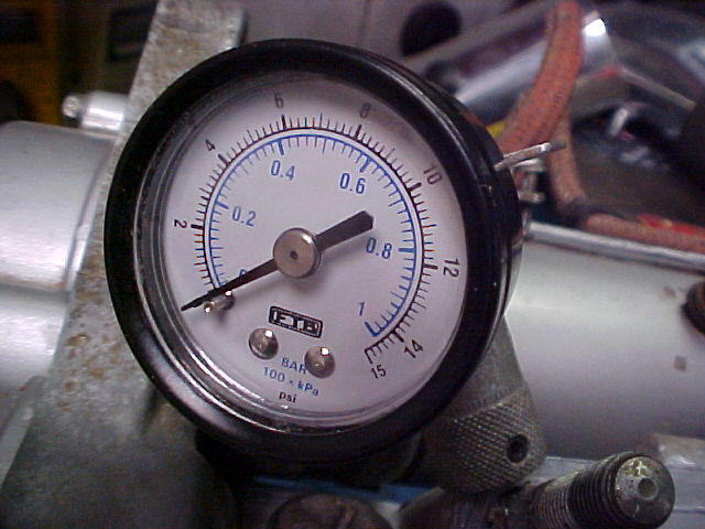

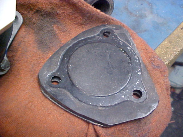

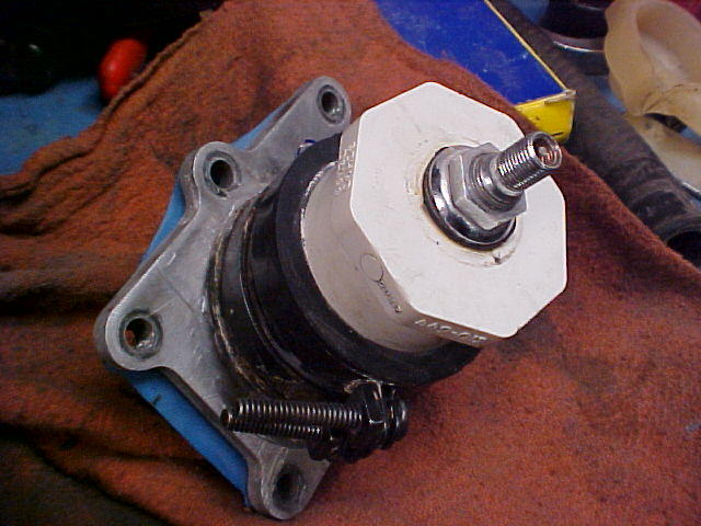

I have the one on the right(red boxed one) and never used it. It is for 4 stroke car engines. 2 stroke engines you want to keep the pressure less than 10 lbs or run the risk of blowing out a seal.
I use a 15lb guage in my tester, just easier to read slow leaks. I put the guage on the crankcase to fuel pump line. I made an exhaust block off plate from scape metal and rubber gasket. You have to remove the header then install the plate with the 3 factory bolts. I put a air fill tip in a PVC pipe stopper. It works like a champ and costs less than $15 to make. Guage is the most expensive at $10. Hope that helps or at least gives you some ideas to try.
Gary

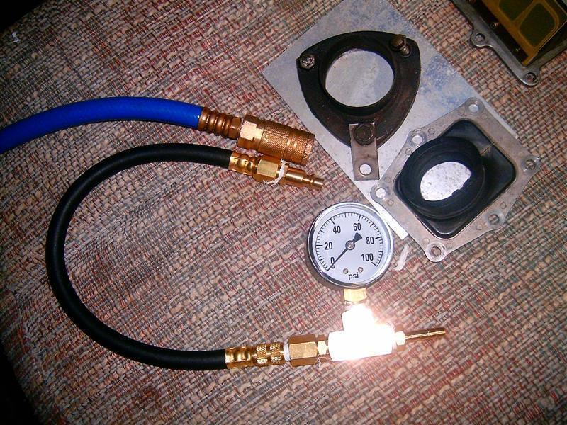

well I found a valve stem at tractor supply but its 1/8 od,not 1/4 and i cant find any adapters,so i went back to the drawing board,harbor freight had their fuel injection tester on sale for 8.99,so with parts from it i made mine,just going to hook up directly to air compressor hose with only 10 lbs of air in compressor tank.Going to just use 2 flat pieces of aluminum to block of ports.Do you think this will work or will the air slowly leak back up hose from Engine into compressor tank?

PostPosted: Tue Apr 28, 2009 7:11 pm
redskinman wrote:
never heard of it,do you think my setup will work?
also Hoser check your pm's
thanks
Your setup should work but the key thing to worry about is controlling the air pressure, with the valve stem fitting I take my air chuck and just pop it on and off fast to get it to 10 psi, their is only 10-15 psi in my air tank when do this so I cant over pressurize the Engine and blow the seals :shock:
You also need to disconnect from the air source so the only pressure your reading is whats inside the Engine, maybe a ball valve between the air tank and your kit?
PostPosted: Tue Apr 28, 2009 7:23 pm
thanks
well there a ball valves on compressor hooked to hose and hose is hooked directly to my setup,so i can have about 10 psi in compressor tank,open ball valve,fill Engine with air,then shut off ball valve,sounds like we have a winner!
