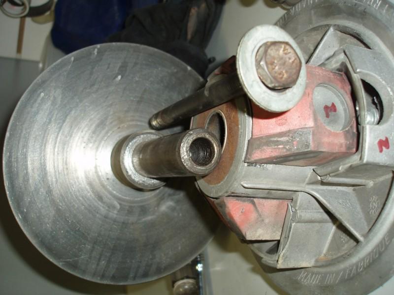

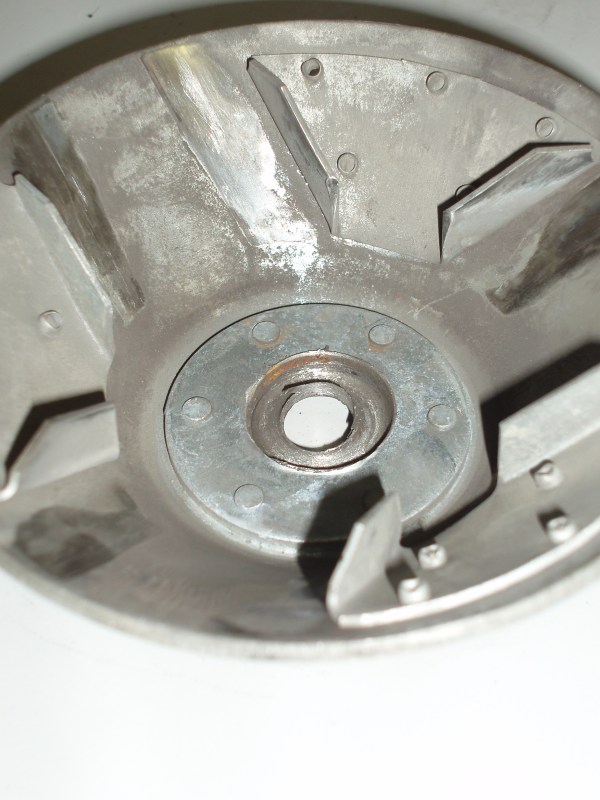

Here's a couple pictures of my Power Bloc clutch cover. Anyone ever replace just the cover? If so, any ideas on where to buy a cover? The clutch was working great before I pulled the motor (( Internal Combustion Engine ? )). The only reason I removed it was to ship the motor (( Internal Combustion Engine ? )) to Hoser. (Thanks again Hoser.) Originally, the only sign of trouble was the head of the bolt being half way recessed. Am I SOL... time for a complete new clutch?

How about some pictures of the end of the shaft on the clutch.
HRD racing can probably sell you a new cap, bolt and washer but if the end of the shaft is bad your better off with a new clutch, BUYER BEWARE of the HRD "better design curve cover" that HRD will try to sell you, if you need a new clutch insist on a ALT cover regardless what he says, also beware he is a great salesman and very convincing he also most likely has a whole shelf of his style clutches he is trying to sell. He is a nice guy and knowledgeable about clutches but IMO his main interest is extracting as much money out of you as he can get.

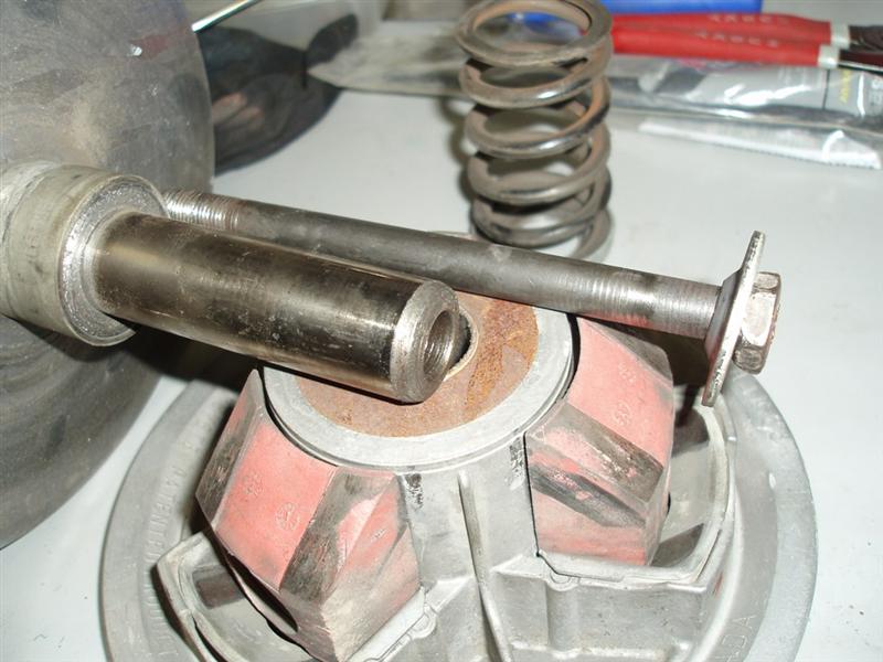

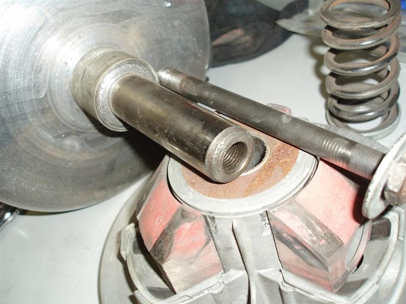

Here's the pics. 10-4 on the Alt cover. The link was helpful. thanks.

I repaired Mudbogger's shaft but your damage looks further back into the shaft than his was
http://www.pilotodyssey.com/PO/view ... tch+repair
The only thing I worry about with this repair is the thick washer I make as a spacer to replace the bad shaft I cut off sticking out and tearing up the bushing in the movable face the only thing that locates the spacer I make is the center bolt I kept the hole as tight as I could.
Yeah. The end of my shaft doesn't have anything remaining that resembles a notch for a D washer.
Time to start shopping for a deal on a new clutch...
