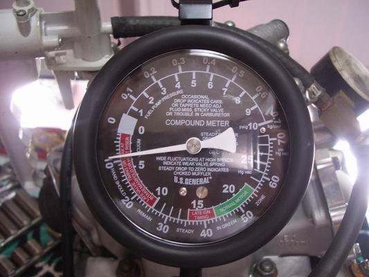

Man I like anyone. I use blank off plates for exhaust and intake for motor (( Internal Combustion Engine ? )) leak down. A rubber expandable freeze pug found can be found any parts store. As far as size just measure up your intake boot and exhaust flang. What I found to be best is take them with you to parts store and size them up. Be careful installing the one in the intake boot. Install cab band to boot and snug prior to installation of expander as not to tear boot. Put a little gasket maker to rubber plug to help seal, istall and adjust than finish snug down with boot clamp. This will prvent over tighting the plug, your screw drive will slip before a 7/16 nut. The blank off plates first will check Engine its self than one can install intake and exhaust flang and recheck. Using vacume once the intkae is installed will keep the pressure off of reeds and prevent false reading from pressure bleed into reed gage and intake assembly. The pressure will try to close reeds and the pressure levles between motor (( Internal Combustion Engine ? )) and intake will be diff untill they equalize and then provide propper reading. Now if you want to prevent this you can get pvc glue cap found at lumber yard that will fit and a fitting can be installed and teeded to the vac port used to pressure. This will balance the pressure between Engine and intake for propper bleed down pressures and provide accurate reading. If Engine checkes ok and than the exhaust and intake assemby fails it will sae you some time. I prefer not to even use the exhaust valve to make it easy and isolate intake and Engine if leak accures. Be carful to use very low pressure and vacume. I prefer not to use any more than the motor (( Internal Combustion Engine ? )) producces during an static check at cranking rpm. This can be measured with a vac/pressure gauge attached to the vac port. I video tape the test so I can isolate the frame with the highest pressure and vac measurments. This is where a might vac hand pump comes in handy besides being used for bleeding brakes. Be sure to set piston at BDC ( piston all the way down) so the transfer ports are full open. If the Engine fail test spray simple green around the plates and seals and gaskets and use some pressure to find leak. The hand vac can either vac of pressure and can check Engine using both the bleed down will be differnt and kinda interesting to why.
Hope this helps, anyone. Be sure to let us know what yo did and how it works. I think "H" has a link some where here to proper testing.

I am scrounging parts right now to make my tester and was hoping someone knew the sizes which would save me a little time. I wanted to leave the motor (( Internal Combustion Engine ? )) completely in tact to do the test. I plan on making a system that I can simply hook up to the vacuum line for the fuel pump and simply plug the intake and exhaust. Leaving the exhaust and intake on now doesn't really matter anymore....................
