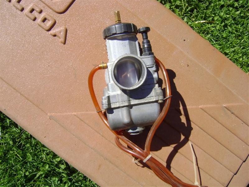

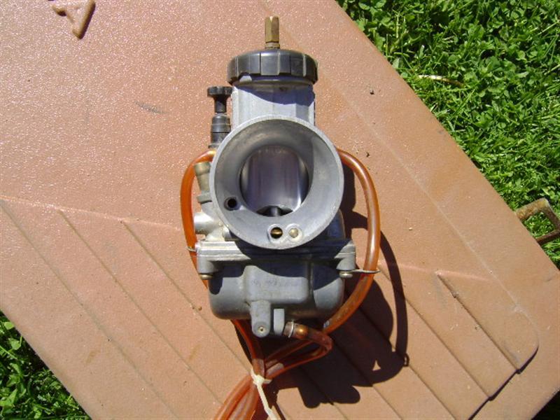

Would it be worth an effort to try and use a 36mm flatside carb that I have from my 1990 CR125 parts bike on my 89 Pilot? Stock Pilot is 32mm if I'm reading correctly..... That would give me the option of using the air box boot from that bike to try and start making my own custom airbox. I think I'm gonna try to get something with a good amount of volume then top it off with a huge K&N similar to what I saw on afastcar's and his friends machines...

Try it out, that looks like a PJ carb. should work better than stock, its actually a 34mm(I use the same one on my 250) but measures 35mm, not sure why they call it a 34mm. they only came in 34mm and 38mm. Mine is from a cr125 as well. jet it slightly richer than the jets in the stock carb and go from there. the main jet is the same but the pilot is different.

Do you know if it would work with the fuel pump or would this carb let to much fuel in that way and just dump it out of the over flow? Use the stock Pilot jet or the stock CR jetting? I believe the # is a good bit bigger for the CR????

I used the stock cr pilot, it ended up being fine for my application but yours could be different. I had to adjust the float level a little but the fuel pump doesnt seem to be a problem.
