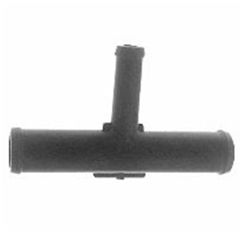

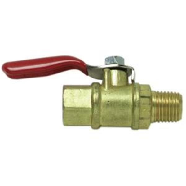

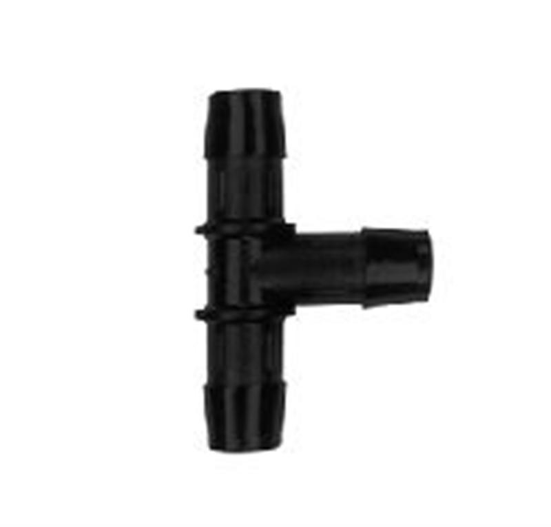

Turbo, I had the aux. aluminum tanks on both my Pilots. I used them simply to hold extra fuel, plumbed to drain into the main tank via a ball valve, thru a filter, then into the tank. Here are a couple of pics of one type of plumbing install.
I chose to use a large "T" rather than the small, copper "T" shown in the pics. Obviously the larger "T" drains the tank faster.
Autozone: look at the HELP line of parts. I think I used a 5/8"x3/8"x5/8" T connector (58 T picture)
Or try the larger 5/8"x5/8"x5/8" T connector (58 T 2 picture).
The valve is an ball-type air valve. See pics... available at Home Depot or Harbor Freight. (14 Ball Valve is a 1/4") (38 Ball Valve is a 3/8").
http://search.harborfreight.com/cpisear ... l+Valve%22
http://www.mcmaster.com/#ball-valves/=4ukcw9
