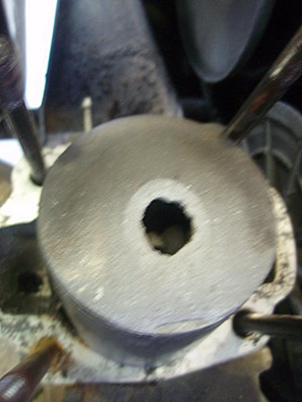

Today I went over to GarlicGregg's house and we took a look into my Engine.
He started by showing me the hole through the spark plug hole.

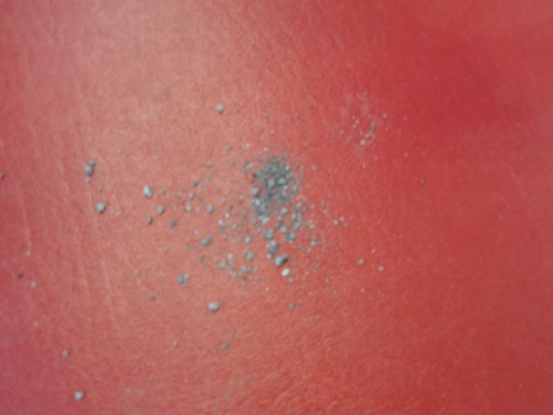

First we pulled for the exhaust and we found a hand full of metal here is a pic of what came out:

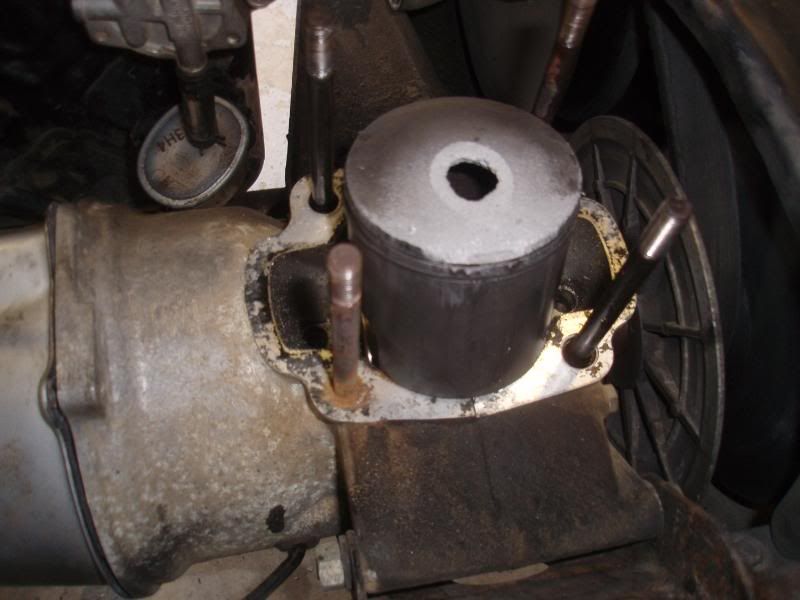

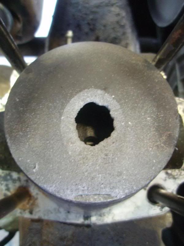

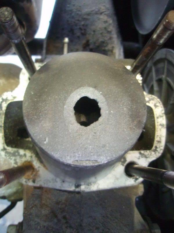

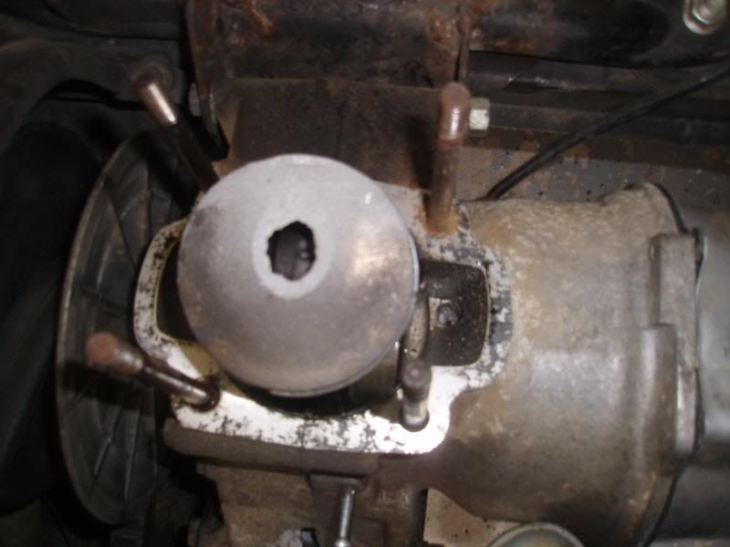

Next we pulled the upper part of the Engine off to reveal the piston. Here are some shots of that:
So I am obviously going to be doing a complete rebuild. Gregg and I are going to send our uppers out together to Hoser for our bore work. There is metal pieces everywhere! I am actually looking forward to doing the project since I have never built an Engine before.

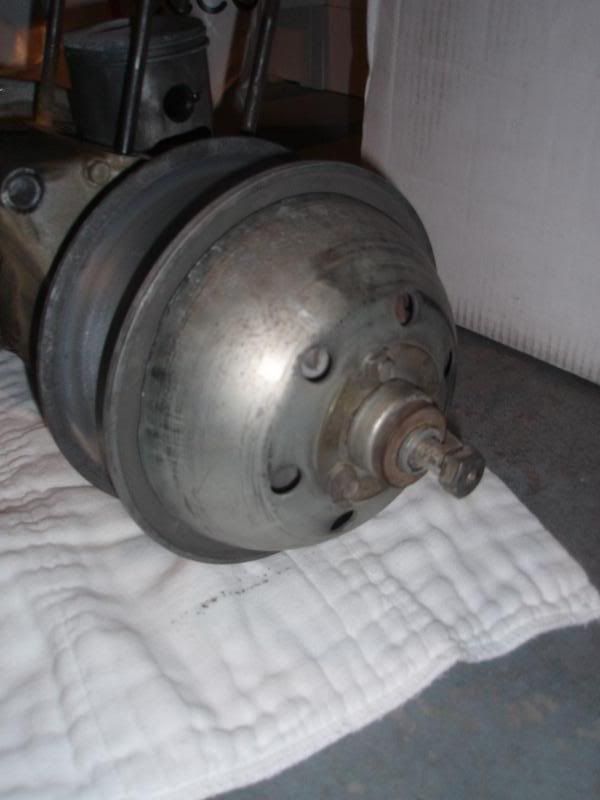

1) How do I remove this:
2) How do I remove this:
I guess these are my only obsticles preventing me to splitting the Engine.

I'm assuming this is a 250.. Or am I wrong?
More importantly, what in the hell happened to the piston???
PostPosted: Mon Dec 07, 2009 11:49 am
Man I bet that ody hauled for aboout 30 sec. that's one big hole.
PostPosted: Mon Dec 07, 2009 2:21 pm
I don't believe I've seen a burn through quite that large! That sucker's huge!
Did you guys try to find the cause before you tore it apart? Leakdown test?
Unless you already know what caused your piston melt down, make sure you do a thorough check of the fuel system before you fire it up after the rebuild. It definitely went lean which is what caused your melt down.

Leakdown determined that there was a big tear on the underside of the intake boot.
PostPosted: Mon Dec 07, 2009 3:20 pm
In the famous words of every mechanic ......... Well there's your problem! :-)

How does the rest of it look?
PostPosted: Mon Dec 07, 2009 6:45 pm
Joined: Wed Oct 28, 2009 4:38 am
Posts: 224
Gregg said that everything looks ok. I just need to know what tools I need to pull off the clutch and which one i need to remove the electronics side so I can split the Engine. Then it's cleaning time!
