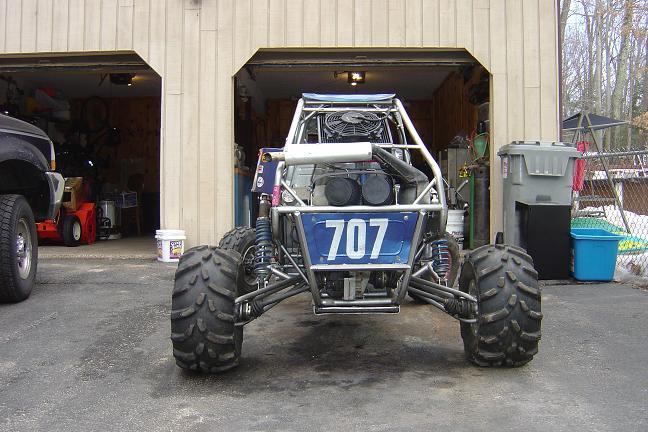

I have the rpm gear box that was used in the 350's in my briggs built car. You need dimensions? I am running VW type I axles and cv's.

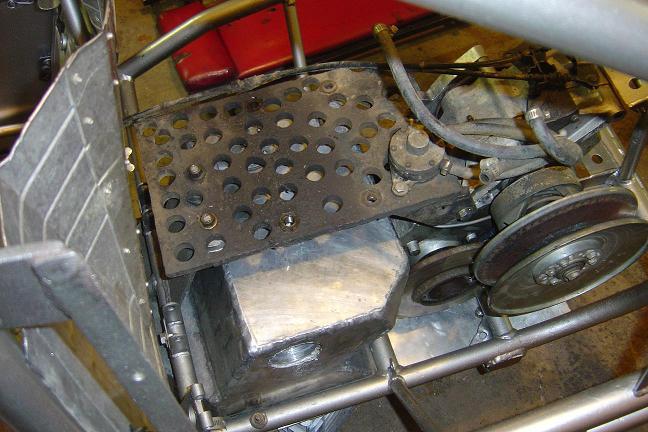

I was under the impression that it bolted right into the ody frame. If not, it shouldn't be anything more than just making up a couple tabs and welding them to the frame. For the cv's, my set up uses the vw type one hubs that slide onto the rpm output shaft. They use an allen bolt to secure them, then the cv bolts to the hub. These are the only pics I have right now. Here are a few pics to get you started. All the attachments to this tranny are custom made pieces, brake rotor and mounting, shifter linkage supports etc.

I know this is an old thread but on the last picture what is the piece coming off of the frame and going to the driven? Was it for added support because of high horsepower or ??.
 Post subject: Re: RPM trans/gearbox
PostPosted: Sat Jan 19, 2013 7:59 pm
The idea was to give more support to the input shaft... the Engine that was in the Briggs originally had much less power and torque... adding this was to support the shaft to help it from being pulled toward the Engine under acceleration...
how do you measure the effectiveness of the support as a backyard hack like myself? I don't know... but it makes good sense and it can be found of other rigs as original equip

Thanks for the reply. Makes sense. Was the bearing set up used here an over the counter part. It appears the mount was fabricated.
