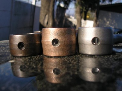

I have searched and searched and can not find much info on the rods other than one time users who love what they installed or hate them because of a failure, but I feel this info must be taken with a grain of salt who knows how long or how hard the people who like the rods have run them? and who knows if the people who don't like them didnt install them wrong, or over rev, or over heat their engines? we need a reputable Engine builder to let us know what they use and why.
Hoser, I would be willing to buy one of each Hot rod, Pro X, And Vesrah and have them shipped to you so you can look them over in person and tell us what you think?
Also the wrist pin end of the 500 rods are wider, the wrist pin bearings that come with the 500 kit wont work you have to use a FL400 wrist pin bearing. will the wider rod end effect the oiling of the bearing? should we have a machinist (speedchaser) fly cut the 500 rods to make them the same width as the FL400 rods?
File comment: Stock on left Vesrah and Hot Rods on Right

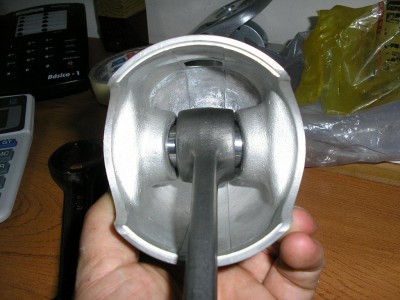

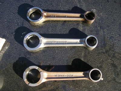

Quote from the post on the other board,
"Vesrah 5004 (9,48 Oz)
Hot Rods 8139 (10,37 Oz)
Stock Rod (9,06 Oz)
The Pictures show the Rods with Stock Bearing and Stock pin install in the Stock Piston.
There is less side clearance with the small end of the Vesrah and Hot Rods, between the rods and the Stock Piston.This might even limit or reduce the ability for the small end bearing to receive lubrication.The Vesrah has a bigger hole for lubricacion than the Stock Rod and The Hot Rods has 2 bigger holes for lubrication than the Stock Rod, maybe this can fix the lubrication problem.
In the big end no problems, all the rods, bearings, pins and washers are the same. Hot Rods has 2 oil grooves like the Stock Rod, and the Vesrah Rod has 4 oil grooves, better than the Stock Rod.
These rods must be used with the Stock Piston Pin Bearing. The bearing comes with the Kit doesnt work with Stock Piston, maybe with Wiseco Piston."

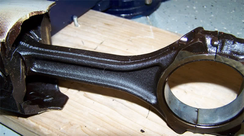

I know you don't like us stockcar guys much but its how I grew up and where I learned, as far as rods go when we ran claimer engines we would run stock rods but we would beam grind them (that's what we called it) we would grind/polish the casting ridge off the sides of the rods with a belt sander to make them smooth to help relieve stress, I don't see why it woudnt work for a 2 stroke?

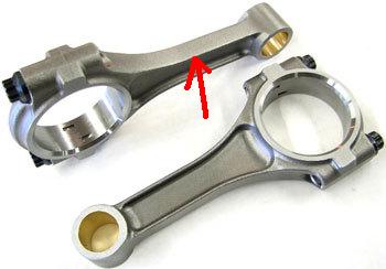

File comment: I know this is a after market rod but this is how the beam would look on a stock rod after sanding/polishing.

Yeah that all old school on all parts remove sharp edges to remove stress risers in the metals, its covered pretty well in the 2 books I listed above it also tells what not to do...
Most the 2 stroke rods I have seen look like they been tumbled to remove the rough edges.
For a while one of the rods think it was hot rods came polished rumors ran ramped all over the web they were faster because their was less drag whilst rotating making more HP, I never seen anything solid to support such claims, sounded good probably made for good sales too :-)
