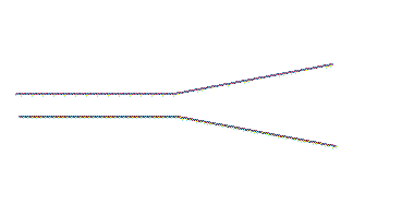

Adding Divergent Tubes, which used to be called "Megaphones," to Two-Stroke Pipes Helped Make Useful Power

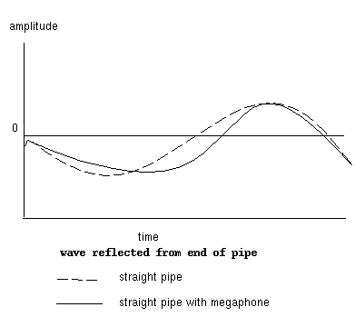

Putting a divergent cone on the end of a straight pipe lengthens the returning wave, broadening the power band and creating a rudimentary expansion chamber.
So, to sum up, when the negative wave reaches the exhaust port at the correct time, it will pull some of the exhaust gases out the cylinder, helping the Engine to scavenge its spent exhaust gas. And putting a divergent cone at the end of the straight (parallel) "head" pipe broadens the returning wave. The returning negative wave isn't as strong, but it is longer, so it is more likely to find the exhaust port open and be able to pull out the exhaust gases. As with plain, straight pipes, the total length of the pipe with a divergent cone welded on determines the timing of the return pulses and therefore the Engine speed at which they are effective. The divergent cone's critical dimensions are where it starts (the distance from the exhaust port to the start of the divergent cone is called the "head" pipe), while the length of the megaphone and the rate at which it diverges from the straight pipe determine the intensity and length of the returning wave--A short pipe which diverges at a sharp angle from the head pipe gives a stronger, more straight-pipe-like pulse. Conversely, a long, gradual divergent cone creates a smaller pulse of longer duration.
In addition, the negative wave is also strong enough to help pull fresh mixture up through the transfer ports.
And while adding a divergent cone to the head pipe produced great tuning advantages, it had its limitations, too: The broader negative wave from a megaphone can still arrive too early and pull fresh mixture out of the cylinder. That's exactly the problem that Walter Kaaden had with the factory MZs. He realized that putting another cone, reversed to be convergent, on the end of the first divergent pipe would reflect positive waves back up the pipe. These positive waves would follow the negative waves back to the exhaust port, and if properly timed would stuff the fresh mixture that was pulled into the pipe back into the exhaust port right as the piston closed the port. Kaaden immediately realized a large power gain, and the expansion chamber was born.

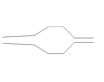

A complete two-stroke pipe has properly tuned header, convergent, belly, divergent and stinger sections--a difficult process.
As the forces in a two-stroke pipe design have become more well-understood, designers have been able to create engines that take more advantage of them and in fact require an expansion chamber to run at all. For instance, a modern pipe has a gently divergent head pipe to keep gas velocity high near the port, a second cone of "medium" divergence, and a third divergent cone with a strong taper. A belly section connects to multi-angled convergent cones, which should exit in a straight line into the stinger for good power. As you can see, modern two-stroke expansion chambers create a complex scenario and are quite difficult to tune. Stay tuned to upcoming issues of Motorcycle Online for reviews of software that promises to simplify pipe design.
