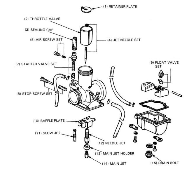

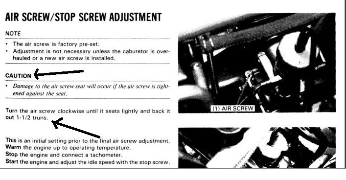

Untill you download or get manual hers some pics. Need any thing else just ask away. Were all her to help any way we can.
