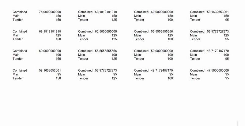

Stixs here is some basic rate info for spring choice. Here is a pic and a pdf of the pic. Hope the info is correct. Some one can link you to a spring calc.
Stixs basic spring rates.pdf [10.98 KiB]
Downloaded 131 times
PostPosted: Sat Jan 05, 2013 9:46 am
Adnoh where do you find the time to record all the information you have? Very impressed!
PostPosted: Sat Jan 05, 2013 4:41 pm
Thanks Mudd. I own my own business and I use the time to purge my brain after a stressful day,week or month. Plus I like the what if. The chart was pretty easy based off the info others put on here and link to it using the basic dual rate math. Put it in a spreed sheet copy and past then save as a pdf. It gets better if Stix and others are willing to share some numbers to enter into my spring rate chart. I think other may find it interesting the correlation between the numbers other than "that's what I did". The "what I did" is important as it tells a story of the shock shafts in action based on poundage of the springs rate and settings. He's a tid bit for the head to wrap it's self around. The combined rate in the chart is based off of the main and tender rates. however it tells you nothing more than that.
What if I told you the bottom out poundage for a 150 over 150 is the same as a 95 over 150 if that's all you did was change the tender spring and left the rest alone. The ride would change though, but how? Could be wrong though.
So who want to play. Stix you posed the question so lets do some math and have some fun.
Based of the above at a ratio of 1 to 1 the bottom out poundage is right around 1200 lbs. Now what if I told you I could change the spring rate via the chart with an 100 over a 125 and made around a 2" adjustment and maintained the 1200 lb bottom out poundage. AHHHH softer through the combined /main rate and yet maintain bottom resistance or make an 1.2 adjustment in another area and achieve the same thing and still improve the ride. Is it the ride your looking for, don't know more to play into it.

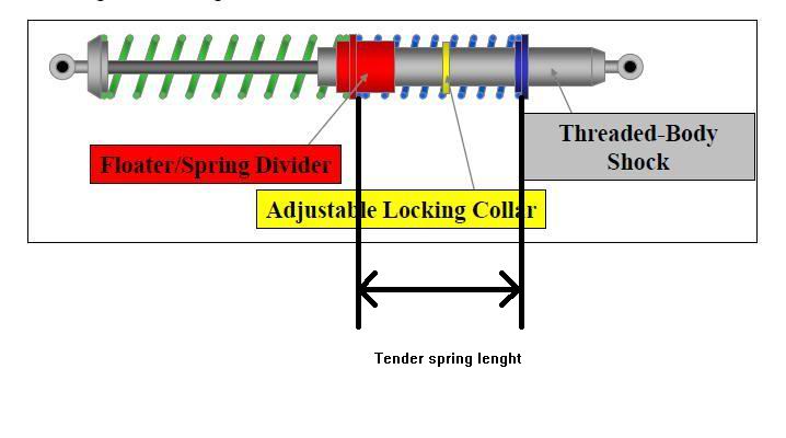

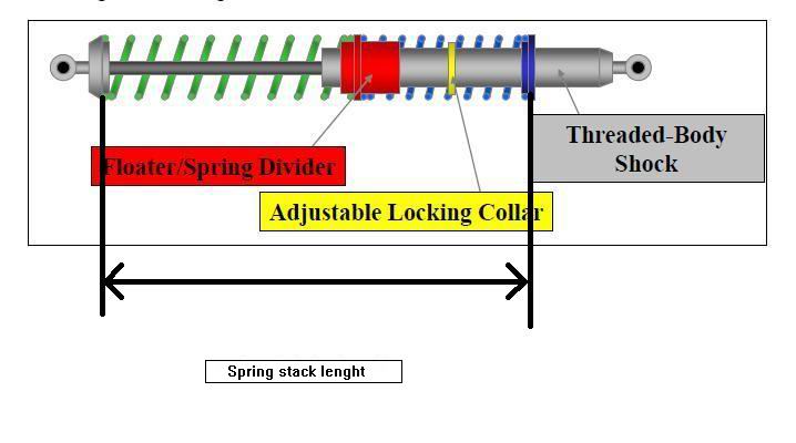

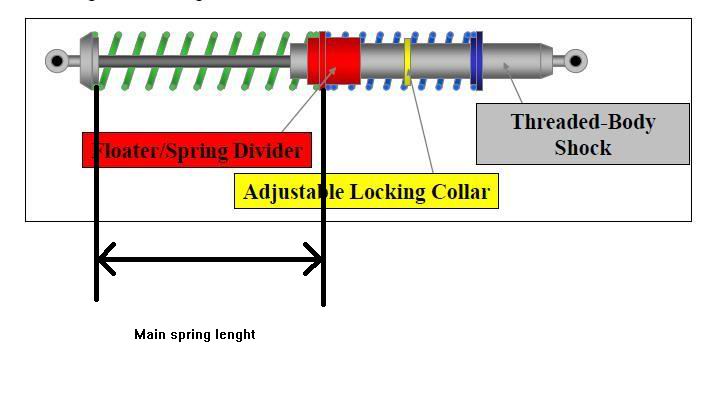

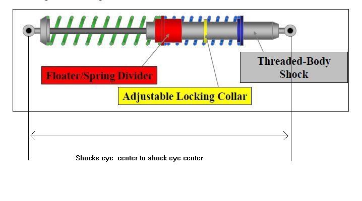

PostPosted: Sat Mar 09, 2013 4:28 pm

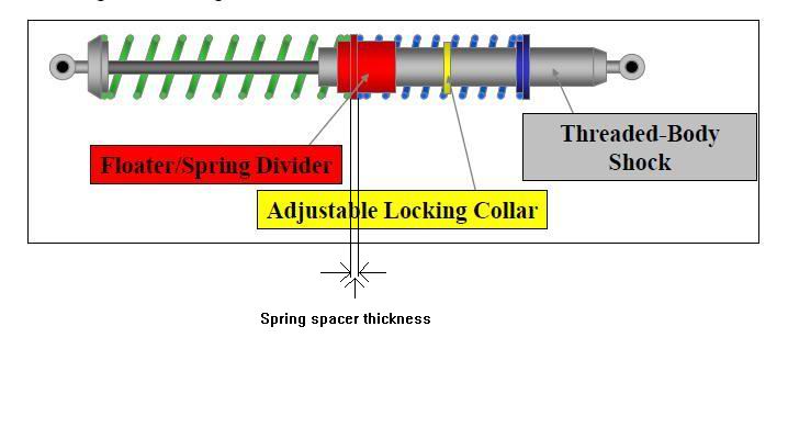

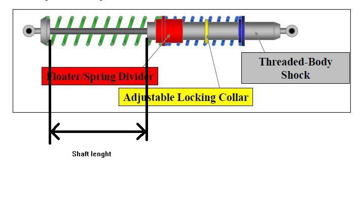

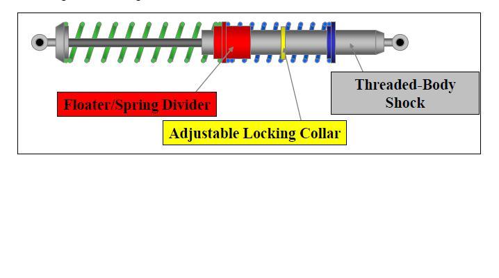

Thanks lee. Advice I will take on the dynamic once we get a spring rate and setting for stixs. He is going to start off with a 100 over 125. This will give us springs of 100,125 and 150 to play with. I found a pic on the net that i worked up to show the numbers we will be getting and using hopefully easy for other to follow. Hope I mocked them up right. Once I get his numbers I will or he can share.

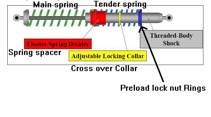

PostPosted: Sat Mar 09, 2013 4:30 pm
more pics

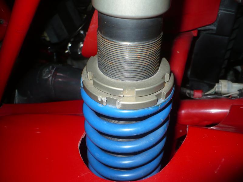

PostPosted: Sun Mar 09, 2014 9:21 pm
I need to go back over this thread. How do I break loose these 2 nuts on the shock?? I have one of those spanner tools that is supposed to grab that nut but they are really stuck together
PostPosted: Sun Mar 09, 2014 9:35 pm
First spray some PB Blaster on them let them soak then take a soft punch like aluminum or brass and tap the top nut counter clockwise while having someone hold the bottom one from turning once you get it broke loose you can probably just use the spanner to turn it if you have two spanners then use that over the punch...
I would put never seize on the threads messy shit but keeps them from locking up.
