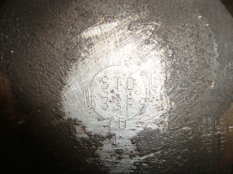

is this the original piston out of a 350. need to know cause i might by this motor (( Internal Combustion Engine ? )) for a really good deal. but the guy is not sure what bore its on, so he sent me this pic, but i have never seen those numbers before.

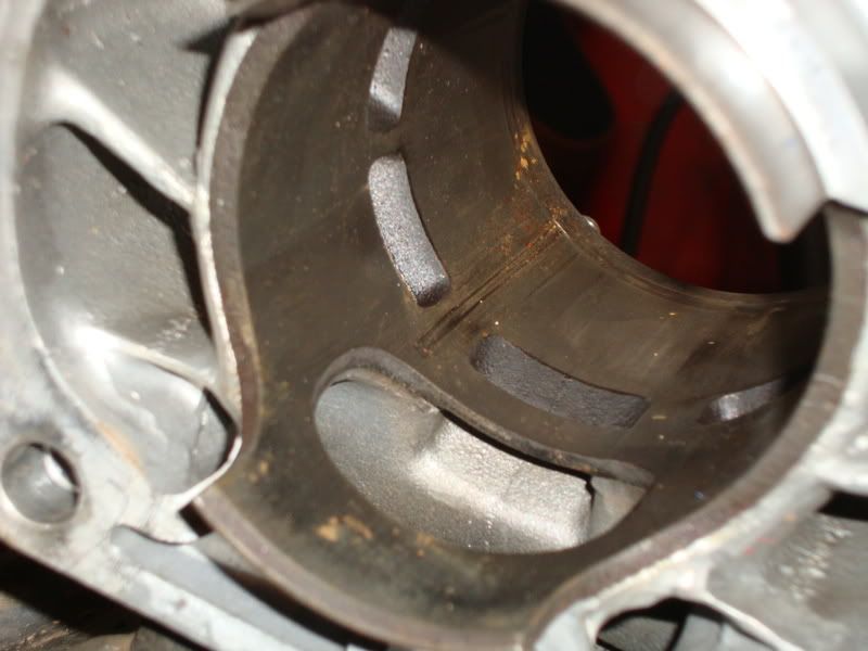

heres a pic of the cylinder.

Here is the chart, since you cant measure the cylinder bore you have to assume that is the piston that was installed and it was the right piston, you also have to assume the cylinder needs bored at least once over.
I have found many cylinders that they had so much clearance between the piston and cylinder you actually had to go 2 bore sizes to 1. clean up the cylinder bore and 2. establish the correct piston to cylinder clearance.
Ask of ATV Racing has ever worked on it.

The numbers on the piston are on the chart I attached to the last post here it is again.
PostPosted: Fri Feb 18, 2011 5:52 pm
sorry my bad hoser i was looking the numbers in blue. so this motor (( Internal Combustion Engine ? )) is still on its first bore then if i am reading it right.
