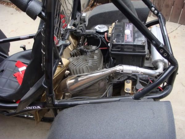

Randman, I went ahead and picked up a FMF silencer to go on the DG pipe I have... very much like what you have going on in your pics.
Decided that I am going to try to chop 3" off of the silencer to get a better fit on the rear cage.
Essentially attempting to do a "shorty" exhaust.

Just finished cutting down the silencer... took off 3".
All finished up!
Can't wait to mount this baby tonight.

Sorry I didn't get any pics until today. It's been a hectic week at work.
Not too happy with my first attempt. Going to fab another bracket (a little longer) and see if I can get the angle to match the rear cage at least.
Another issue is that I would like the pipe to exit in the little corner opening like some of you guys have done.
PostPosted: Fri Feb 25, 2011 1:20 pm
After looking at your pictures of your mount it just re-affirms to me the crap that DG makes. I noticed that your pipe is tucked well within the frame with your pipe cut short. My pipe sticks out at an angle. This is why I was so curious about seeing pictures of your installation.
Also note the distance between the elbow bend of the pipe in the frame between yours and mine. I have at best 1/2" of clearance between the 90 degree elbow and the frame where yours has probably 1 1/2".
Have I ever mentioned I think DG's quality control sucks!
