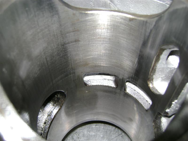

kartman01 dropped off his Pilot Engine for a CSI, he is doing a Pilot resto what better time to go through the Engine to ensure its up to snuff.

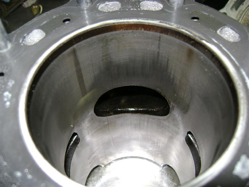

After removing the head I found light scuffing on the cylinder wall and trails of light blow by can be seen.

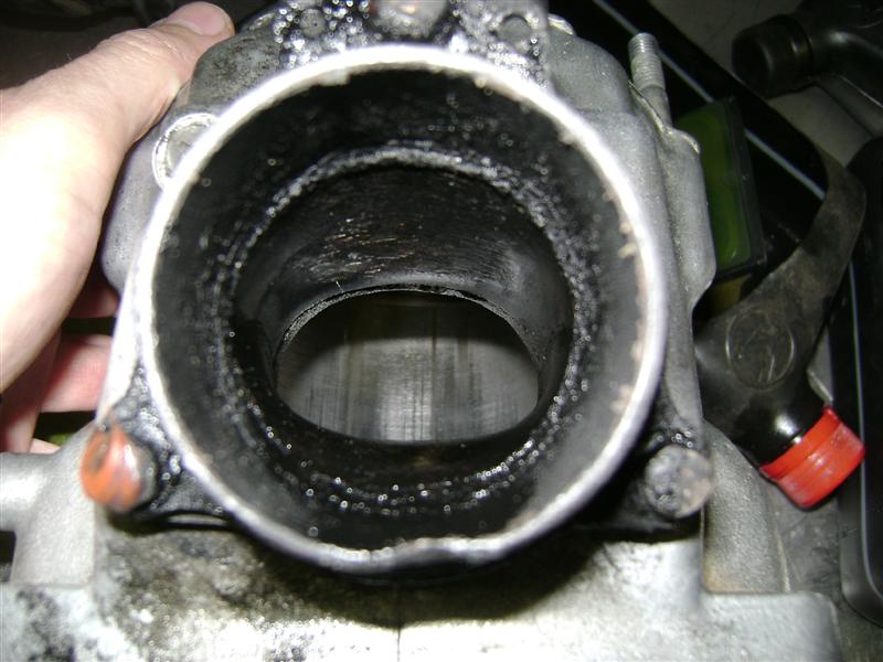

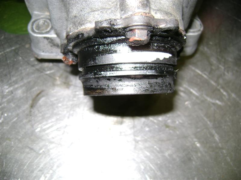

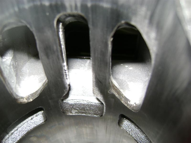

Exhaust is messy, this is a 1990 cylinder and full of the typical casting flaws, the 89 castings were so much nicer and higher quality.
Note the end of the exhaust flange is bent.
The metal ring on the exhaust was missing.

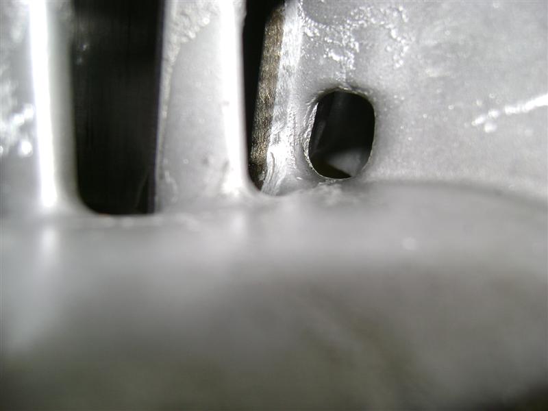

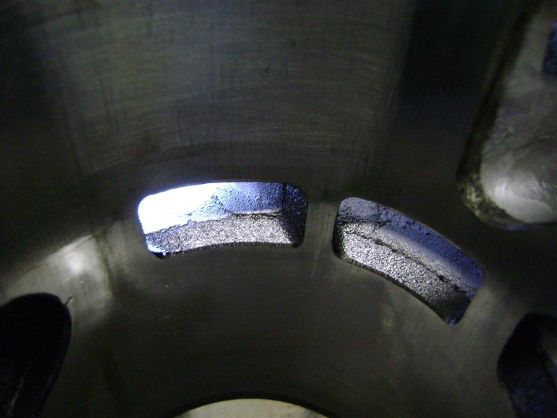

Red arrows show some of the casting flaws.

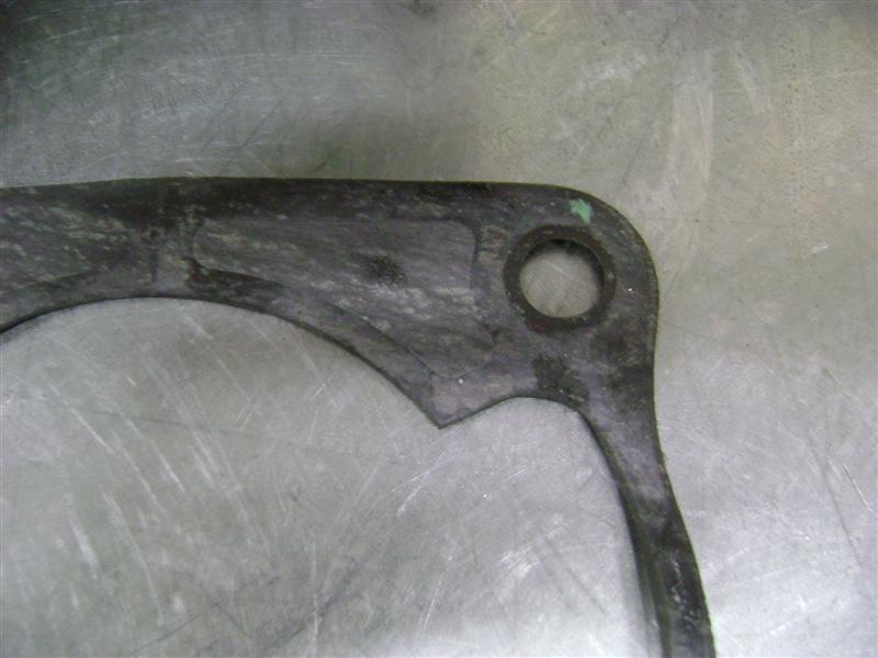

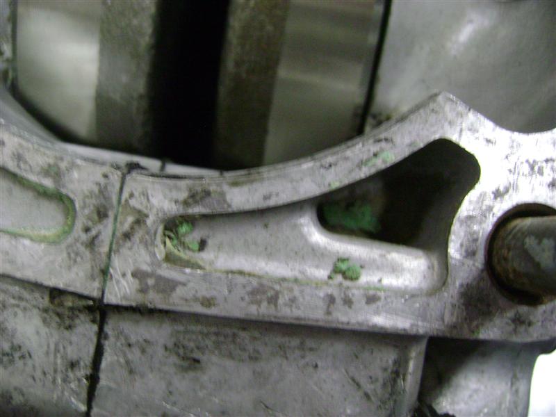

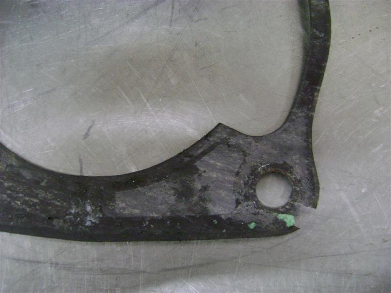

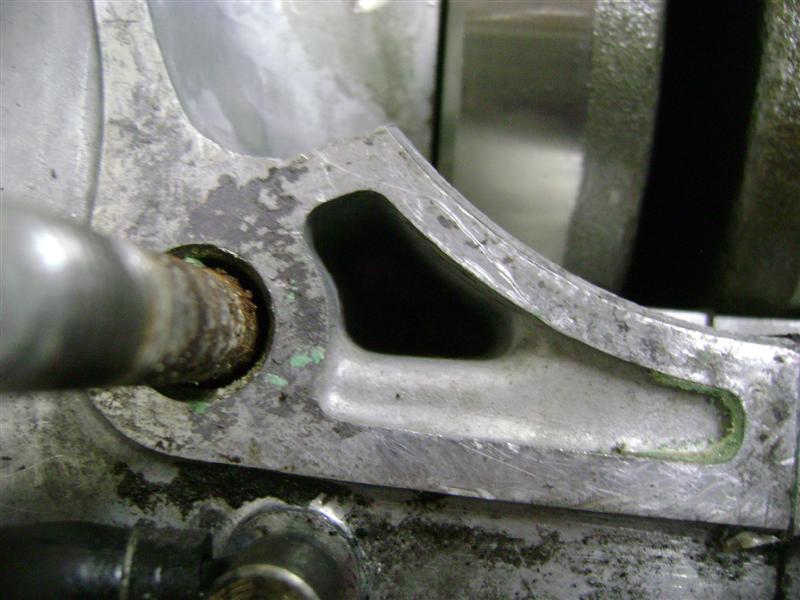

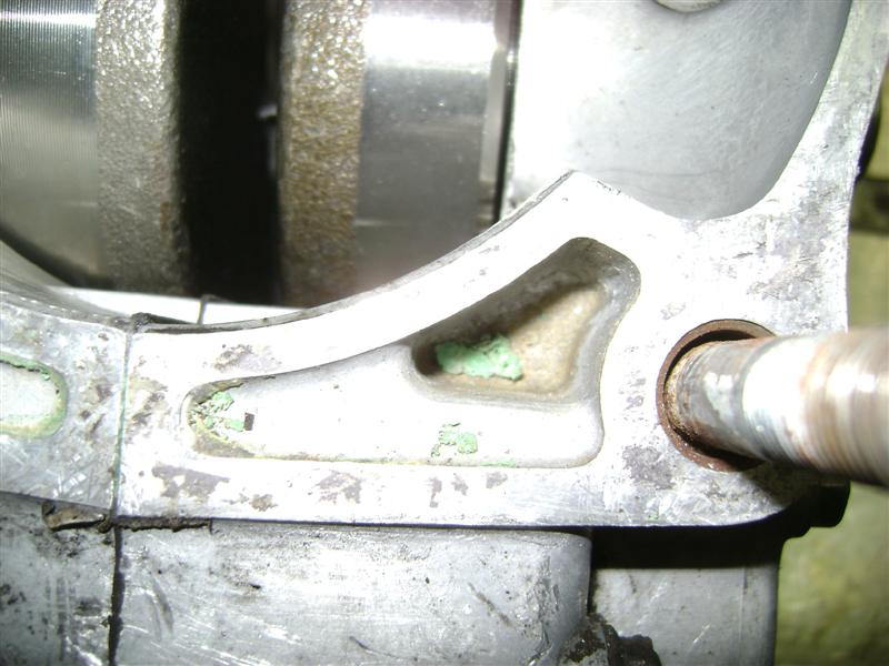

After removing the cylinder I discovered who ever rebuilt this last time never scraped off all the old gasket material the current gasket is brown, all the green you see is the gasket that was before this rebuild, some left on the gasket surface itself, the lose gasket material they didnt even bother to clean up before assembling the Engine, you look at the brown gasket and you can see green gasket material stuck to it, wonder how much fell into the bottom end then was never removed before assembling then had to be washed out by running the Engine.

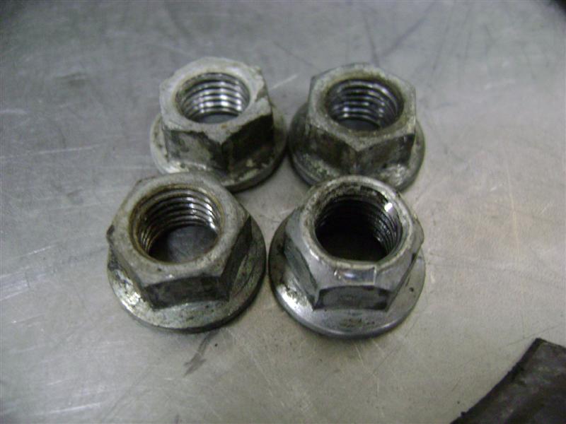

They must have lost one of the OEM cylinder nuts then replaced it with a after market nut, its a locking nut, how do you accurately torque a lock nut?
See the difference?
A new nut was ordered.
