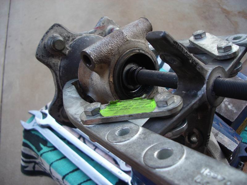

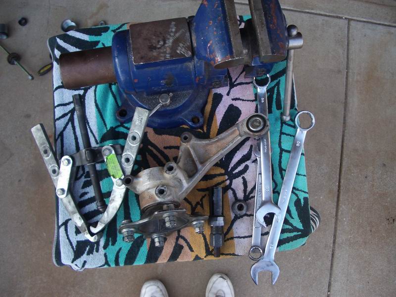

You can rework them with out a press. A large puller, inside bearing puller and bering driver kit can do the job if you carfull. IF you do not feel comfortable remove them and take them to a Honda shop to do the work. I have preformed this many time with no issues and no cave man tool aka: BFH ect is used. IF you want to get new tools by all means do it.
Here is some sample pics of a back yard hacker method

Very nice work adnoh
Most all the ones that I have done where by hand tools
just need to take your time
The biggest problem that I have seen is removing the long low arm bolt
most of the time it's rusted there good :shock:
