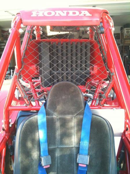

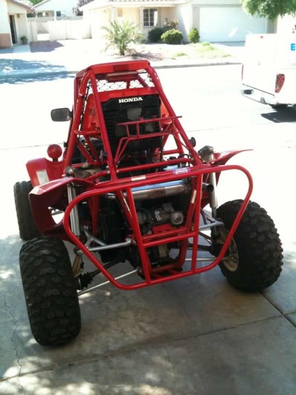

Can anyone tell me what's going on with the radiator setup? I have seen many FL400's like this but am not sure if this is factory or not? I am used to seeing the radiator lower to the Engine with a shroud around it.

How do you view the pics. I click on it and it goes to google and that’s all. Radiator relocate kits moved them up higher. I like it as it was easier to service the carb.
I figured it out. Not the stock carb, most likely 39mm keihin. Definitely need an air box. Atv racing made/makes a radiator relocate kit this may be one.
