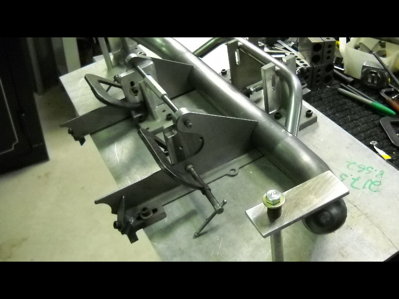

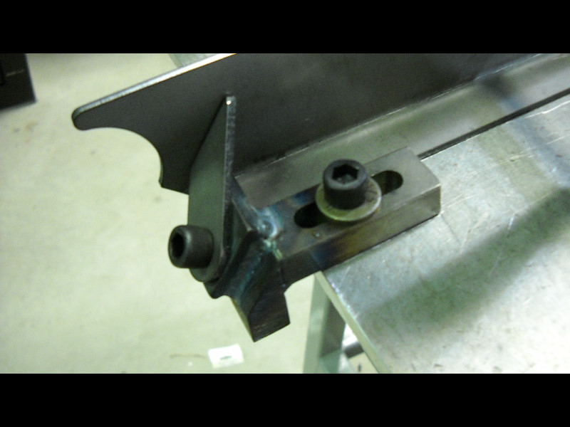

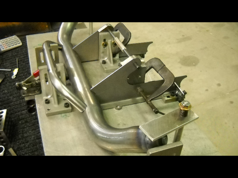

Well here it is all done with welding fixture
First one off turned out good need to tune it in a little
The bumper has the same top tube as the fl350 and grab Bar ( not a tow bar ) :)

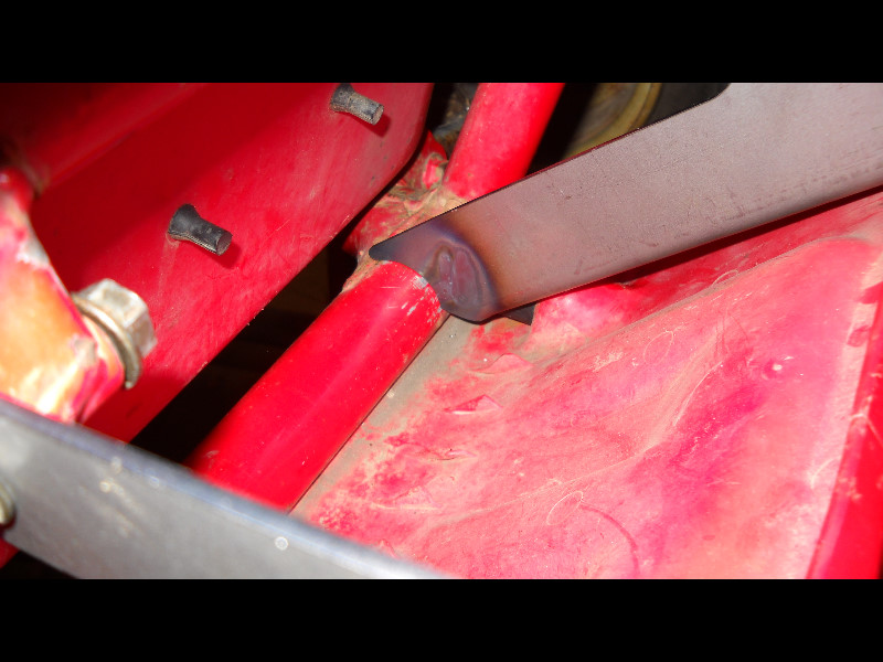

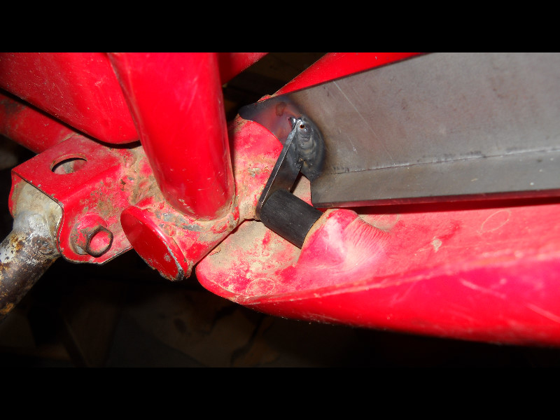

there are two down brackets made out of 12ga steel bent on a 90 for strength
the flange can be drilled for a skid plate of your making
it has two hole for the stock Honda plastic and will need 1" spacers and new lower bolts
See pic's
Thanks SpeedChaser
P.S. I have not worked up a price yet but will be soon
File comment: making of weld fixture
File comment: all bolted up ready to weld a bumper

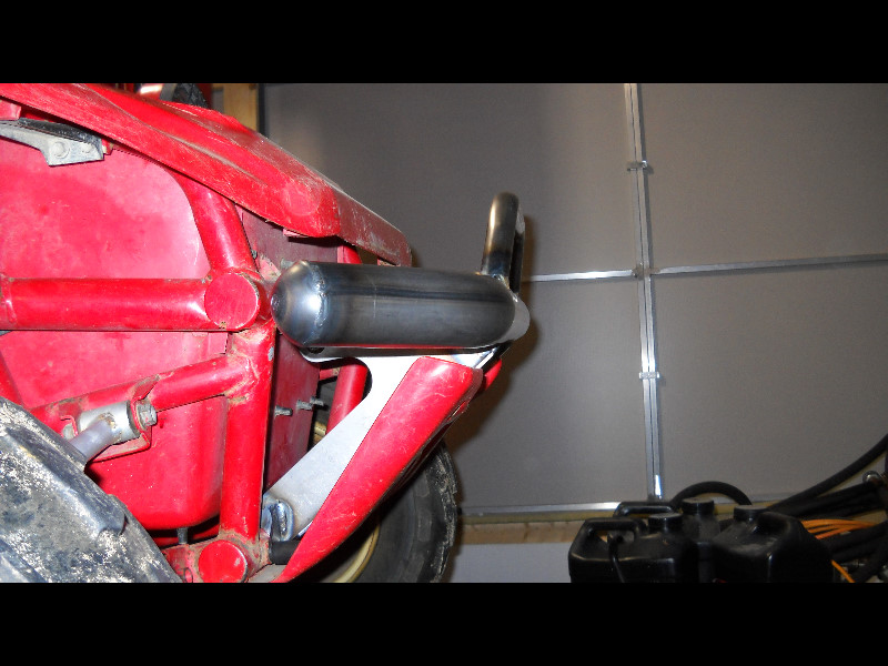

File comment: side view
File comment: close up of lower tab

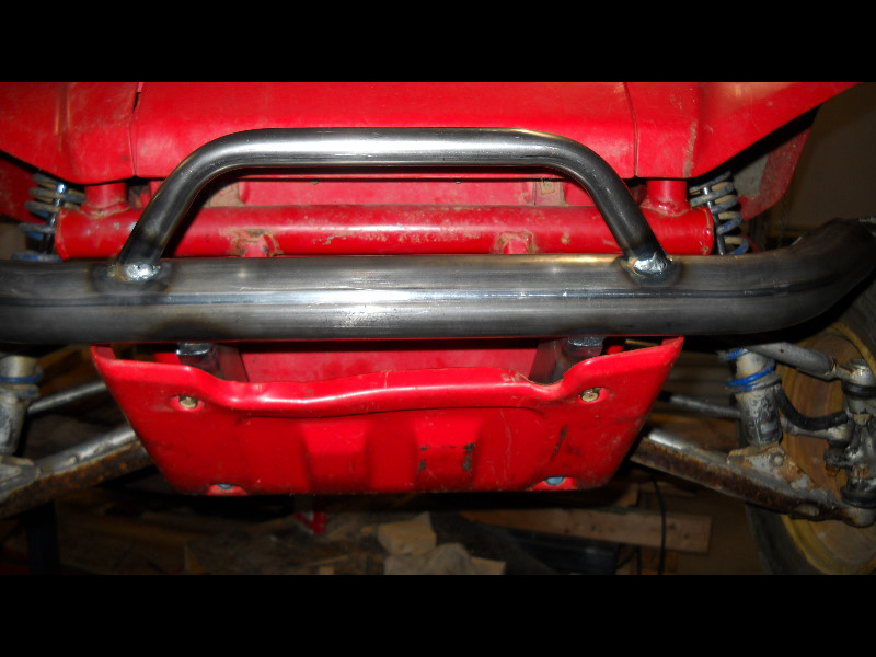

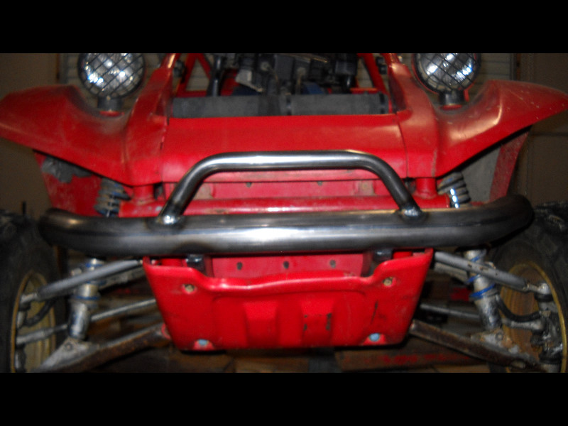

Here is some pic's after welding up first bumper
fit was not to bad fixture need a little fine tuning
thanks for looking
Speed
File comment: after first bumper off the fixture
not bad need to pull around to get all the bolts in but I'm working with a bent up front end not to perfect but close

File comment: lower tab with 1" spacer added for plastic skid

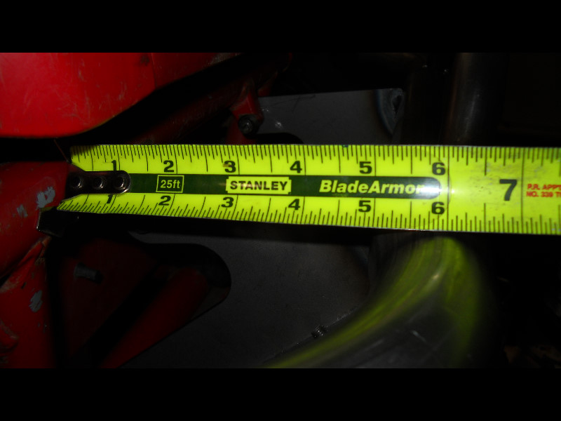

File comment: bumper sits about 6-1/2" out forward from top frame tube

Hello I have the fixture all tuned in
will have 8 front bumpers ready to go out next week starting 2-7-12
The bumper will be bare steel full welded with grab bar No bolts or spacers will be supplied
