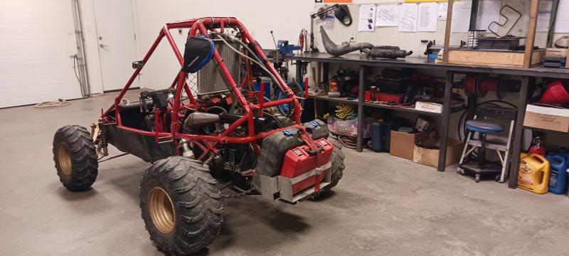

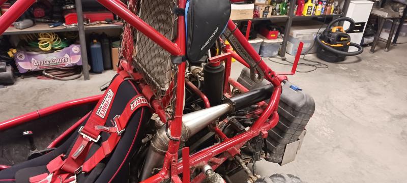

PostPosted: Mon Jan 22, 2024 2:31 am
A couple of pictures.
I have to hang my tool box and lunch box at an angle on the hidden hitch because if it fits flat on the back the transmission was getting hot due to no air flow.
Only thing missing on the pics is my lawn chair that goes across those two hooks above the cross bar.
You can also see a couple of bicycle bags on the down tubes at the back. These are WAY cheaper than those bags for the Honda Talon but smaller. I keep poo paper in one of them in case of emergencies.
