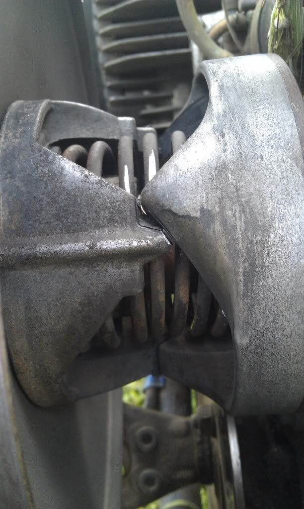

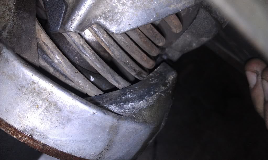

i need to remove my driven pulley on my odyssey and was looking threw the manual and didn't find any thing
my slippers are warn completely off and might of ruined the aluminum that it slides on looks like it did
and how long do the slipper last on a driven pully?

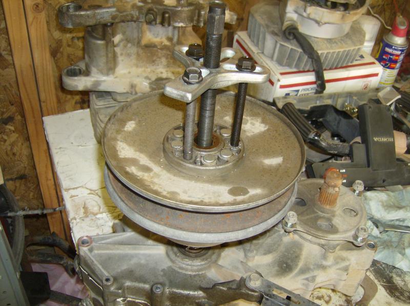

When I rebuilt the Ody for my daughter I had to use a puller to get the Clutch off the trans. here is a pic I hope it helps & good luck..
im using the same puller as you
what did u tap the hole to?
i just tapped it to 5/16-18 and it just stripped out under high stress
the dam thing wont budge
any other sejustions?

Someone probably assembled it years ago dry and its rusted together so you have a 7/8" shaft 6" long?? bonded together plus the key.
I had one on a FL250 gear box that I let soak about a year with PB Blaster eventually I took the clutch apart so I could put a rubber hose over the shaft put in a bunch of PB Blaster then pressurize it with air to force the PB Blaster all the way through to the other side and around the key even then it was a bitch to pull .

i don't have a year to wait
did you see the pic above?
the slippers ground into the face of the driven
and im trying to pull it to see if its not scrap metal
so the last thing i want to do is destroy it

PostPosted: Fri Apr 20, 2012 2:46 am
finally got the driven off
took 3 hours and lots of pb pentrator to get it off
lots of rust on the shaft
finally backed up the pully with some washers brazed to some nuts helped alot
found out its destroyed
