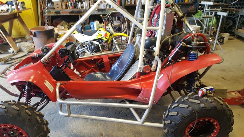

PostPosted: Mon Jun 20, 2016 12:46 am
Posts: 266
 Post subject: Re: AkPilot Project
PostPosted: Mon Jun 20, 2016 12:50 am
Posts: 266
I had a chance to meet up with the master fabricator ak Pilot and can't say enough good things.
His Pilot is insane!!!!!! More to come
