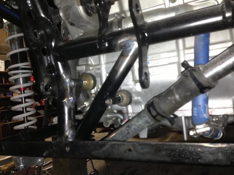

After last weekends first run I noticed too much Engine movement. On the Nytro I put a 2 stroke torque snubber on the Engine, well that Engine doesn't move at all and not knowing how much the snubber was helping I did not do a snubber on the Apex Engine. That and there was no clear cut place to put it anyway, so before I went out again, I made two.

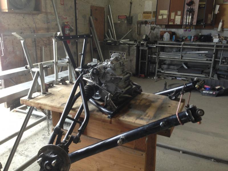

File comment: The sub frame is in two pieces, so I took out the transmission sub frame. I had to do this to get the trans out or it would have been welded in with the rear suspension mounts above the trans.
File comment: With the trans out I had ample room to work on the snubbers.
File comment: I put one snubber on the case over a bolt galley. The second I cut off a cast hole (still don't know what's for) made smooth put it there.

Good thinkin' on the "Double Snubbers" Diablo.(Try and say that fast 6 times when you've had a few?) :-)
Covers more areas/planes of possible rotation with 2 at different heights.
But really dissapointed you slackened oof and did'nt put in 3!!! :-)
