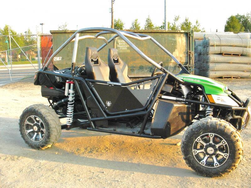

Purchased a Wildcat in Feb of 2012, number #35. Picked up in March and knew it would not stay stock long just loading it up in the parking lot. I decited to ship off clutches before I even rode the thing. So while waiting on clutches I build these:
Ak

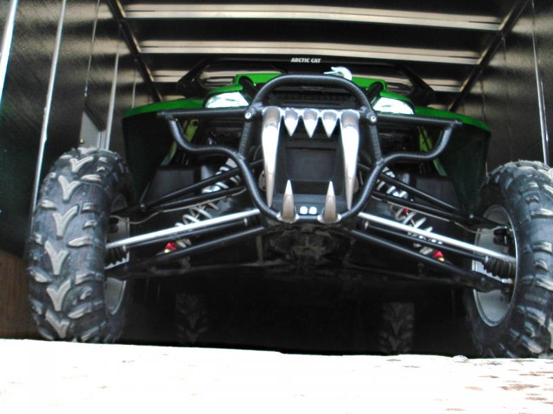

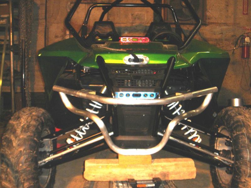

File comment: The front bumper needed somthing?
File comment: So I added Bling......just cus

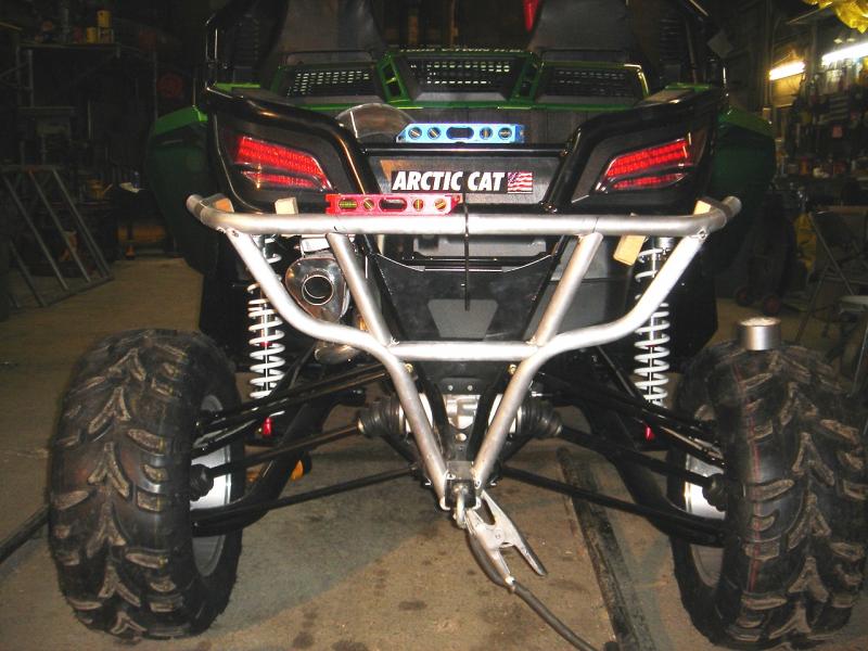

File comment: Made a rear bumper

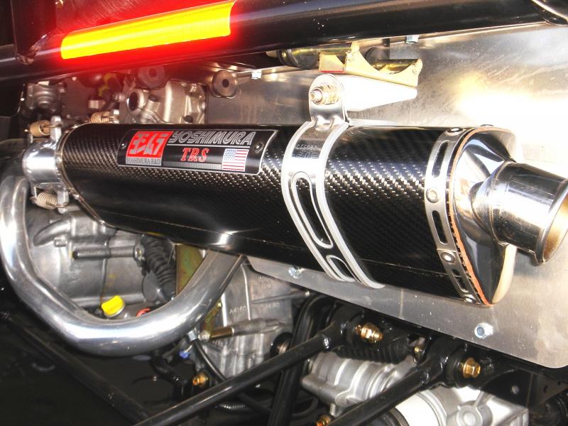

File comment: Then took a '99 GSXR pipe from the 1/2 off bin, cut front off and welded to fit Wildcat.

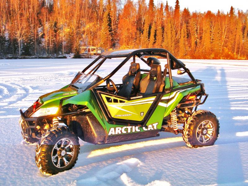

File comment: A ride out at big lake just before Tyler and I decited to put in the Apex

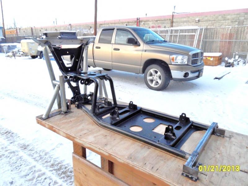

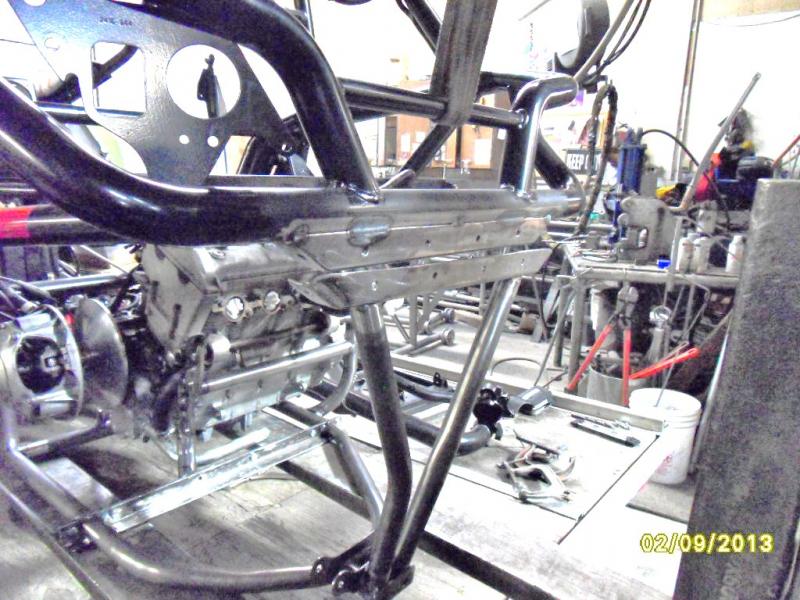

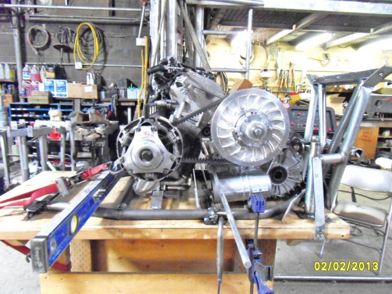

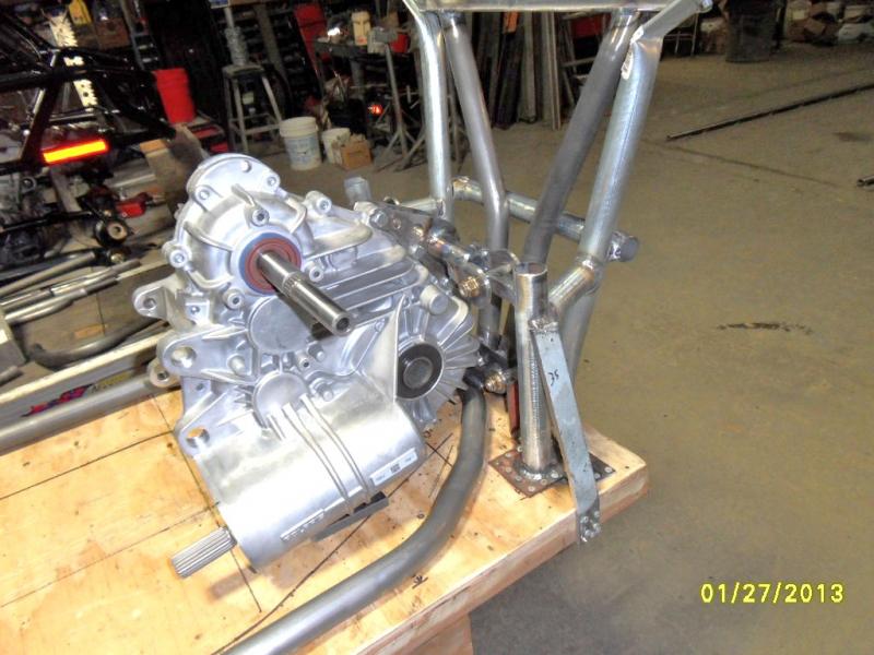

Since the Wildcat Engine and trans are one unit I needed a transmission. I'm going with a Polaris 900 XP trans. Looked on RZR sites and they have good track record of Apex's in both RZR S' s and 900's so that's what I'm doing.
File comment: Cut frame just behind the seats and just below the hip rail. Made a jig table holding original subframe
File comment: XP 900 Trans is wider so I'm making the suspension mounts wider - 3/4" on each side
File comment: Bottom of new subframe with new lower mounts
File comment: XP trans with upper suspension mounts.

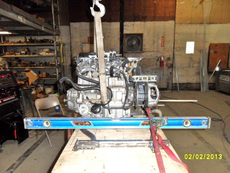

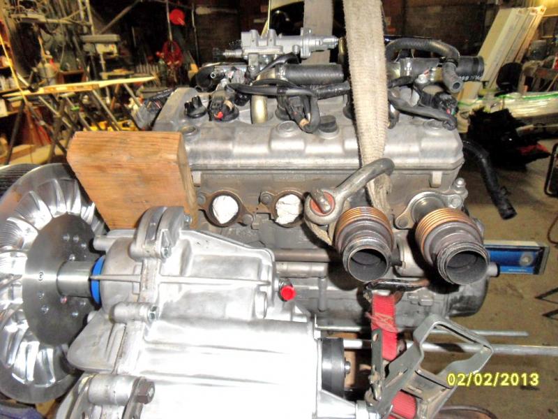

File comment: Setting in the motor (( Internal Combustion Engine ? )). I originally purchased this Apex before the Nytro Pilot build, but the motor (( Internal Combustion Engine ? )) was too wide for that frame so I made it into a sled and rode it for the past 4 to 5 seasons.....LOVE this motor (( Internal Combustion Engine ? )) but it was always destin for a buggy.

File comment: Header will be FUN!!! Yea that is 1.5" from #1 cylinder to trans.

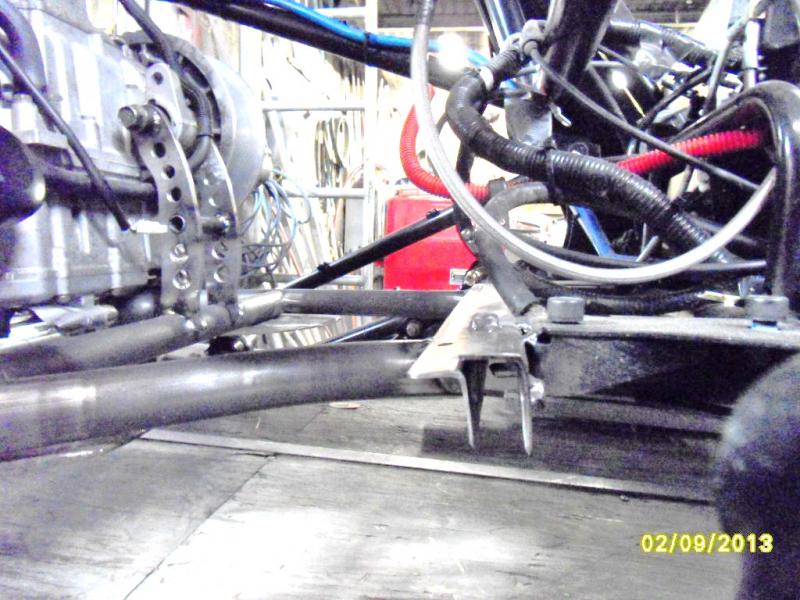

File comment: Front mounts, which I changed....

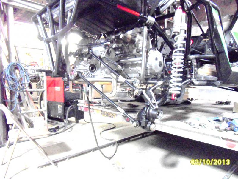

File comment: Test fitting to see if she fits, front lower mounts

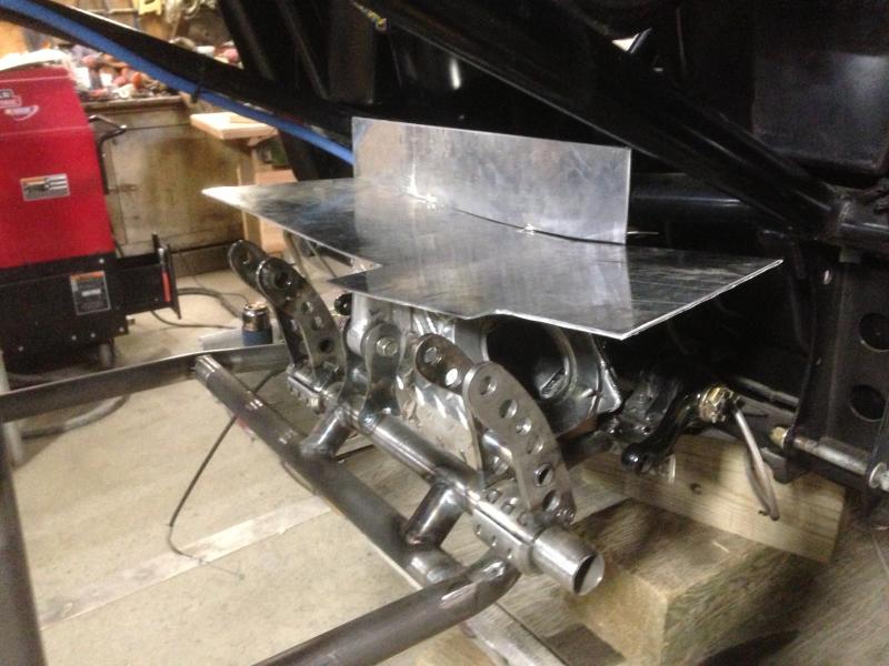

File comment: She fits, I will be pushing out the trailing arms to the outside of OEM mounts and make new outer mount

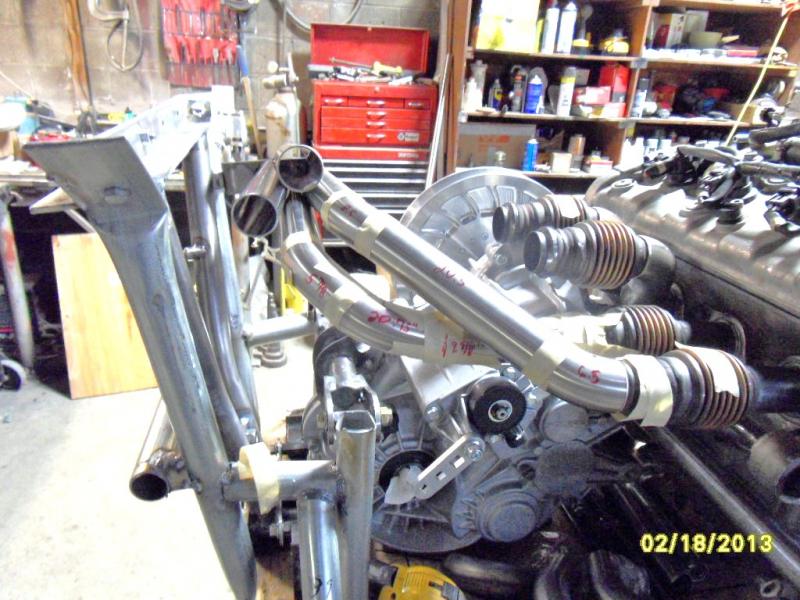

File comment: Start of the header, 4 each 1.5" stainless tubes on the notcher

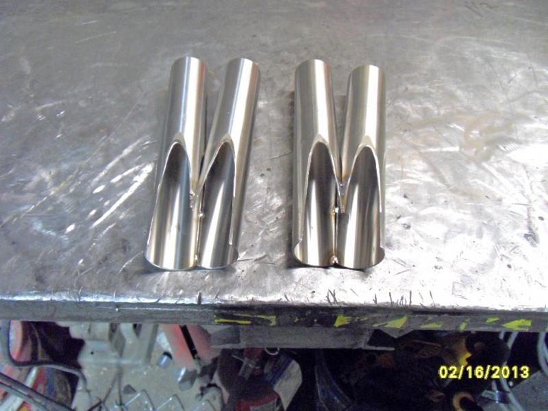

File comment: Each tube gets two cuts
File comment: 4 tubes to make up collector

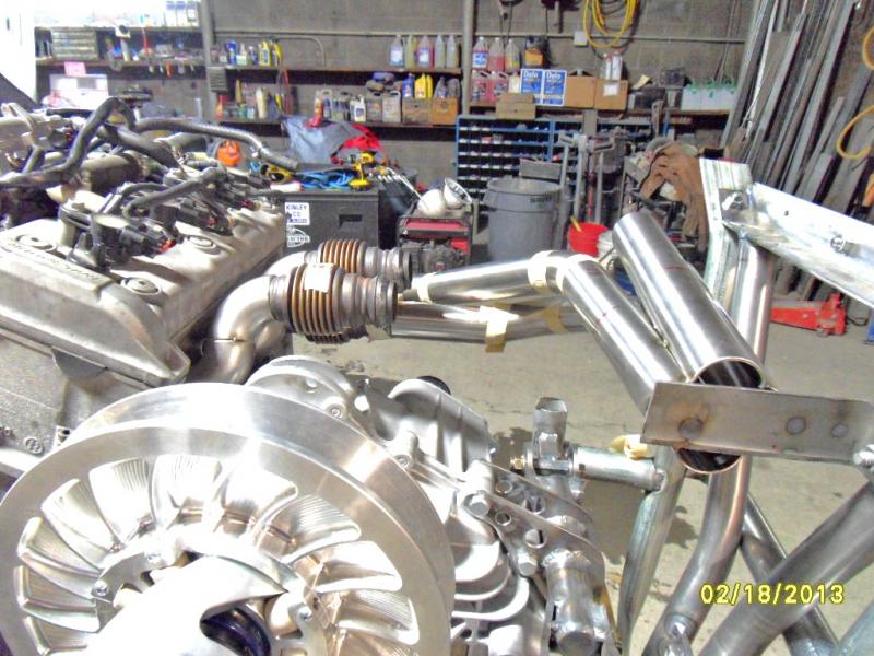

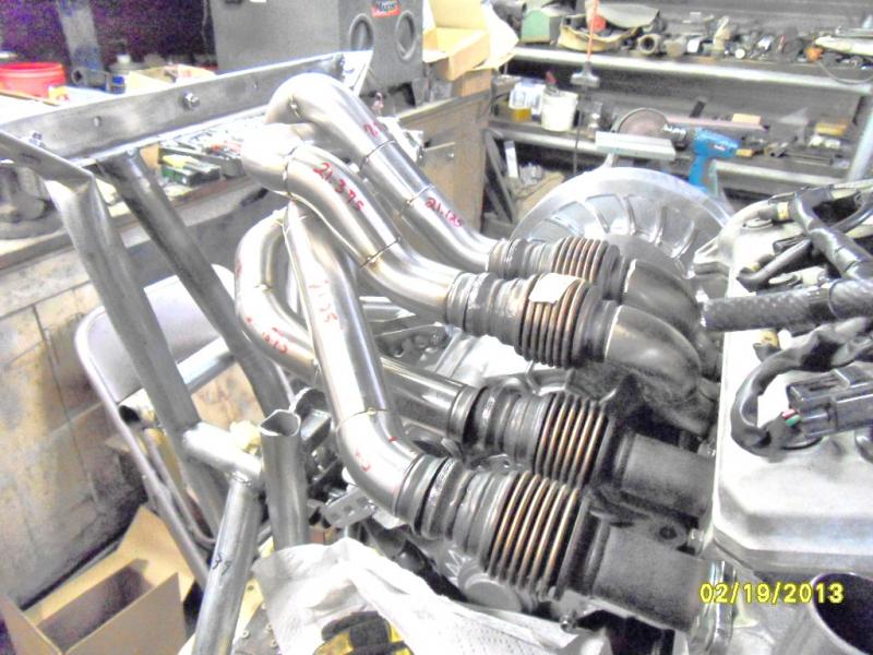

The exhaust has expansion/vibration joints but I also want the header to be rubber mounted that's why I'm looking for the Pilot Engine/trans mounts they work great.
Ak
File comment: Start with furthest away, made this tube the same length as the stock header. As you can see I used header donuts to move #1 & #2 cylinders up above the trans.
File comment: #3 cylinder, I'm using masking tape to hold together as I build.
File comment: Now the fun one.
File comment: Another shot of #1

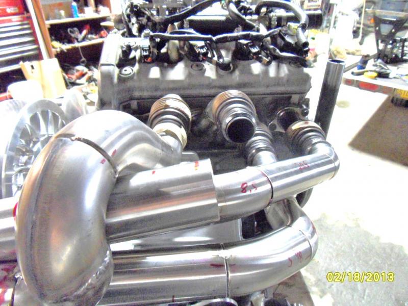

File comment: Finally #2 cylinder. The tubes are within 3/8" of each other which was tough enough for me! But so far this has been the best part of the build thus far, the hardest usually is.

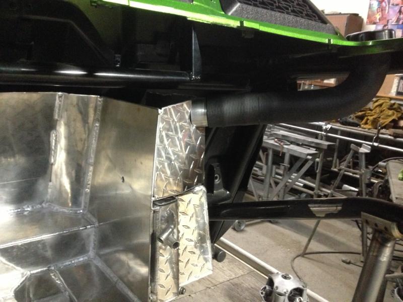

My NEMESIS the Gas/Oil tank combo.
File comment: Start of the Sump
File comment: OEM fuel pump in sump
File comment: The sump is large because the pump on the right side and the 4X4 shaft on the left side

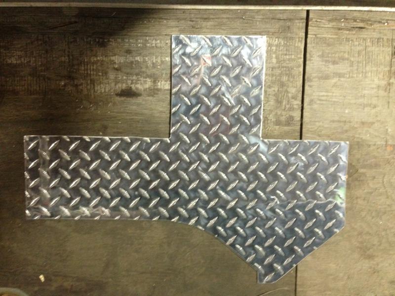

File comment: Main tank taking shape
File comment: Filling in the little voids to get as large of a tank as I could. When I started I was thinking I had plenty of room but it's going quick

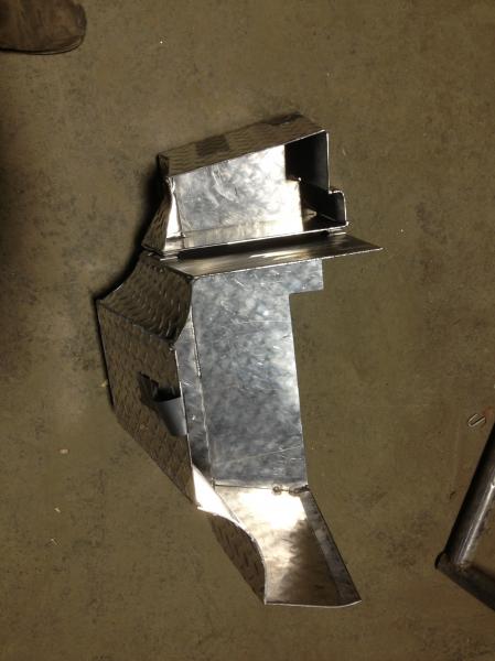

File comment: Basic upper tank, hugging the plastics as best I could. Oil resivior will be on the left.

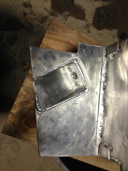

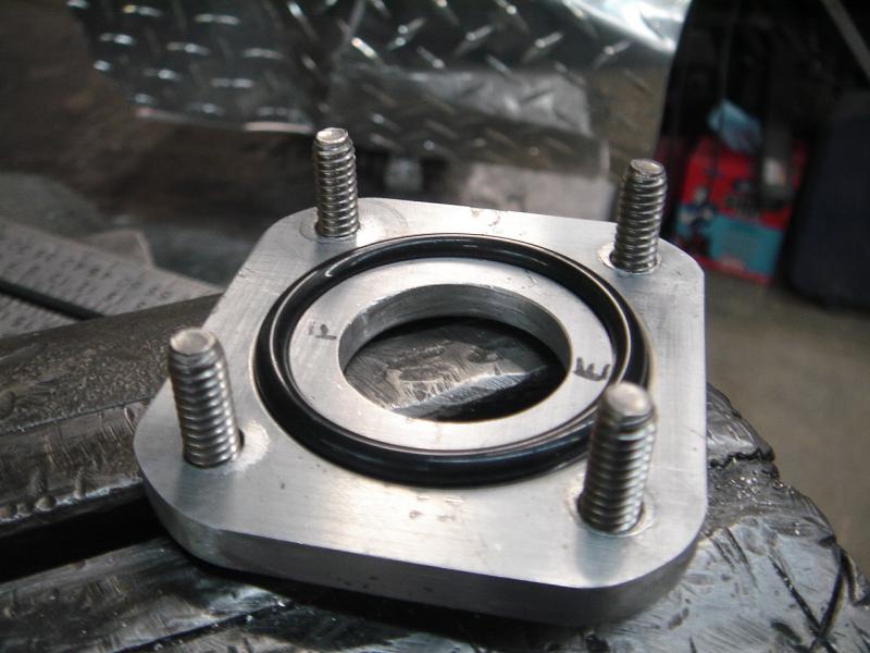

File comment: Fuel sending unit mount

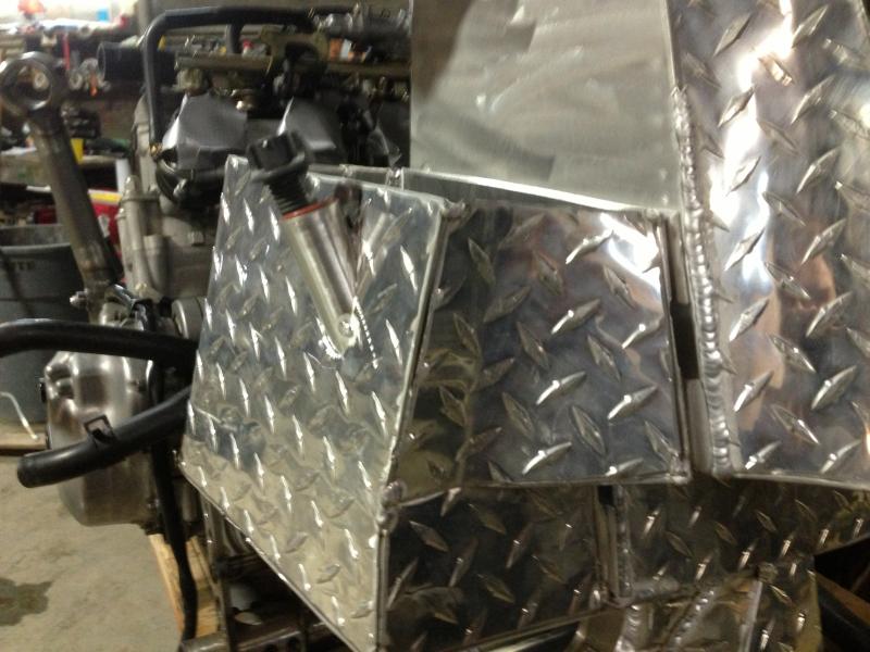

File comment: Oil tank taking shape

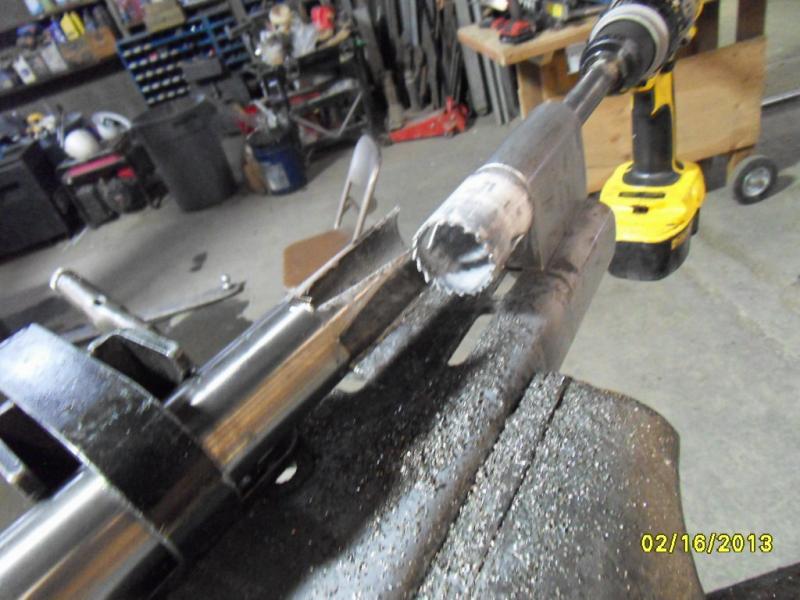

I do have a question though. Why would you use a holesaw and not a milling bit to cope pipes??
Milling bit would last longer wouldn't it?

Canadian Oddy - milling bit would be better, but I only burned up one hole saw bit making the header. I don't use the notcher much, with cromolly I just bandsaw/grind notch, it does however work great on Aluminum. Made a couple of roof cages for the boss' Argo's and it worked great, also the Wildcat bumpers.

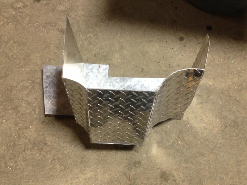

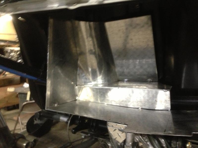

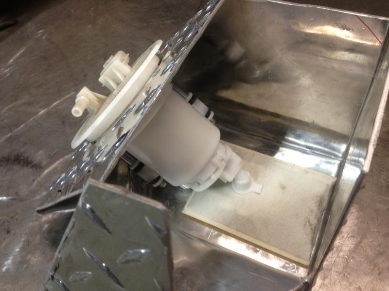

File comment: Setting up the fuel gauge. sending unit just misses baffle. I straightened out float wire and added all I could, would have liked to have float at bottom.
File comment: bottom sump is just a hair over 1 gallon. I'll have 3 gallons once gauge hits empty. Tank is 12 gallons

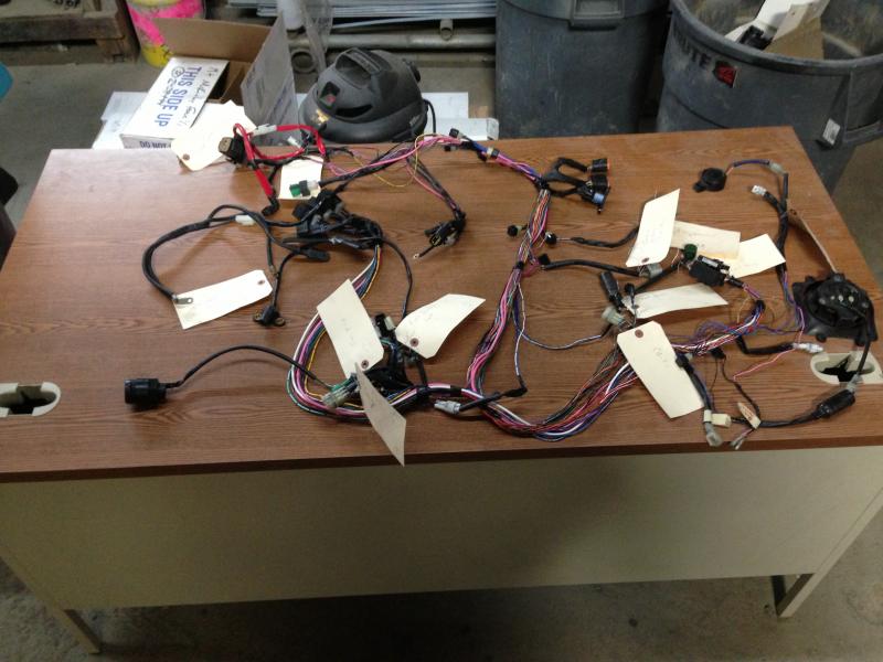

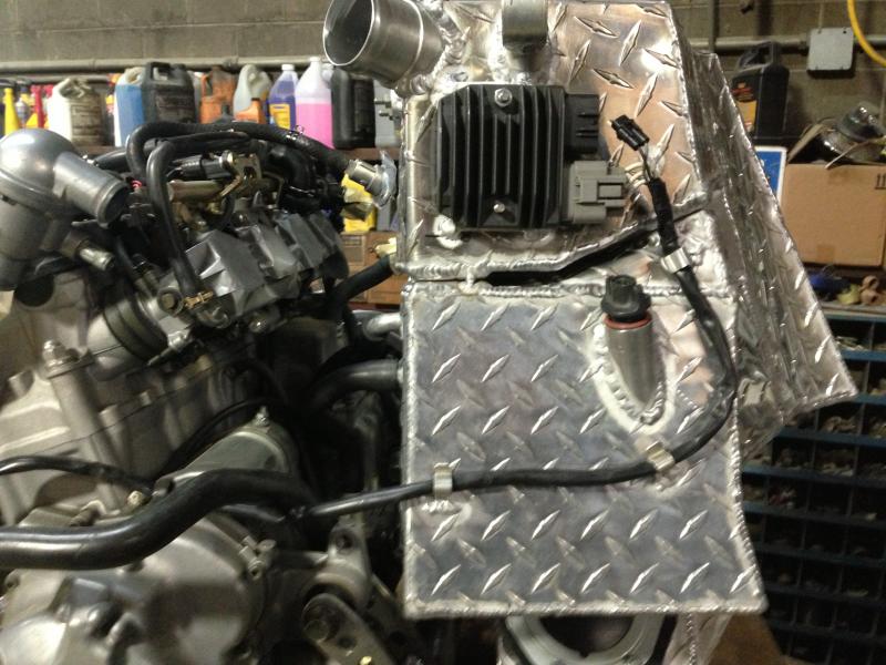

File comment: Start of wiring, stripped and ready to start cutting
File comment: Been around Pilots too long, mimiking the metal wiring tabs.
File comment: Mounting all the electrical on the tank. Yea the tank is mounted with Honda Engine mounts. Works great as they are mounted in single shear, that way subframe can move away.
