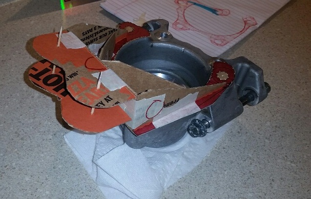

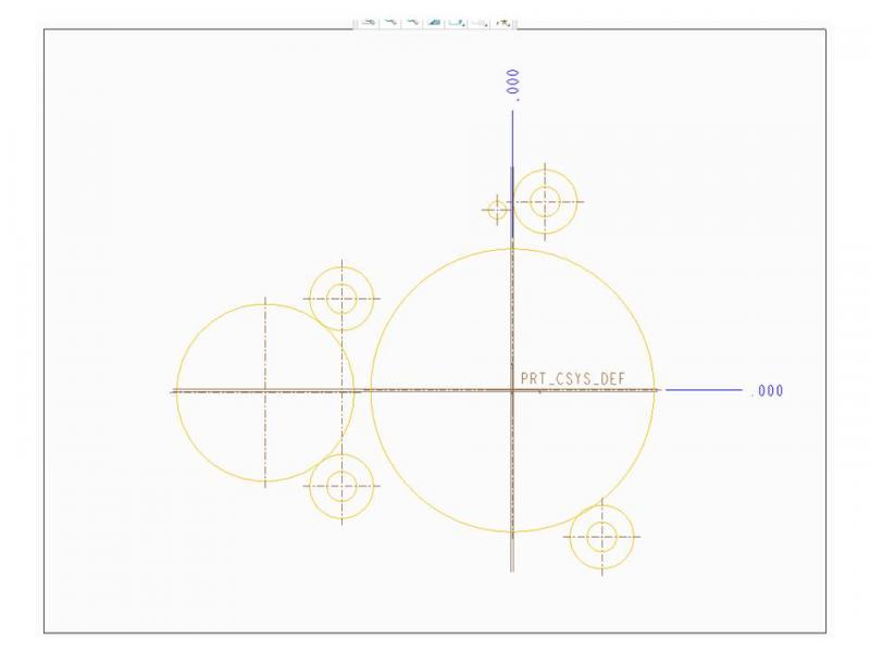

So I got to doing some research on the RZR XP 900/1000 rear carrier with the (2) control arm mounts. I actually bought a carrier with bolts of evilBay and have been playing with it.
- The RZR XP carrier bearing is smaller (44x72x33.1) than the carrier I've been experimenting with (40x74x40), which sucks because my existing experimental axle & hub won't work. I need to dig deeper into the differences between each set of axle/hub/bearing tio see if I can still use the machined inner CV cup.
- The RZR XP control arm bolts are 10mm, so rod ends cost a tad more, but still readily available. Wouldn't be too hard to make 10mm-to-5/8 sleeves though. Or could simply have control arms with 10mm outer bungs/ends and then 3/8" on the inner and 5/8" on the trailers.
- Since there are (2) control arm mounts on the XP carrier, I'd need to add a 3rd. Would likely be upper/forward, perhaps using the same centerline (and maybe same bolt) as the top mount. Could put the 3rd link in double shear with a tab on the bracket weldment.
- Last night I got bored (and creative) and made a cardboard rendering of the basic idea of a "5 link adapter bracket" for this carrier. See pics. I've already got revisions 2-3-4-&-5 in my brain. I want it to be a simple jigsaw puzzle of parts for a weld-able assembly.
- Triangulated the (4) bolt hole spacing/dimensions with the calipers and dumped it into CAD. Printed the bolt layout 1:1 and confirmed the spacing on the part. I've got the ideas spinning in the virtual world now. :-) If I had my cnc plasma table up & running, I'd have ideas tacked-together this weekend. But...I don't. =(
- Hell...someone could actually convert their RZR XP to 5-link with the same bracket!
File comment: Craft time!

File comment: centerline datums

Nope, about same. The XP carriers can be had for $40-$65 each (used). New XP standard axles sell as cheap as $65 each. So cost is about the same up to maybe 10% more since XP stuff is just a little newer.
The benefits to the XP-style carrier is that it's got (2) of the control arm mounts there & located, its a little bit smaller, and it has the (4) bolt holes on a nice flat plane for the bracket mount. No reason why the Sportsman style wouldn't work, but I think the XP-style would be an easier build.

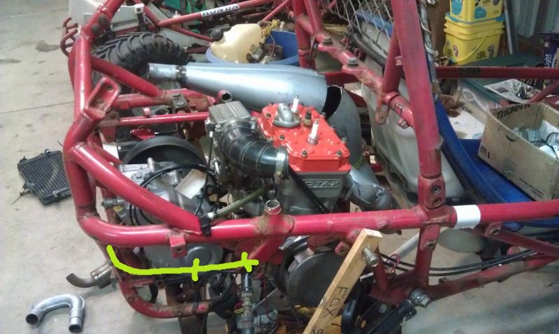

Took a gander at some of my frame pics (too lazy to go out in barn to look last night). In order to run a front/top control arm mount, there would definitely need to be some alterations/additions to the frame.
1. Battery box needs to be relocated.
2. Stock fuel tank gone (I'm using a fuel cell on my LT FL470 anyways)
3. The upper suspension links will be gone.
4. Cross-bar added to frame on both sides (see pic). The distance of the tranny output from the rear of the frame will require that same cross-bar addition anyways for the rear control arm mounts. Can't mount the control arms on the end of frame like on the RZR.
PostPosted: Mon Dec 14, 2015 10:38 am
Are you going to run outboard brakes?
If so, lose the stock disk, or at least the caliper and run the upper link tubes vertically.
You would have to do the two lower bars though.
Red lines are a tube, top to bottom. angled for camber gain.

Dang, I forgot about the brakes for a second there! :-)
Yes, outboard brakes. So ditch the disc and the caliper ( and could use the $'s for all the freakin' rod ends! lol)
And "hell ya" on the red down-tubes.
Thanks B!!

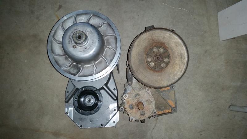

This project may have taken a change of direction. Decided to buy myself a present to celebrate Black History Month, Presidents Day, or maybe something to take the "sting" out of selling 2 buggies...
Granted the suspension challenges & design are still in play.
