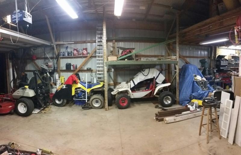

Organizing the shop to make more room for storage so I can empty out the shop room and finish insulation. Picked up a couple of 12' H x 8' W x 4' Dp pallet racks with shelves. Buggy fits perfectly underneath. Will have all my buggy parts stored on the shelf on smaller steel shelves with standing room. Wish I had a forklift!
Also got a lot done inside the house this summer, so along with a heated shop, I'm anticipating a lot more progress on some fun-projects soon. :-)
Burned a good bit of R&R time wrenching on the 72" Exmark mower (left). Paid $3400 (cost $11k new) knowing it needed a little TLC. $200 of parts, a DIY valve job, a little paint touch-up...the thing runs excellent and cut my mow time IN HALF. I've got a used Trac-Vac for it which will be consuming this weeks' R&R time just in time for the fall leaf / thatch suckery.
