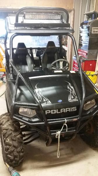

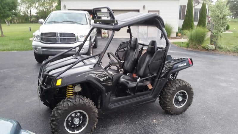

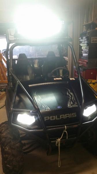

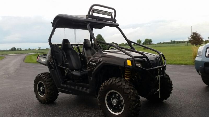

Took this rig on its me-maiden voyage today! Hauls balls!!! Front shocks are cozy over all the bumps, too.
So happy to have the pile of parts gone and having this thing in good shape. Not a trailer queen by any means, but good enough for me! Just around $4600 total investment and plenty of my own labor.
Got all the bugs and concerns worked out. Also ditched the battery-sucking halogens and replaced with a 22" curved LED light. Still need ro reinstall the windshield, would like to paint the bumpers, and need to check connections on the winch. And might put a rear cage section over the ned similar to the "S". More to come in the coming weeks.
Loving it! :-)

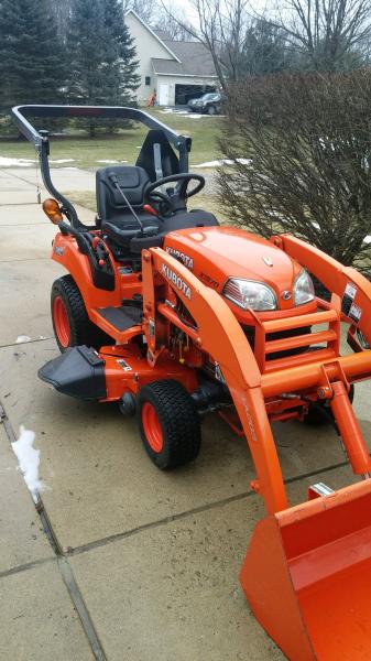

Uh-oh...looks like my RZR will get traded for a 2014 Kubota BX loader tractor this weekend. Means my $2.5k Exmark mower to $4k RZR deal is morphing into a $9k tractor! :-) I like this direction!!!!
I loooooove the RZR, but I actually "need" a tractor and have many uses for a loader, 3pt and PTO. And if I need to sell the tractor not only do the tractors hold their value like crazy but the compact tractor demand is prob 10-to-1 at least here in NW Ohio. Selling my Craftsman mower + blower and my Kubota rototiller.
Still got the FL350, the Rotax conversion in progress FL470, and the '88 LT500R Zilla.
(Seller's pics, aka that's not my 'Vette) plus you wouldn't catch me DEAD living in a subdivision
