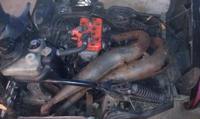

PostPosted: Sat Feb 16, 2013 4:43 pm

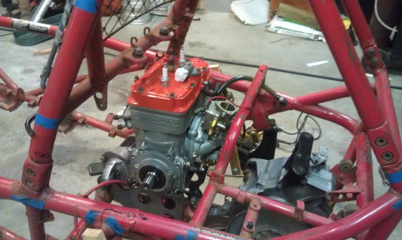

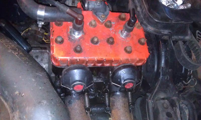

Picked up a future upgrade Engine this morning. '91 SkiDoo Mach 1, 617 RAVE, twin cyl, Decker pipes, runs but I think has an air leak on mag side cylinder. Paid $100. lol
Now, onto hacking my buggy chassis...
File comment: $100...not bad for a running 617 Rotax sled

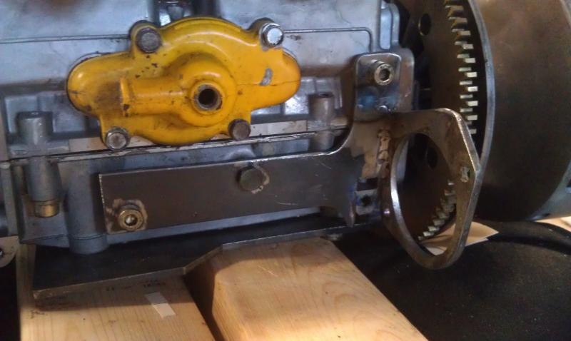

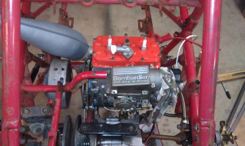

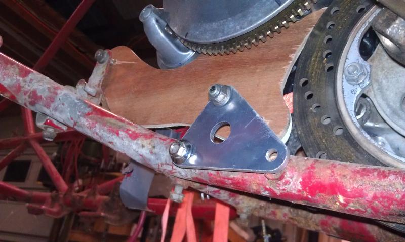

PostPosted: Sun Feb 17, 2013 9:07 am
Saturday's progress...
File comment: Top mount tab added
File comment: Piece of angle and part of the old mount
File comment: Voila!
File comment: This Engine config sits pretty high w/ the Farr cradle
File comment: Seems like a lot of real estate under there

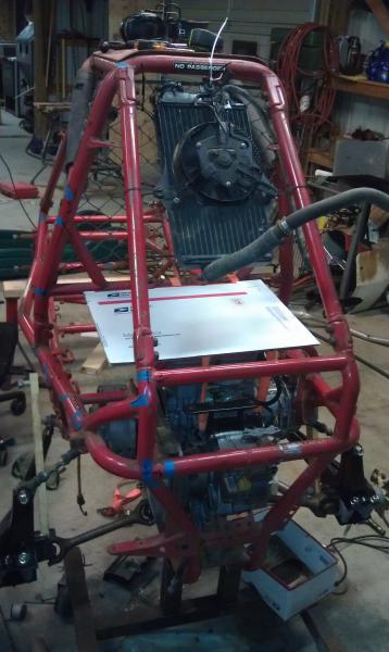

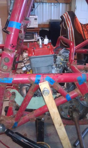

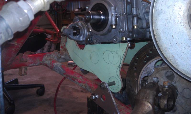

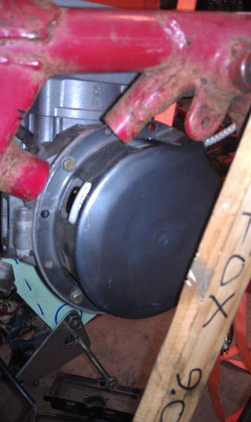

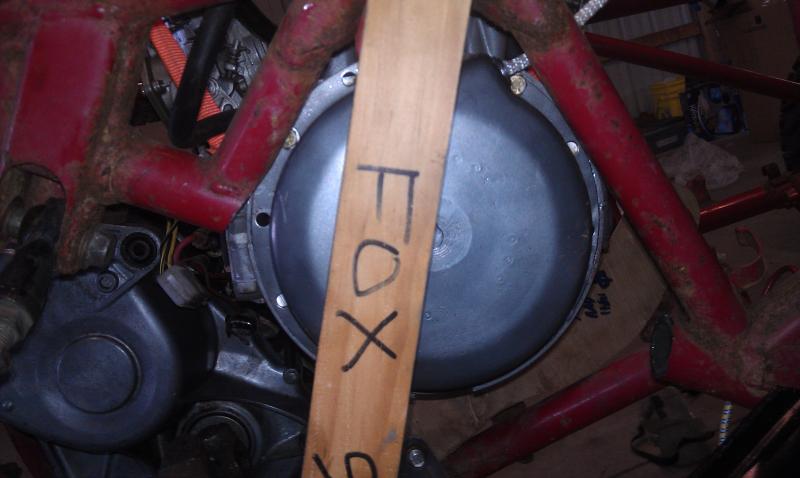

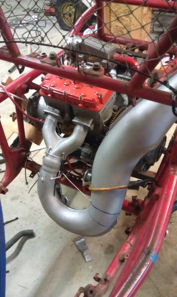

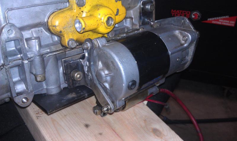

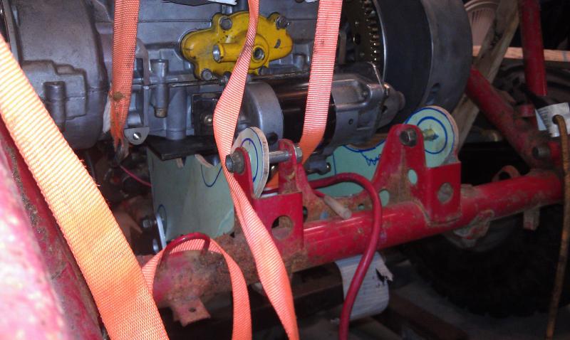

Spent some more time in the cold barn this morning working on the buggy.
Made up some cardstock templates for modified mounts, and cut them out on 3/16" luan. They lower the Engine 2.25" and move it back ~2" from where the original mount put my Engine. I may be able to move it backwards another 3/4" though (exhaust will need all the room it can get). And with the help of the ratchet straps, I got the Engine sitting where I want it. Only had to cut the middle section of the mag-side cage tubing to make room for the recoil starter. Never knew that stuff was double-walled, either! Giant TRA clutch is lined up with the driven clutch, and has enough clearance for removal while its in the Engine. There's enough room to get a belt on/off. Belt in the pics is too long. I'll need to find a couple shorter belt sizes in the same width to find the 'right' size.
Was hoping I wouldn't have to cut the cross-bar (for the FL air box and fuel-tank), but it will have to go. Need room for the air filter intake. I'm going to make a replacement cross-bar that's routed where I need it. I want to retain that stiffness in the rear of the chassis.
I'll either modify the Farr side-plates, or I need to go get a couple pieces of plate to make new ones.
Then I got crazy and started temporarily mounting parts with zip-ties to get an idea of where everything will go. Threw on the oil tank, radiator, overflow tank, and even threw the sled pipe on there to approximate the desired location of the pipe. Everything fits nice and there should be plenty of room for the fuel tank and air filter.
May head back out and tweak the side-plate prototypes and do more thinking...

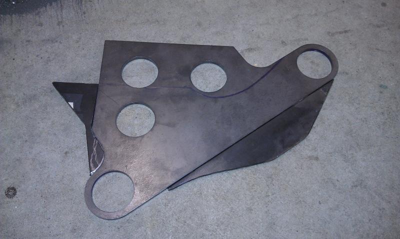

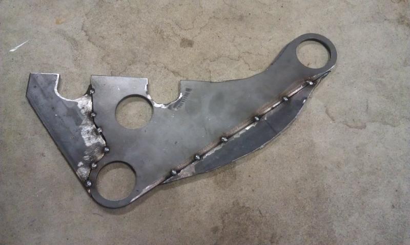

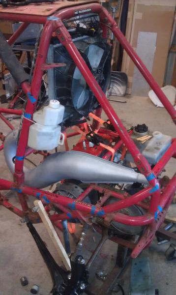

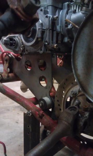

PostPosted: Tue Feb 19, 2013 10:02 am
47'F last night pushed shop-time to the top of the priority list.
Made some adjustments to the first Engine mount side plate re-do, and I've got her where I want her now. I could move it back even more (like 1.25"), but the oil pump is in the way and hits the right Engine/trans mount on the trans. And I think I'll be into the no-mans-land for belt selection if I go closer. So next step is to get the original plates modified.
Then I once again realized how big the new fuel tank is going to be (need to do more studying before buying, duh). It's big, but I want it to be big. I cut out a rectangle for the LxW. Then decided that Honda Civic radiator was too huge for this buggy. I threw on a Quadzilla radiator and a fan I had in my parts pile. I think I like it on the down-tubes at an angle. I know, it needs to be flipped so the plumbing points down (I got excited with the zip-ties). With this radiator and location, the fuel tank should fit along with the oil bottle, pipe, airbox, battery, and coolant overflow bottle all within the confines of the stock cage.
As for airbox, I saw what Odyknuck uses on his FL700 and I think that's a RZR/Rhino/Ranger air canister (takes a FRAM CA9248). I've got a line on a Kawasaki Mule filter canister that's a little smaller, and UNI makes a foam filter for it. Canister has an intake tube which would be routed to a pre-filter. Mule canister is for a 620cc Engine, too, so should be adequate for the 470 Engine. Hoping to located the air filter box above the recoil since I've got space over there.
I kinda' understand now why Farr build a "wall" around the recoil in his build -- not just for strength, but also because that recoil housing is designed to be under the hood of a sled, not next to a buggy tire! lol It has 'windows' around it and would allow water/mud/etc not only into the recoil, but to the flywheel and stator. I'll prob weld a strip of sheet around the OD of the recoil to close it in, plus make a gasket for where the recoil flange bolts to the block. And where there are drain/sight holes in the block, I'm going to put a vent tube or rubber plug.
Fuel tank and box-type flame-arrestor should arrive today. Stupid Presidents' Day delayed me. :shock:
Lastly, a MBN member sent me some pics of their ST3 buggy front spindles/hubs/heims...I might buy them. They're heavier-duty'er than any quad spindles/hubs I have. Just needs brake disks, calipers, and caliper stays. if cheap, will buy for my LT front end.
File comment: Second iteration prototype...
File comment: LT500R radiator...
File comment: Scroll up to the 2/17 pics and you'll see how much further back I pushed this recoil (cage hacking included). Also...notice the windows on the recoil.

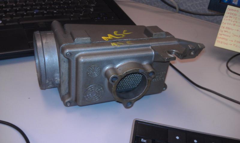

PostPosted: Fri Feb 22, 2013 10:34 am
Did some research on the air filter housing I got as well as the FRAM CAK530 air filter it takes. At first I freaked out thinking the 3.25" OD x 7" long air filter was going to be waaaay too small, and freaked some more after I read that Donaldson rated this filter at only 33 CFM (?!?!?).
But then, I remembered I was a filter engineer by trade and laid down some Filtration 101 math. ;)
CAK530 has 3.3 ft2 of media.
Use the ol' SAE J726 air flow formula and derive that the 467cc two-stroke Engine at say max 8k rpms will flow...92 CFM of air.
Face velocity (air flow per area of filter media) = 92 / 3.3 ==> 27.9 ft/min
That's actually pretty good! You want a lower FV for lower restriction, media durability, and long filter life (aka dust capacity).
Let's compare that the two most popular air filters in the USA: the CA8039 (Ford) and CA8755A (GM).

PostPosted: Sat Feb 23, 2013 7:02 pm
Back to the Engine mounts...
Got the Farr mounts altered to where/how I wanted the Engine to sit. Again, nothing wrong with the Farr mount, just that I wanted to squeeze as much space as possible out of this Engine bay and with my downdraft carb setup. In the 1st pic you can see the before and after size comparison.
Got the alterations cut-out and welded. Only got pics of the tack-welded mounts, but the merged parts are fully welded and ground down, plus a coat of primer so they won't rust. Ran out of wire, so can't weld anything else tonight.
Put the Engine in and it is about ready for tacking the base plate in place. But wanted to add some of the other peripherals before I started welding. Bolted on the intake box, stock seat, and the y-pipe. Then started messing around with the skidoo pipe.
I'm very confident I will be able to make a few alterations to the pipe and y-pipe to make it fit behind the seat even with it slid all the way back (I'm 6'1'', all legs, and need the room). Right now, the y-pipe and 1st turn of the pipe fit in the space allowed, but its too close. And the "U" turn hangs about 2" below the frame. Planning to take 1" out of the y-pipe at the mount and adding about 6-10 deg angle. And the female end of the main pipe, I can cut it back about 1" as well. Then right after the 1st big "U", the pipe will get cut and turned. Lastly, I'll probably have to cut the back half of the main pipe and put a small wedge in to get it to point downward more in the right direction. No major changes in the tune of the pipe, really. Pipe mounts and spring hoops will get welded in last. BUT...no modifying exhuast plumbing until I have the mount plates, base plate, and 4 mount-tubes at least tacked in the right place. Still waiting on the 4th mount tube to arrive.
File comment: My patterns over the original plates
File comment: Parts cut, and plate ready for trim
File comment: Ready for tack
File comment: Other side tacked
