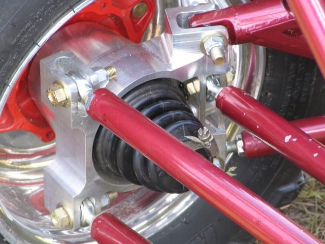

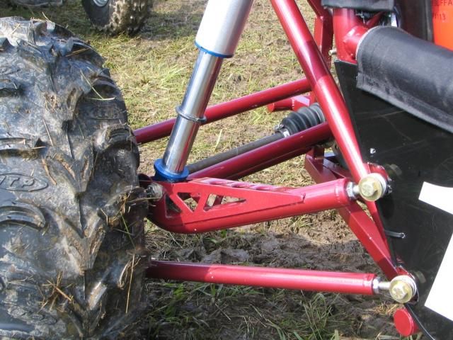

The carrier I posted pics of is from a Briggs built gen 4. Big bucks in those bearings, not worth it for a play car. IMO anyway.
The aluminum Polaris carrier is basically the same as the blue built up version you posted pics of, but already made and cheap!
I think the shock on the trailing arm has been proven to work. The Briggs trailing arms are crazy thin sheet metal! Plus it looks cool! :-)
D- check out the tabs for the trailing links on the blue thing Lee posted...pretty thin! LOL!

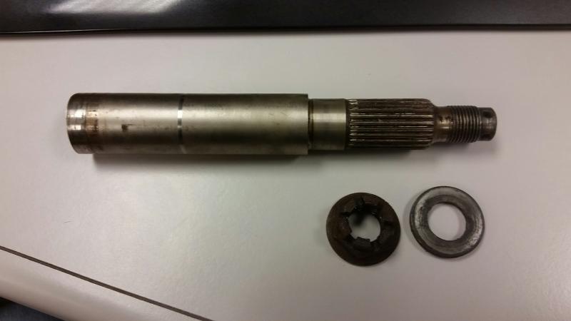

PostPosted: Fri Feb 20, 2015 2:49 pm

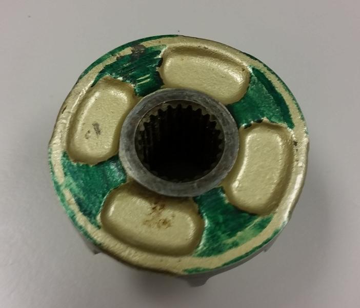

The stock FL350 hub is finally in the vice and chips are flying. :-) Ended up going with the mill (vs. lathe) simply b/c it would've been too difficult to true it up in the lathe chuck. The factory hubs are not exactly perfect geometry, and there isn't enough material to bite on the machined/inner side of the hub. By using a 3-jaw vice on the mill, you can level the part, find the center, and run the end mill around. The material is pretty tough stuff and the feed is slow. Just cutting the "ears" off now. It will get faced later, but I may need to utilize a spare output shaft simply to get it setup for a nice true turn.
Supposed to be 32'F tomorrow (heat-wave!), so I may actually get the stock Polaris axle inner CV cup off the axle, degreased, and then turn the spline stub off. We'll see. May actually chuck the cup on the stub, true up the OD of the cup with a couple light passes, hack the stub off, and then face the end where the stub once was. Concentricity is really effing important on a drive-line component. Last thing I want to do is turn the transmission bearings into confetti.

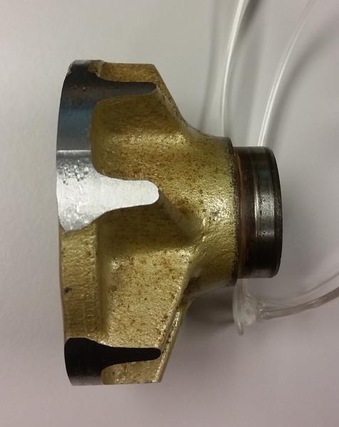

Sorry, no big updates or developments. Only thing I got accomplished was to chop off a broken yoke off a stock FL350 outer shaft so I could use it as a mount for lathe turning.
I did make some more headway on finishing off my shop, though. Also realized...I need a bigger lathe. I may actually have to to trim my buggy count down by 1-2 simply to get some real machines in the shop. This bench-top stuff sucks, and, my ability/freedom to use the work tools both very limited and spontaneous.
Late edit: PICS ADDED...
Notice the pock-marks in the material on that side shot. Not sure if this is from the forging operation or from chips gouging the surface during cutting (?). All 4 of the machined sides have this crater-like appearance. Still need to turn the OD. The cv cup will have a recess in which the hub will fit to help alignment.

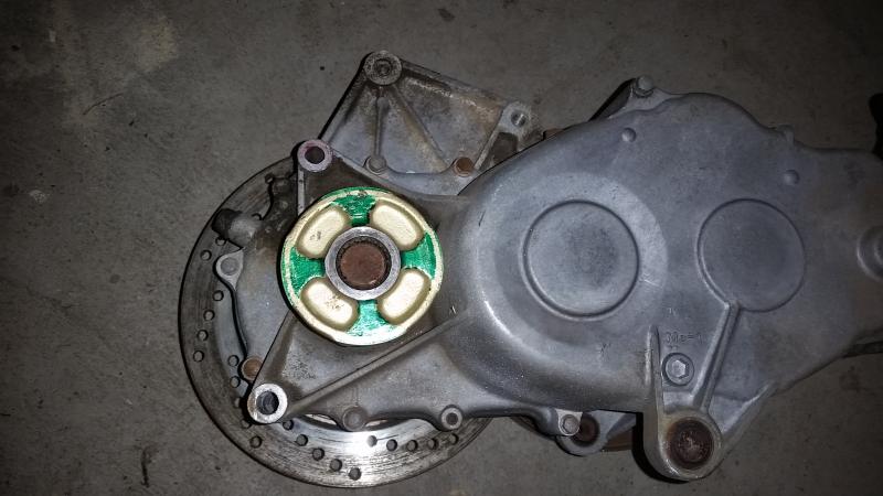

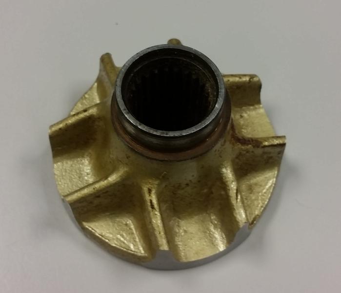

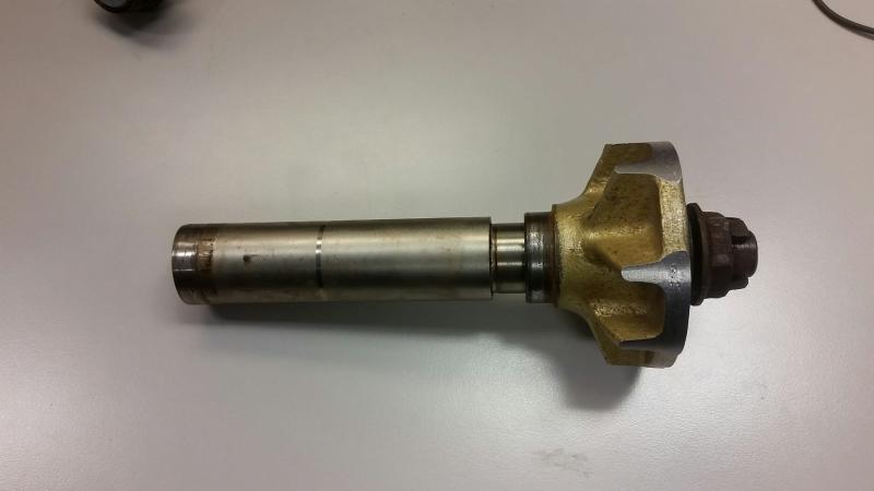

To keep the adapter on the output shaft, I was thinking about using a pair of round-tip set screws loctite'd in place, 180-deg apart. Would thread in towards the output shaft groove.
Also, here is the chunk-o-stub that I want to use for lathe-mount and for alignment when the cv cup and adapter get welded.

PostPosted: Mon Feb 23, 2015 2:41 pm
Looks good.
How far out is this setup going to stick out?
Inner CV looks pretty long already?
How much of your "new" part is splined? All the way through?
PostPosted: Mon Feb 23, 2015 3:21 pm
The adapter hub should sit about even with the stock output shaft end...maybe like 1mm gap. Then tack on about 2.75"-3.00" of inner CV cup. The adapter is splined 1.5" of its 1.875" length. Only part that isn't splined is the little machined part (inner side of hub) that once slipped inside the stock carrier. [Added later]...if you look at the inner yoke of the stock FL350 axle, I bet there isn't more than 1" of spline! I was surprised.
Like I mentioned earlier, you lose a little of the width game at the adapter, but you gain a little bit with the Polaris outer and its favorable wheel offset over that of the FL350. Ain't no doubt about it ---> the rear is going to be wider than stock.
I was watching some RZR videos over the weekend and was amazed at how easy those things are to tip over. They tried too hard to make them "trail skinny".
Will get the greasy CV cup off the axle tonight, cleaned up, and then bring it in. Would be really nice to get the adapter and cup machined and done this week. Its only like 20-effing-min of lathe work.
I also need to do one final measurement of the adapter OD + where the cv cup will sit, and make sure they won't interfere with the recoil-side of the trans box.

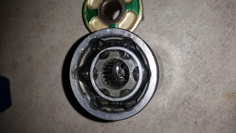

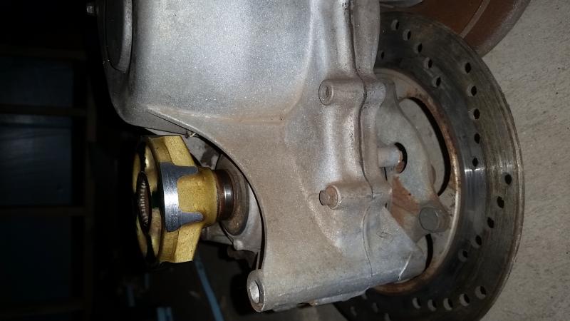

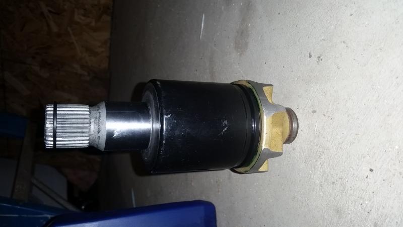

PostPosted: Mon Feb 23, 2015 9:04 pm
Phew!! The adapter clears the recoil side of the trans box, no problem. The adapter is 3"OD. And since the inner cv cup is 2.63" OD, everything clears. I do want to trim those gussets back on the backside of the adapter. The trans box tapers and leaves only 3/16" clearance at the point of those gussets. It won't hurt rounding the points down.
Eyeballing the inner cv hinge point, it's about 4.5-5" from the center of the trans. The lower cage (under trans) is 7.5" wide. Which means there is room for tabs for the links. Only way it makes sense is with upper and lower links on the rear, and just lower on the front (aka: how i modeled the latter link setup). All of it passes my preliminary feasibility sniff test. :-)
The adapter will get a recess machined to fit the OD of the cup. I cannot take any length off the cup since the depth of the plunge void is too deep and I'd weaken the cup severely by removing material.

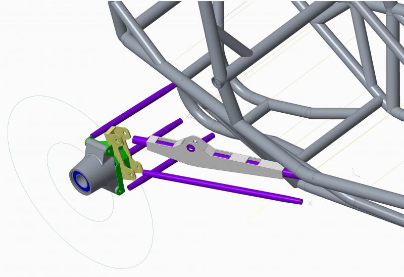

Some weekend fun with CAD...a little blurry since its a collage of jpegs saved as a jpeg.
24deg droop and 5deg bump shown and equates to ~9" travel. 10deg of bump would get me over the 10" mark.
22" tires depicted.
Given the limits of the CAD program, I can't model the carrier motion on the arc made by the front links (where carrier pushes rearward slightly), so I have to adjust the datum point spacing on the front links to keep the program from crashing. Too complicated to make it 100% real live motion.
Chassis model is prob 95% accurate, so you may see something silly here and there.
That front lower link mount...yep, its kinda floating around but it was ambiguous at this point.
Really just did this to get an eyeball on the angles the front links make, where the upper shock mount would be, etc, etc, etc.

Great job on the model!
I like your new bracket.
"The mounts will be spaced the same vertically and horizontally as they are on the carrier, which is dead-nuts in line with each other. "
Soo, the upper and lower pivots are inline with the CV rotation center? That's cool and makes it much easier.

Looking at the models/pics above...that shock mount needs to move rearward, or else atop the carrier. More shock travel = more $'s. Will likely also have to weld the down-tubes in place (no bolts) once the shock hoops are added.

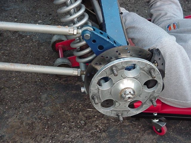

More examples I found over the weekend (all "full size" buggies)...
File comment: The knuckle & bracket idea I have is essentially this same very pricey machined version. Unless they machined this themselves, that's def not "$35 knuckle + $20 of steel" CHEAP!
