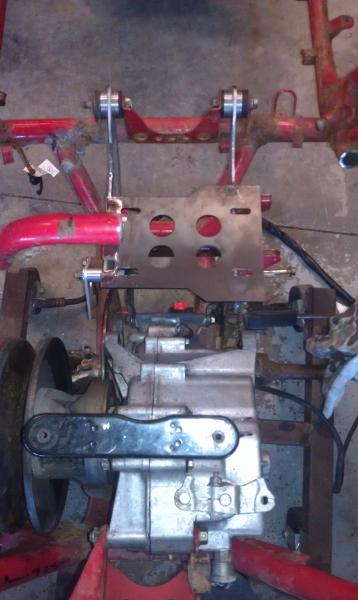

Got the Engine mount completely tacked together except for the steel bushings. I need to notch out about .125" x 2" bit of the base plate in order to give the starter solenoid some clearance so i can remove/install the Engine and leave the whole mount bolted in. Pics later this evening. Using the Farr kit as a base was definitely a good idea. It was "farr" easier to modify their plates than to spec and fab from scratch. Once I have that 4th bushing and get the Engine mounted to the base plate, I can slide the Engine/mount to align the clutches and then tack the bushings. Plus I ran out of solid core wire and had to switch the welder over to flux-core. God, I forgot how messy that sh!t is!

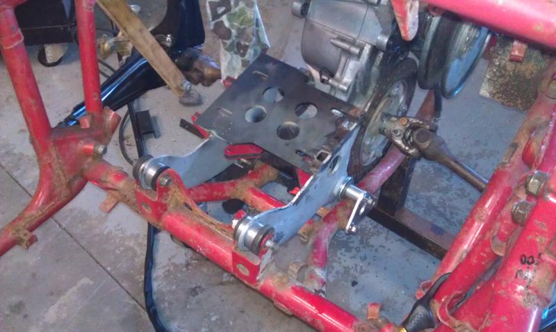

Here's the mount. I've since tacked in the vertical center support and the big horizontal support from the Farr kit.
Picked up a big spool of .030 solid wire for the welder this morning, too. I hate flux-core!

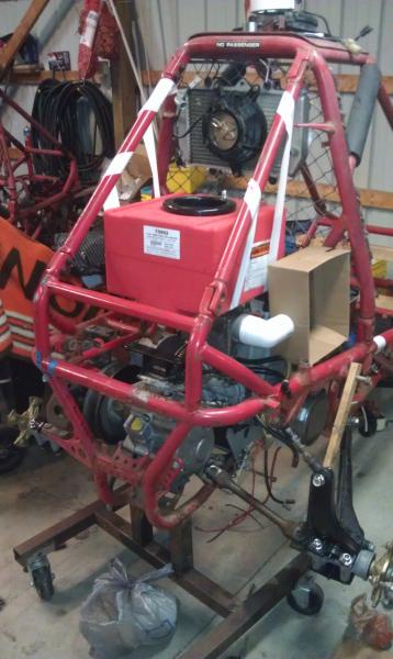

PostPosted: Tue Mar 05, 2013 10:46 am

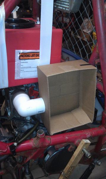

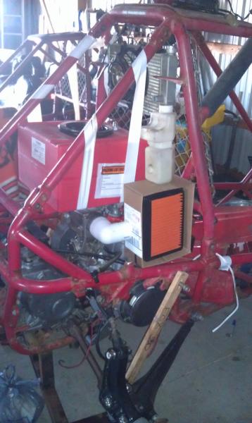

Well, another twist 'n turn. I don't like how the radial seal air filter and housings are fitting / looking. So, my next idea is to put a panel filter on the side, upright, and in a housing similar to the HxW of the stock airbox, but made for a panel filter. Housing would have a lid that's got a screen-covered scoop on the side to keep the water/mud out, and plumbed with a 2" 90-deg elbow right to the arrestor intake. So it can ingest some clean cool air away from the radiator and exhaust. It allows me to use that particular available space on that side of the Engine & fuel tank, too. Will try to find something in plastic that already exists, otherwise it will be another fiberglass undertaking.
Got the missing 4th Engine mount bushing from Farr yesterday. =) So I will be able to weld up the Engine mount completely this weekend. Which means I can also get hacking at the pipe.

File comment: This was the PVC plan...which I veto'd.

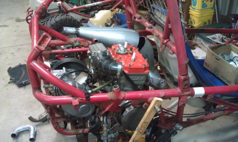

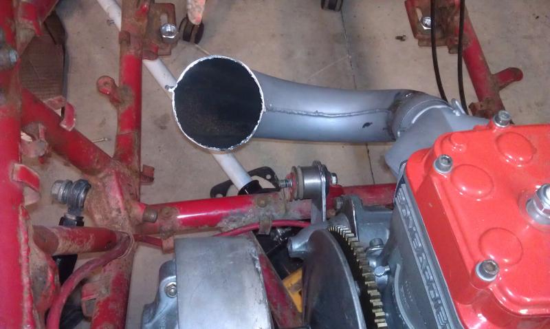

PostPosted: Sun Mar 17, 2013 10:22 pm
A little more progress.

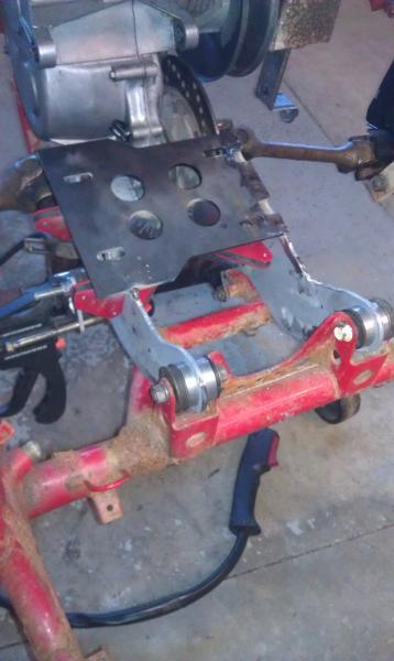

Got the Engine mount plates welded up. The mount bushings are just tacked for now. Got sick of pulling the Engine out, so will finish welding the bushings in the future.

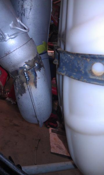

After walking around the chassis for 60-min with a sharpie and some masking tape, I finally started modifying the sled pipe to fit the Oddy chassis. It was only (4) cuts:
Cut #1: Took about 1" off at the pipe flange end. Also added about 5-10'deg of angle to slant the elbow towards the Engine (rear) more. Cleaned the flange up on the lathe and then tacked her in place. Was nice to nail the welder settings on the first try for once!
Cut #2: Needed to turn the pipe after the elbow, so I used masking tape to layout the right cut (took several tries until I was happy with the line). Took my time and cut it nice and neat. WIll be easy to seam this back up.
Cut #3: Right in the middle of the last turn (before the end cone begins), I made a cut that was about 330-deg around. Then bent the tail end on the bench to where I liked it (iterative process). Will use paper/cardboard to layout a wedge and seam it up. Got some heavy sheet that's the same thickness as the pipe. This OEM pipe is nice 'n thick which is a major plus.
Cut #4: The tail end had a thick tube on it for the muffler mount. It was pointed slightly out towards the outside of the buggy. I removed a wedge about 5-8 degrees so that it pointed straight back. Also cleaned the end piece on the lathe before welding.
All in all, the pipe modification is going A LOT smoother than I thought. Took my sweet-ass time, too, which helps. It should fit very nicely inside the chassis. Moving the Engine back and down also helped with the seat-to-pipe gap, too. I've got clearance for days on the pipe! No major changes or hard angles, so the pipe should flow great.
Busy week at work, so not sure when if I'll get in the shop during the week. But having this pipe done is the last major hurdle to this Engine swap.
So far, my favorite part of this build is the very, very, very small pile of parts I had to hack off the chassis and pipe. :-)

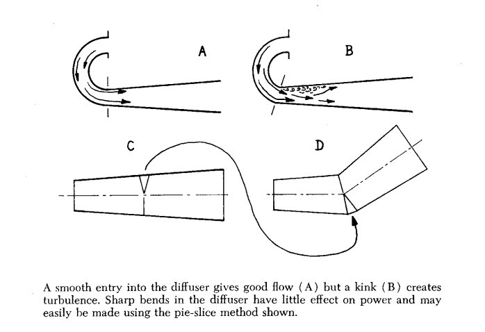

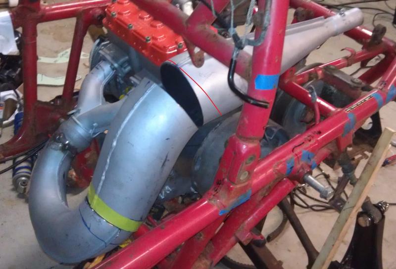

PostPosted: Sun Mar 17, 2013 10:46 pm
Lookin good!
When you section the fat part of the pipe,cut a pie shape piece out then rotate it(the pie piece) around and weld it back in. It should look just like the gap you have in your pipe now,but you don't have to try to find/make a piece to fit.

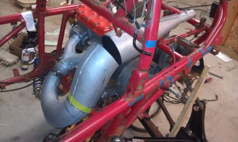

PostPosted: Mon Mar 18, 2013 9:18 am
bullnerd wrote:
Lookin good!
Not sure I follow you. Please explain. Might be b/c its a Monday, too. <yawn> lol
I was originally planning on taping a piece of paper over the opening, transferring the shape with a piece of art charcoal, transferring to heavy sheet, and then using the body air-saw to cut out my shape. Will bend/form it to close proximity, tack one end in place and then bend/form the other end to where I can tack it. Then will make a zillion tack-welds to seal it up, and then grind it all smooth. If needed, I may make a "seam" strip to cover the original seams.
Also...a secret to my seat clearance besides moving the Engine back/down.......I've got a couple of 5/8" thick hex nuts sitting between the seat bottom mount and the frame mount, but only on the rear mounts. This tips the seatback forward and creates a ton of space while maintaining my leg-room. I'll make a steel spacer for the final mount. And as-shown in the pics, the seat is 100% as far back as the stock mounts will allow.
Lastly, the bottom of the pipe is level with the frame, but if I were to catch a stump or something...goodbye pipe. So I'm going to bend a crossbar that will span the width of the frame and protect the pipe.
PostPosted: Mon Mar 18, 2013 9:30 am
Look at your second pic, the shape of the gap that is missing is what the "section" piece should look like. But with the "fat" part on the bottom. Then spin it 180deg. and weld it back together.
I'll see if I can find a pic.
PostPosted: Mon Mar 18, 2013 10:41 am
Maybe I take a compass or something and follow the 1st (lower) edge and trace the cut-line on the other half. Then cut that wedge out so that I wouldn't need to cut/weld a piece...just weld the two matched halves together. Is that what you mean?
PostPosted: Mon Mar 18, 2013 10:50 am
Like this?
I don't think the diameters will match up this way since the lower cut is perpendicular to the pipe, and the pie-cut will be at a slant (aka: elliptical shape).

PostPosted: Mon Mar 18, 2013 12:24 pm
Hoser got the pic I was looking for.
