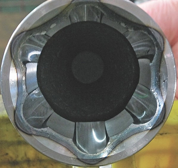

D$, from my experience, the CV cup is made from a micro alloy steel then induction hardened.
See the attached image, the heat affected zone (burned looking area) is the induction hardened area.
If your parts are made this way you should be able to understand what area is hard.
When the saw blade hits the hardened area it will let you know ;-)

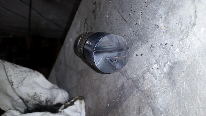

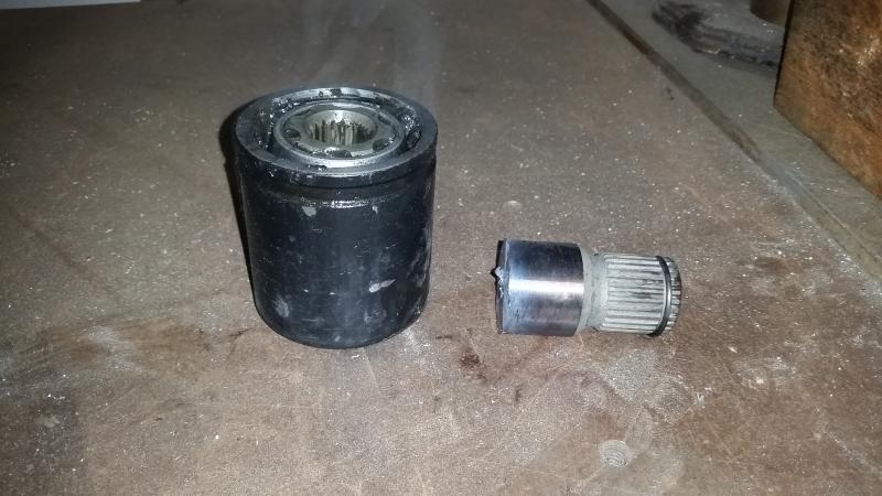

The 15A chop saw grunted through the stub. This sh** is hard, no doubt t about it. Had to index the workpiece around so as not to try to cut too thick of a x-section. Nice that the room the saw is in is a certified hot work room with exhaust fans. 22min to cut it off though!
While that part is cooling off, I'll go play with the adapter.

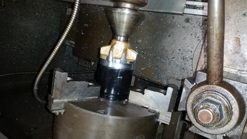

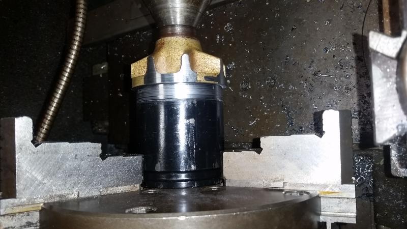

Not artistry, but it's true and ready to be tacked. :-)
